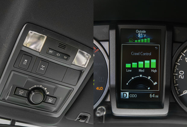

    The off road has crawl control, mts, ect

    In what way is ATRAC a "safety technology"? Are you perhaps confusing it with TRAC and/or VSC? ATRAC is a different way of improving on the limitations of an open diff. It's disadvantage is that it is reactive. You must have uneven wheel spin before it engages. It's advantages are that it does not mess with steering it is less likely to cause damage to the drivetrain.

    1) ATRAC/MTS only comes on ORs and Pros. Sports don't have it.
    2) ATRAC is only available in 4lo.
    https://www.tacomaworld.com/threads/3rd-gen-traction-control-modes-explained.530695/
