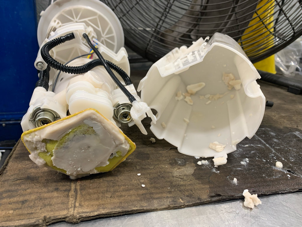

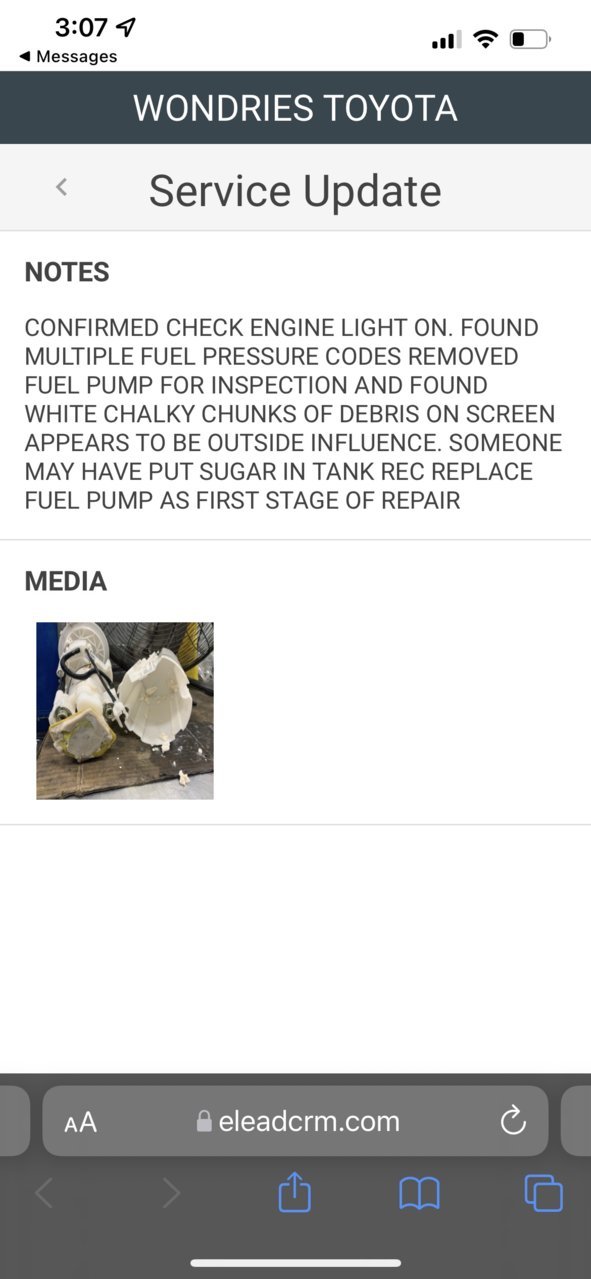

    Yeahhhh, some jackass poured sugar into my fuel tank.

    '21 TRD OR 4x4 DCLB Super White
    Not enough bandwidth on the internet to list.
    For reals?! I have never experienced such a wonderful thing nor do I know anyone that I am aware of that has had it happen. What was the remedy after going through that? Expensive?

    Funny thing is I’m an easy going person and always home (gated and garaged). I work at a ER, best guess is it happened there. But who knows, maybe someone hates me lol.
    So it was a $2k endeavor, went to the dealership and to be honest we are still unsure if it was sugar or something else. Either way, something got poured in there. Insurance covered most of it so it wasn’t too bad, still sucks though. Fuel tank/ fuel pump replaced, fuel lines flushed out.
    truck is good now, but has a random rough idle from time-to-time. I think the Injectors might still be a bit dirty.

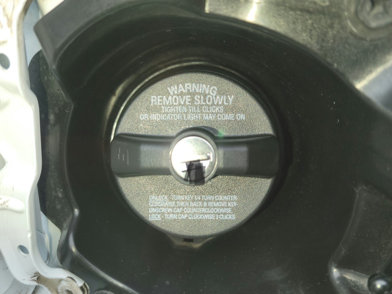

    I got my online order from O'Riley's today
    This is what came. Think this is the correct cap.
    I took a few pictures of this one and the counterfeit product I had that was past the return window.
    The one from O'Riley's is on the left and the questionable one on the right in theses photos.
    Just so others might know how to better spot a definite fake. IMG_20220120_164008__01.jpg IMG_20220120_164109__01.jpg IMG_20220120_164147__01.jpg
    You can see no raised S on the fake one, the box is bigger, different SKU under the Barcode, Print on the label is different and not as clear, print on the fake cap isn't white, key on the fake one is plastic too, the real one is all metal. The seals even look different. The one I got online from O'Riley's looks exactly like the one @GrizzledBastard posted that he got at his local O'Riley's store that worked for him. Mine is on the truck now, hopefully this 3rd cap will be a keeper.
    Edit: still working fine, no codes
    Edit: Still working great after 2 years, just make sure you turn it till it clicks
