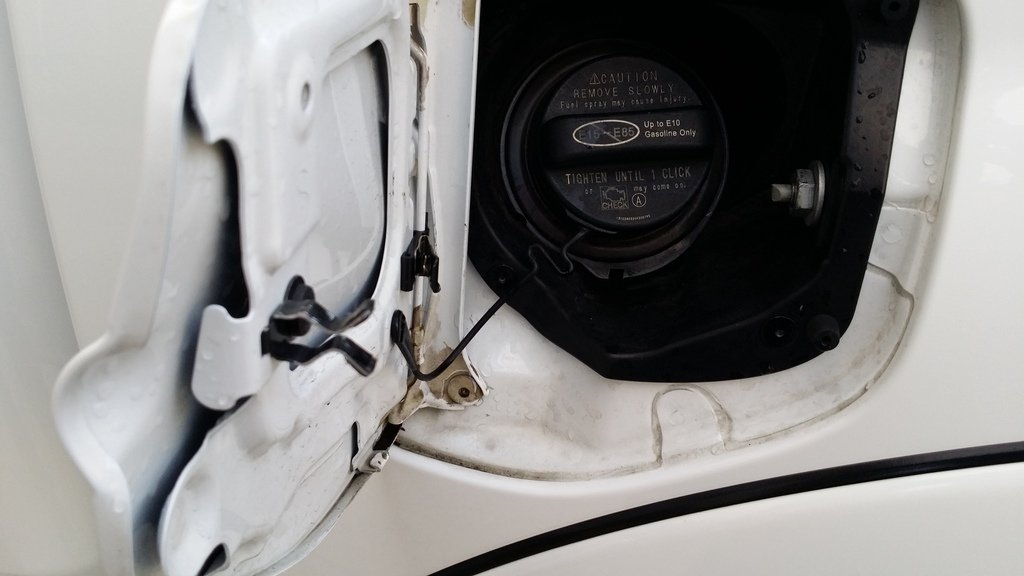

    Here's the stock clip and you can see the nut screwed on the actuator pin.
    Yes...you can go under the fender liner and try to remove the solenoid, but the threaded nut resides within the gas door compartment holding the actuator. Too much PITA if needed to get it off...imo

    Scroll up to post #46 and if you look at the gas cap cover door observe the little clip that is wedged in the door at the hinge point. My buddy @kh7nm had this clip from another gas cap door (can't recall the model), but he might be able to fill you in on where to get it. The wider the clip, the more force it will pop-open...
    Post #75 on this thread has great pics of the whole kit...
