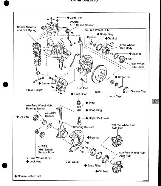

    I downloaded the 1995.5-1997 Toyota Tacoma PDF last night, funny you sent me there. The page (1056) I found is this one:
    I should point out that I'm assuming here that I have a 'free wheel hub'... exploded view:
    Is that what I need to pull apart? Am I on the right track?
    I should also point out that I'm fairly comfortable with anything mechanical, with guidance I'm golden. :D Furthermore, Lancaster is less than an hour from West Chester, and I have a nice clean shop with a large beer fridge! ;)

    Looks like what you need! :)
