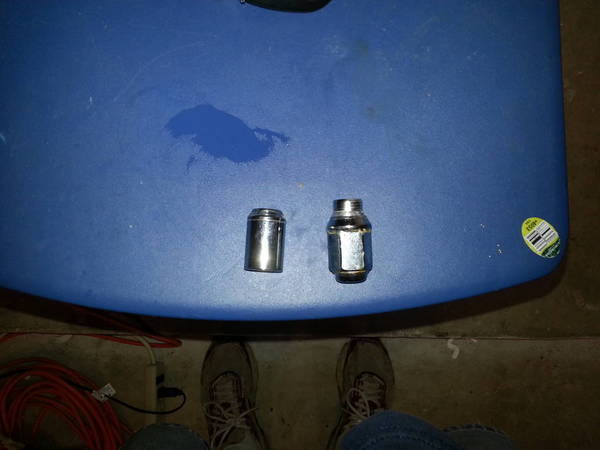

    Appreciate the offer of the photo,
    Just to be sure, here is the original lug
