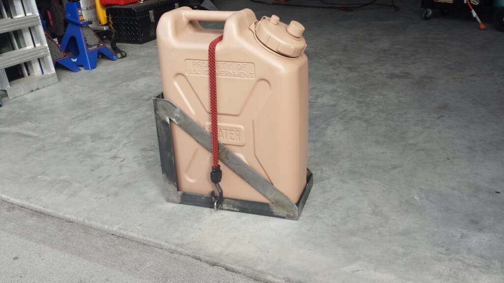

    These are all good ideas/points but I needed something with a small foot print.
    I will be mounting it to the forward rail in the bed and using a couple of rubber feet behind the plate to help keep the weight from bouncing it off the rail. I also went with the deluxe mount so I can keep a lot of tension on the can.
    My goal is to never use this can but with a 5000+ mile trip and a lot of offroad miles too I want to have it there if needed.
    I won't be leaving the can on 24/7. And it will be surrounded by pelican cases.
    I think I made a good choice here and once I get the mount in I will start working it.

    Do you have the dimensions of the carrier. I bought some metal today and want to get them built and painted before the cans come in. Thanks.
  16. Feb 14, 2015 at 12:11 PM

    Sure do. Give me a few....

    7"x14" exterior measurement. Make the sides as tall as you like. Mine is 11 1/2" tall from the base but you can make it full height or whatever you want.
    I used 1/8" thick 1 1/2" angle available at Lowes.

    Sweet that's the exact material I got from the hardware store. Hopefully I'll have some built this afternoon. Thanks! Also these dimensions should fit the plastic water cans as well as the metal "jerry can" correct?

    Yes, I used the metal one to build from and they have the little lip on the bottom so need more space.
    If you can get your hands on a metal one it makes it really easy since you can build it right off the can to ensure fitment.
