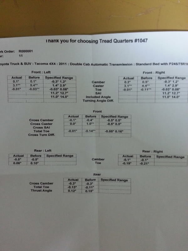

    Just got done getting her aligned...weird shit is that she is now showing 3 inches and some change front lift afterwards....most have been sone serious LCA movements.
    0 toe 0* camber and 3* caster....nice handling!

    Which tread quarters did you go to?

    Indian river and Kempsville. Not the cheapest but they do a good job and don't fight about non factory specs.

    That's why I wanted to know where you went, I don't want to fight about the caster. Priority Toyota really didn't want to go away from factory specs. How much was the alignment, I saw a coupon on line for $20 off.
