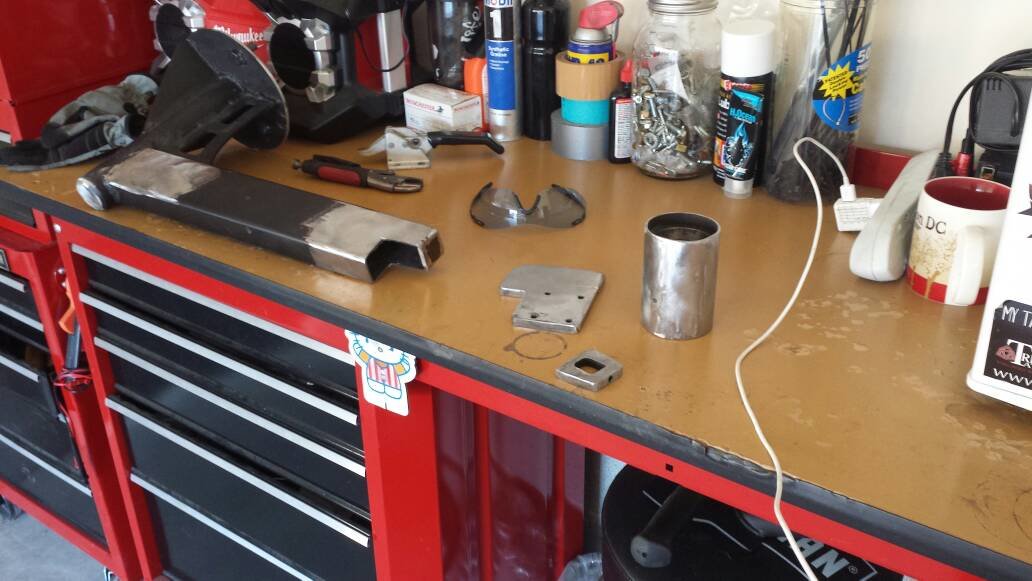

    Those tabs are the ones I used to mount my rear 2.0 shocks. The work well for only a couple of bucks. I used trailgear.

    Think I'm going to just try the sandwiching like I mentioned and if need be introduce the brackets to my bfh!
    That ought to work I would think...

    Exactly...in that case you can cut the bottom of the king mount off and mount it to your reinforcement plates and you're in there like swimwear!

    Everything is all prepped for the swingout build on Sunday. Can't wait to get my tire back where it belongs. Also relocating the camera at the same time so I can see with swingout.

    Easy... I am going to remove it from the tailgate and build a tab for it to mount to on the swingout and extend the wires. Easy day.
    AaronArf already moved his from the tailgate down to the hole where your oem spare tire spinner bar goes. He didn't even need to extend his wires but for sure I will need to...
