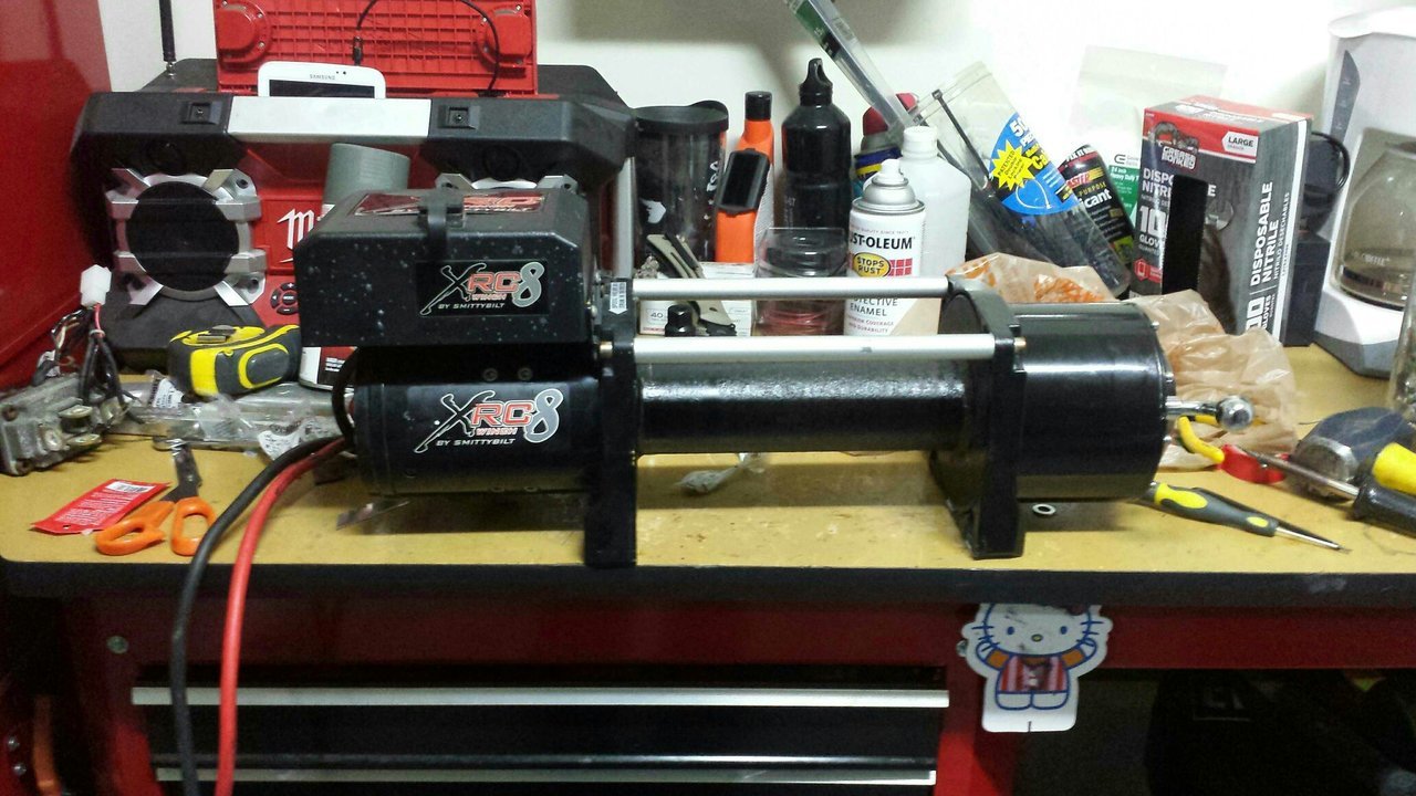

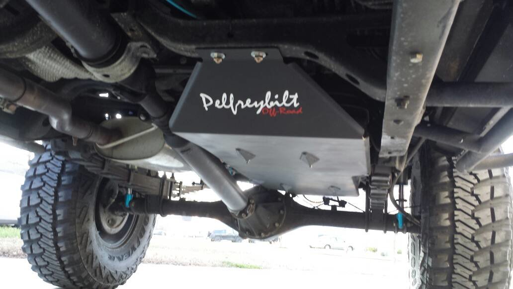

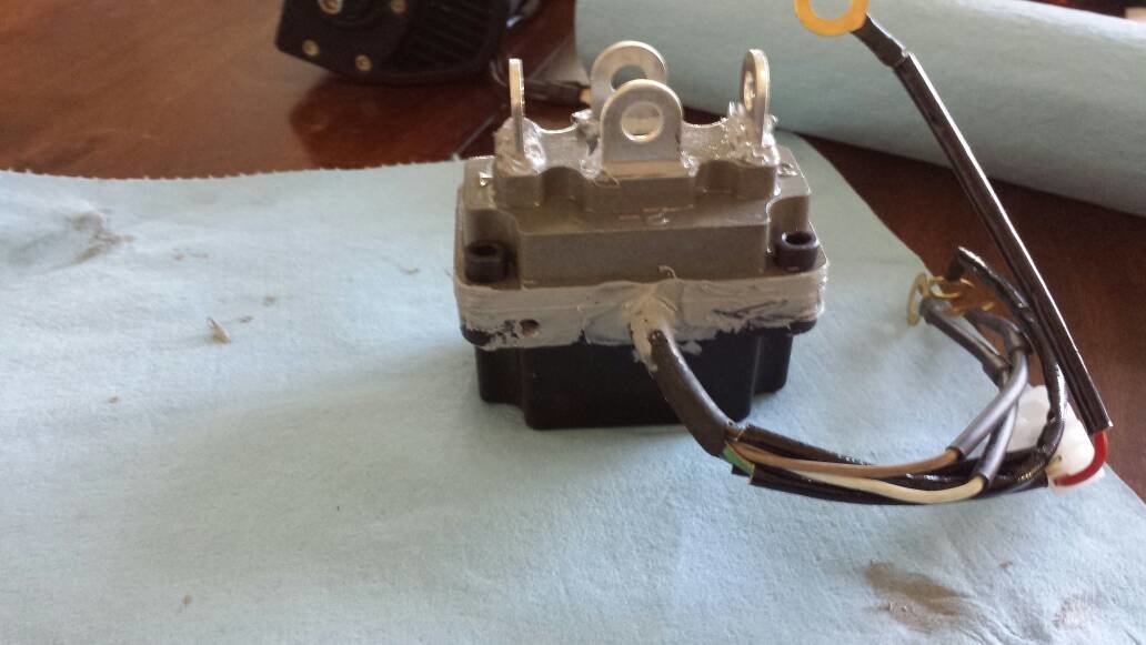

    Winch all back together and I can roll it by hand now with very little effort. Packed it up good with some nice marine grease. Just waiting on the RTV to set and then the solenoid is going back on...maybe tonight if I feel gamey.
    Also welded in the bolts for the gas tank skid and it turned out pretty damn good.

    Make sure you use dielectric grease on the solenoid to prevent corrosion....

    Most said none inside. Sealed well than a little dielectric on the plugs.

    Well its a land Cruiser with a diesel so I've got that going for me.
    Yeah inside the solenoid is supposed to be grease free. All connections are dielectric greased and she is all back together ready for install tomorrow. 60d43053b5d70df4743c6e399ab78459_3a16d01b158416f60f1bf3815ea22a959258887c.jpg

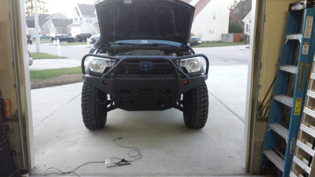

    Has hoops will travel...

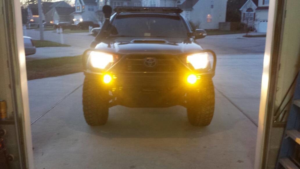

    Dis bitch has fog lights now in the fog light hole...

    :spy:
    Amber d2's? Kinda like the hoops that way with the extra supports on the center
    Yeah...D2s...yeah....no! They are 18w Sidetracked Offroads. I would never buy rigid lights unless they were used. Too fucking expensive!
