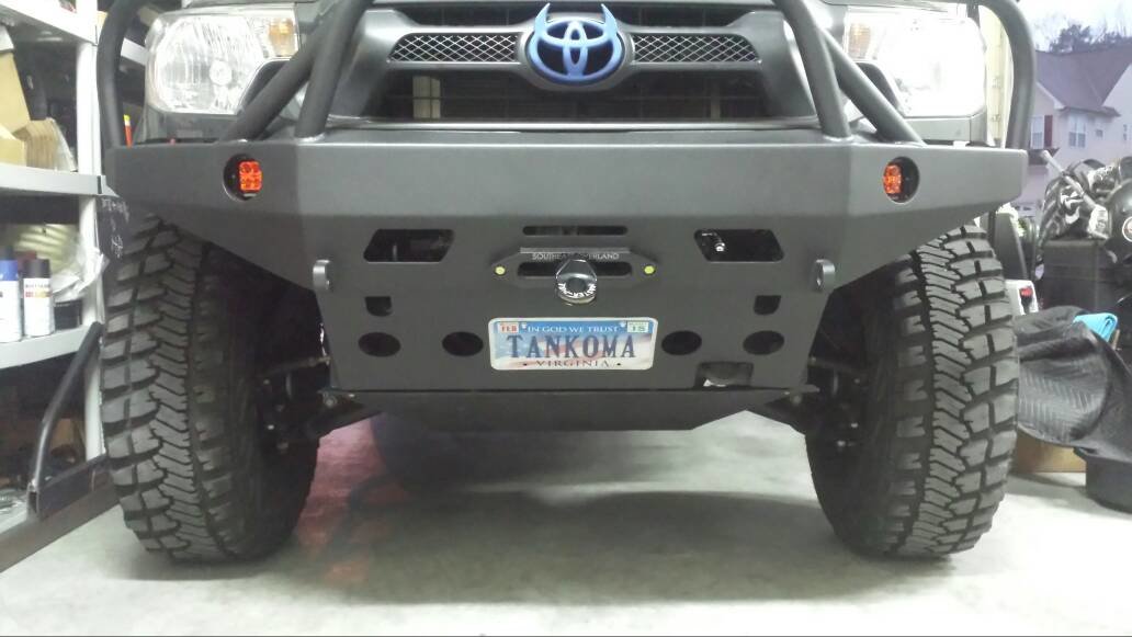

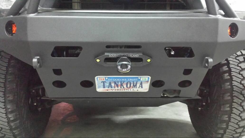

    It's a Masterpull Thimble...it actually replaces the Thimble and doesn't just wrap around it like the factor 55. Cheaper and leaves less chance for issues...just involves removing the original Thimble to install it or the line can be ordered with it installed.

    Side note...I installed it myself on my line after some good tips and training from Steve down at Southeast Overland. It was fun and a great training thing so now I feel comfortable repairing a line on the trail with minimal tools.

    $75? :eek: Damn that is half the price of what I paid.... So you had to rethread the line?

    Yes I had to remove the old Thimble and then you replace it with the Masterpull. It was really easy and I was even able to make the setup stronger as the smittybilt Thimble was incorrectly spliced in... so Steve showed me 2 different ways to splice and I chose the stronger of the two methods.
    I feel that I made the right choice especially after it was pointed out that the splice was pretty crapped from smittybilt.

    How hard was it to rethread the synthetic line? I've seen some videos on how to do it but it looks really complicated.

    It was pretty easy. The hard part is where you have to thin down the line when it's new but since this line already had that tapered section is was literally work it back out remove old thimble, install new thimble and then splice using the already tapered end. Start to finish 30 minutes and it was my first. Could easily cut that in half now if not even less.

    Bumper looks great and I am digging the black fairlead(on my list). Just letting you know I am looking into plane tickets to VA so that I can stop by and paint the fairlead bolts black for you:laugh:

    Just for that them zinc coated bolts will be there like that forever...hell I might even polish them up for you!
