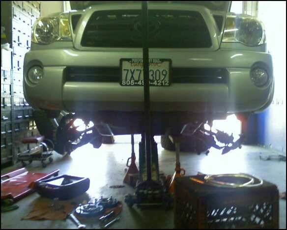

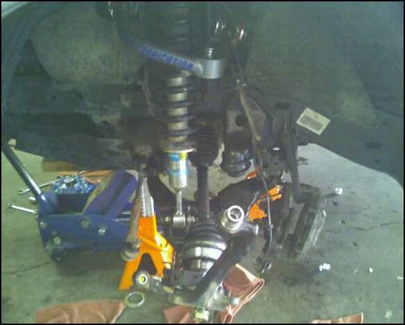

    Woke up this morning and drove to my buddies shop at 9:30 am to get some stuff done to the front end.. We replaced both front wheel bearings, both front CV axles, changed the front diff fluid, changed the oil, did the brakes, installed the diff drop....loooong ass day, but worth it. the front wheel bearings were TOAST. We had to cut the bearings off the hub, they were dry, and full of rust. She rides a lot better, no vibration in the front end or any kind of friction.. Please excuse my lack of photos or HOW-TO's. We were tryin to mash thru this ASAP..

    it was a pain the ^%&*%&* ass dude. It wouldnt fit in our press, and we called every shop in the area, even the toyota dealer, and they said they couldnt press the bearing out of the hub. we had to fab something up in order to press the bearing out of the hub. we used a 3/4 inch steel plate..cut a hole, tapped it so that we could screw the 4 bolts into it,mounted the hub to it, then used the press to push the bearing out. That worked, except it only pushed half the bearing out - so we had to cut the other half off. The bearing itself was about $150 i think

    well, i tore my CV boot a couple weeks ago, and when we took that axle out to fix the boot, is when we realized we needed to replace the bearings & axle. The bearings wouldnt spin freely, and when spun by hand, we heard a nasty grinding noise. When we got the axle out to fix the boot, we couldnt get the slip yolk off (if thats what its called?), it was frozen. it took a beating to get it apart. I probably could have gone w/o replacing both axles, but decided to do it anyways. A fresh front end is nice.
    Before doing all this work, i had a bad vibration in the front end while driving on the freeway..it's gone now.
    My buddy ordered them, im not sure where he got em.
    Also, the fluid that came out of the front diff, was NASTY. It was full of metal
