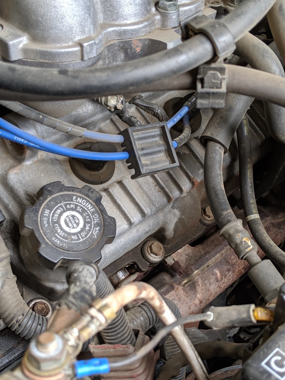

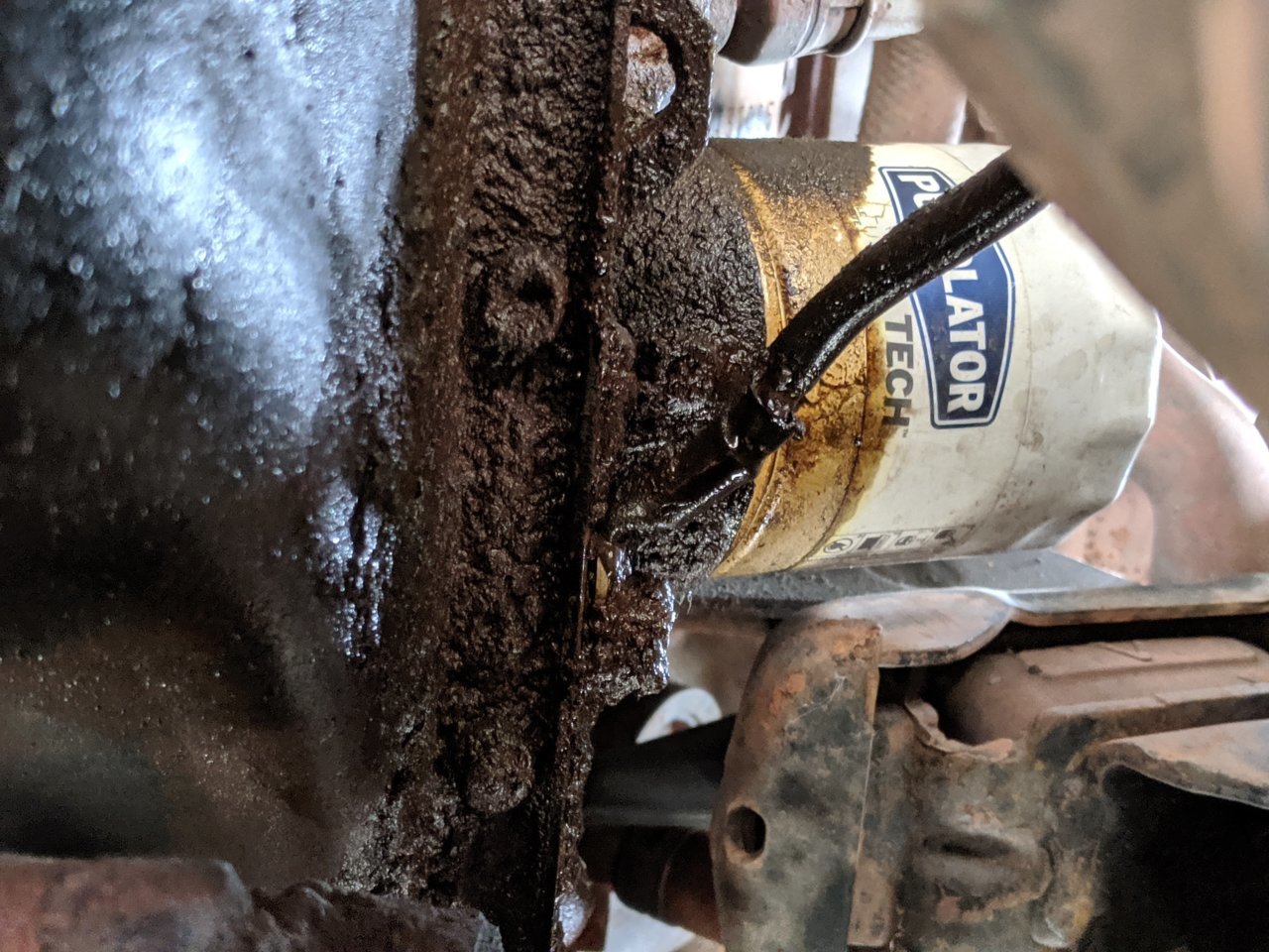

    This is the wettest and most grimy area I could find. My valve covers look good for the most part. In the back left (cylinder 3 I believe) there appears to be a little leak maybe, but not even close as the leak around my oil filter.

    Whoa yeah looks like your oil filter is leaking bad or maybe that line going underneath it? Not sure if that carries oil or not.

    Looks like the valve cover on that side might be bad too, or the bolts need just a small 1/4" turn. Don't turn them too much though, they require very little torque

    I think the line is electrical but I would need to check again. I bought a new Napa Platinum oil filter and some Mobil 1 synthetic high mileage motor oil so I'll do the change today.

    Maybe check the filter and make sure the seal from the one before it didn't get left on by accident (sometimes they get stuck)...that would cause it to leak badly. But usually when that happens it leaks so bad you lose a lot of oil very quickly.

    You think it's the gasket or cover itself? I'll give em a 1/4 turn just to see if that helps.

    Sorry I meant the gasket, it's a common issue with the 3.4l once the miles get high. Valve cover gaskets are a regular topic on the forum

    I've noticed! Doesn't seem like it's too complicated of a fix though. I'll add it to the list of things that need done lol. The bolts on the valve covers were all really loose. The back two especially. I gave them all a quick turn. Thanks for the tip!

    The line was indeed electrical. It was an engine ground wire. I cleaned up the area as best as I could, so hopefully with the new filter and the oil whatever was leaking becomes sealed. I did notice that the plastic gasket on the old filter was very very shallow, whereas the new filters gasket was probably double the size. Moving forward I'll be checking the dip stick to make sure I'm not losing more oil.
