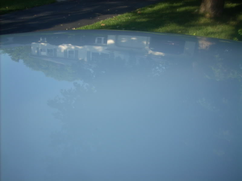

    Color does matter. Some colors are very hard to make the shine POP with a deep gloss. White and silver are the hardest colors to make pop. The attributes of the two colors that make it very hard to see swirl marks, scratches and dirt comes with the price of not showing a deep rich shine. This does not mean that there is no protection after you finish polishing and waxing. I have never worked on the MG color. I have seen the color at the dealers lot and it appears more dark than silver.
    If you are looking for a decent wax that will not break the bank the Natty's poor boys red is a fine product.

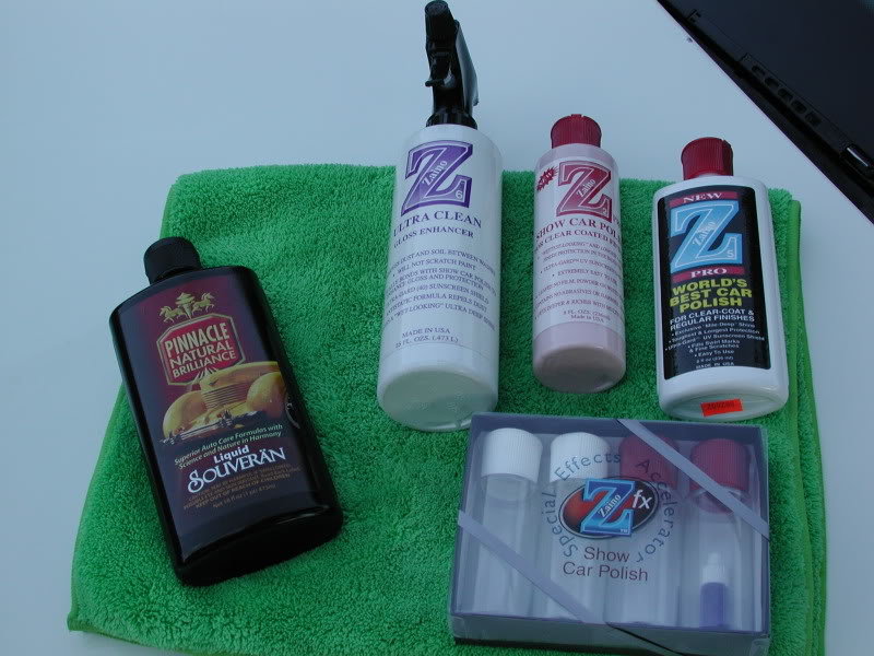

    Below is a rather long post of a full detail and write up I did on my sisters white Bonneville earlier this past summer.
    Detailed my Sister’s 98 Bonneville
    About a month ago I offered to troubleshoot a keyless entry problem on my sister’s car. When I opened the hood to check a fuse in the fuse center I was real sorry that I did not have any gloves with me. Right then I offered to detail her car. This past week my sister has been at the ocean and I had the car from last Thursday till tomorrow. She will be amazed when I return the car.
    My basic process was as follows.
    Wash car with Z7
    Claybar with leftover Pinnacle Poly, Megs smooth surface, and Z18 clay.
    Use Makita with FMP and SIP for major scratches
    Use Makita with FMP and Micro for swirl marks on paint.
    Use PC7424 white pad and Micro on the plastic body cladding.
    Use PC7424 with blue pad and PO85RD for final polish
    Do an IPA wipe down
    1 coat of Z5P
    Z6 wipe down
    1 coat of Z2P
    2 coats of Pinnacle Liquid Souveran wax

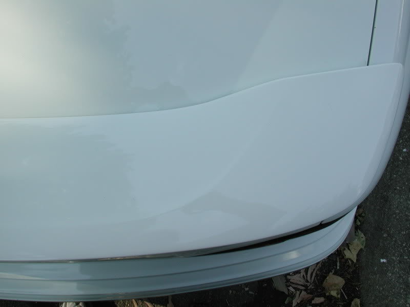

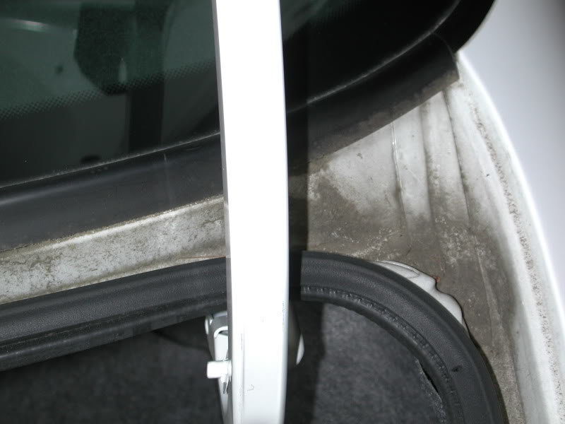

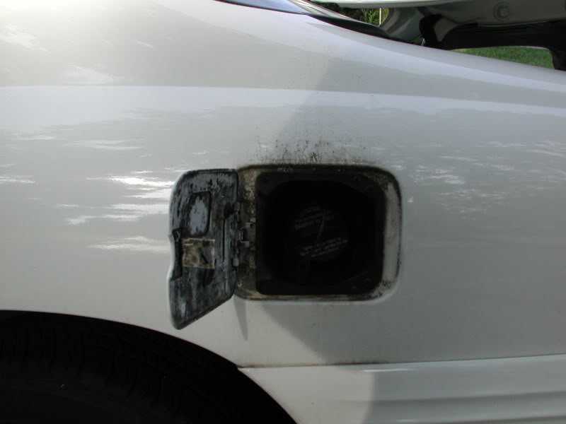

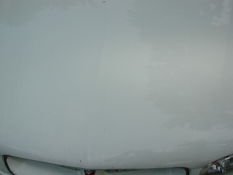

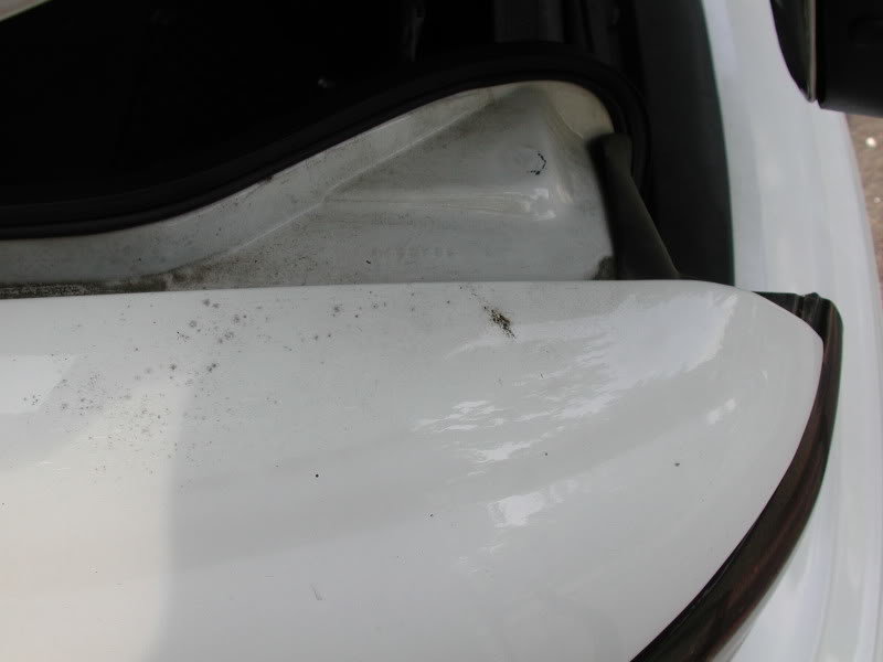

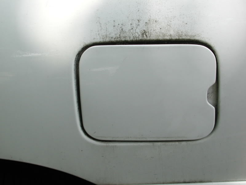

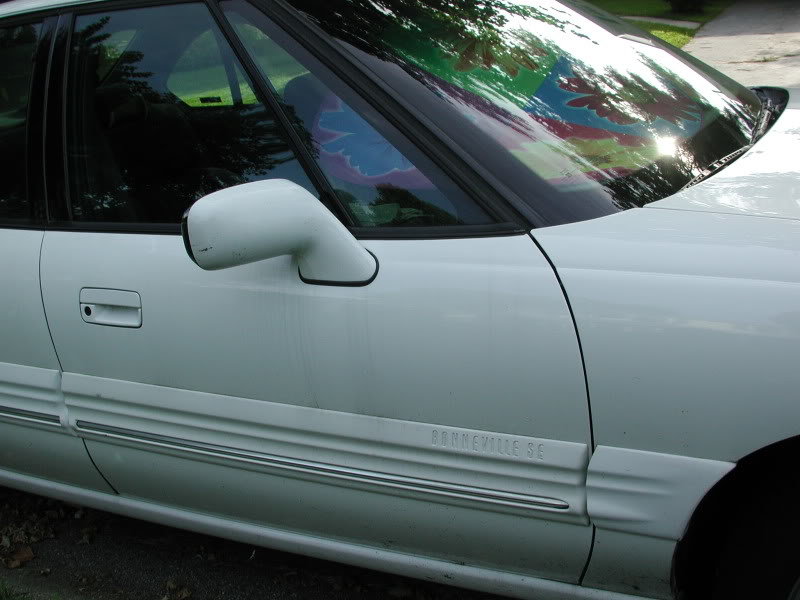

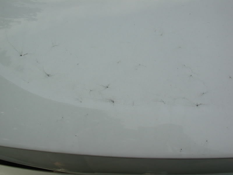

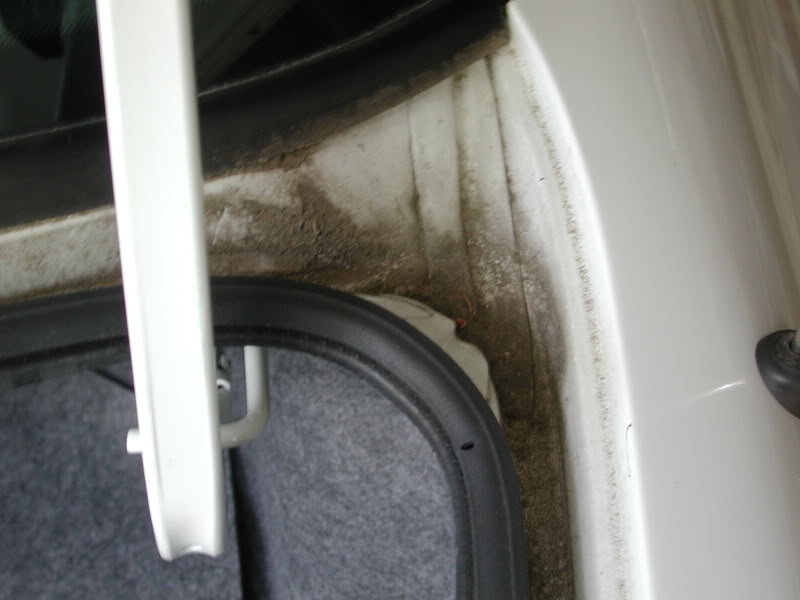

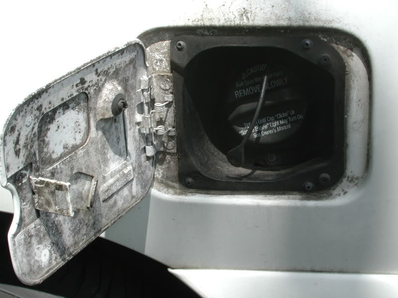

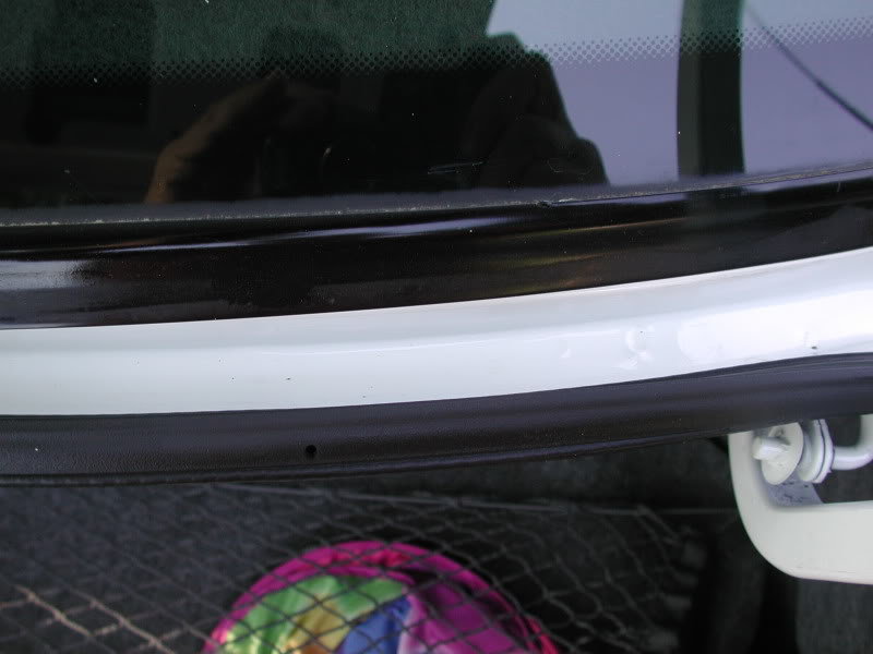

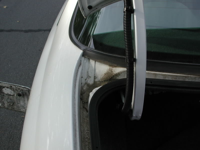

    Here are some before pics.
    Just Nasty.

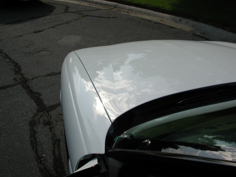

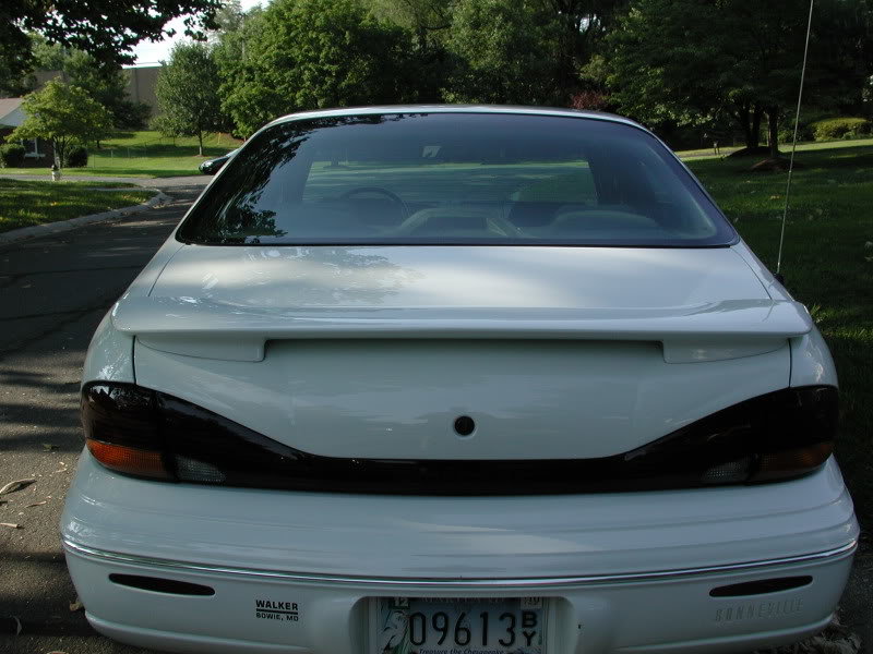

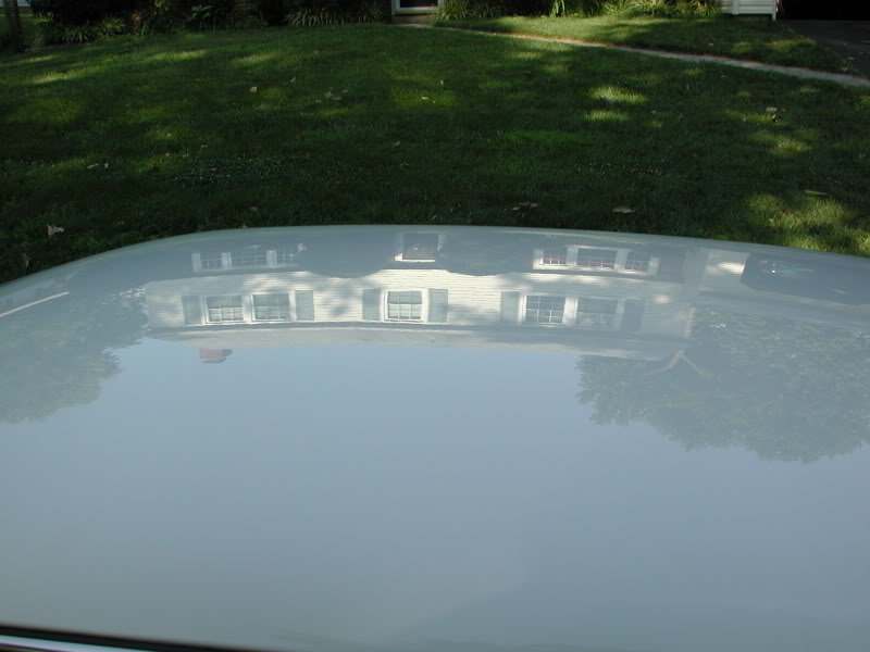

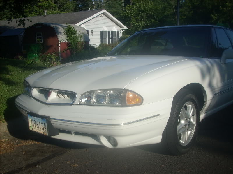

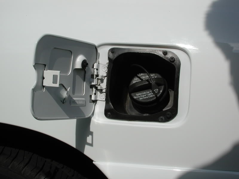

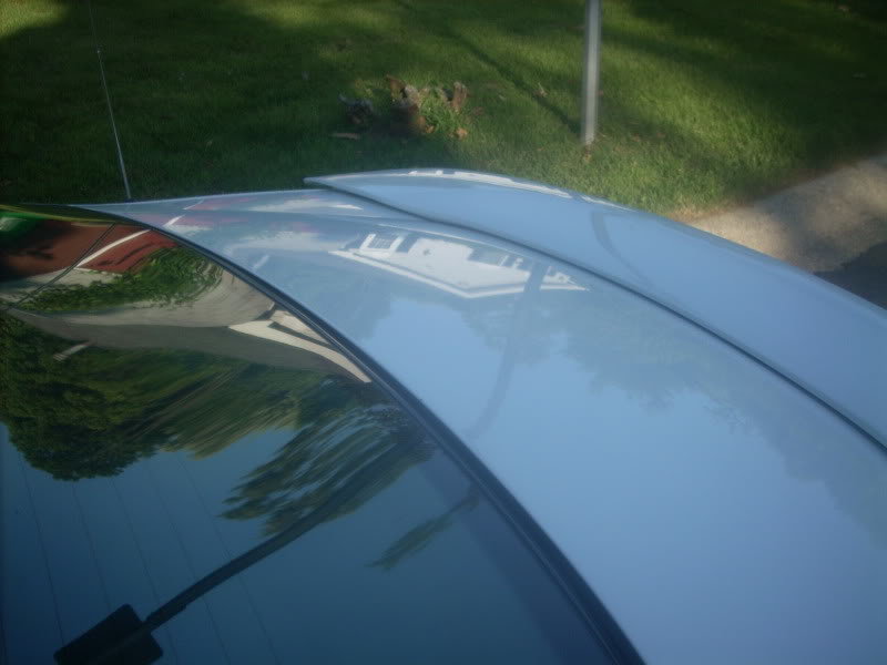

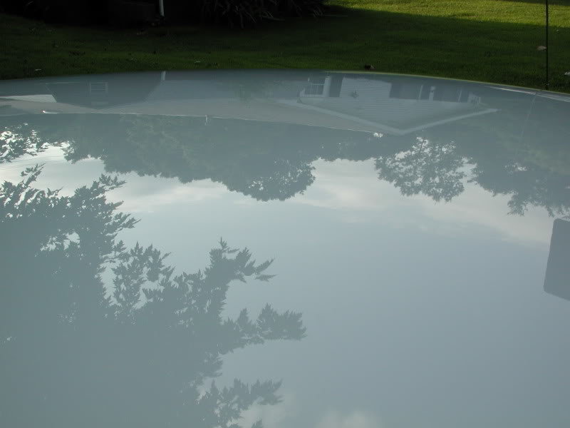

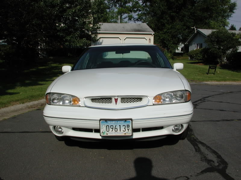

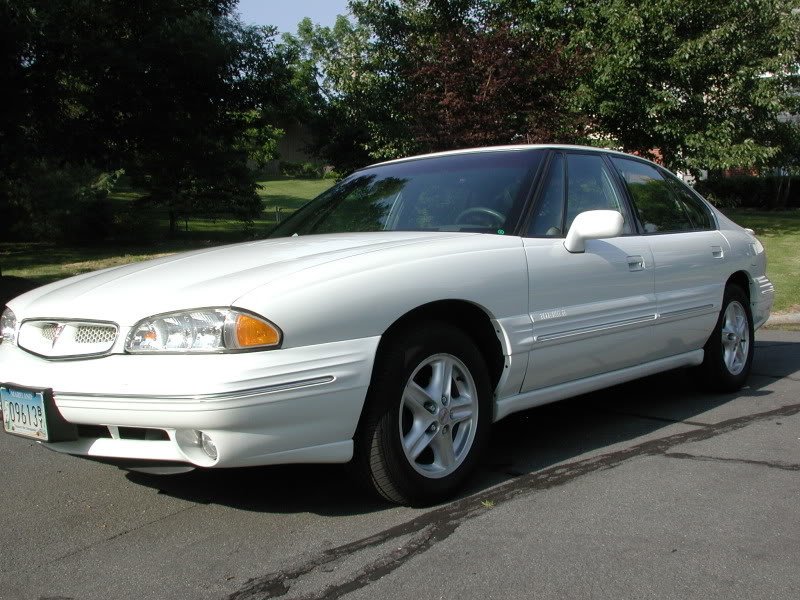

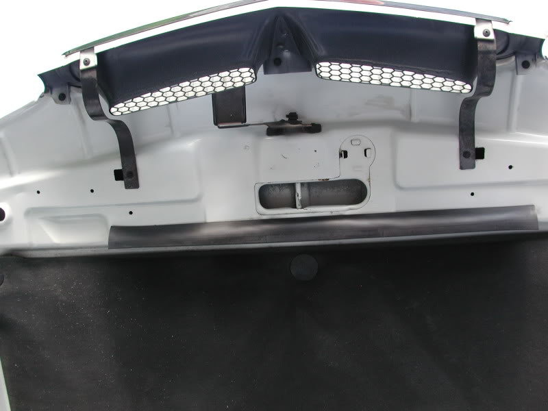

    Then we polish, seal and wax.

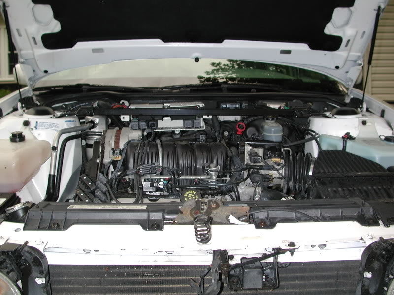

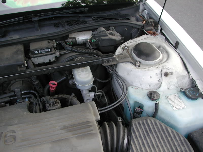

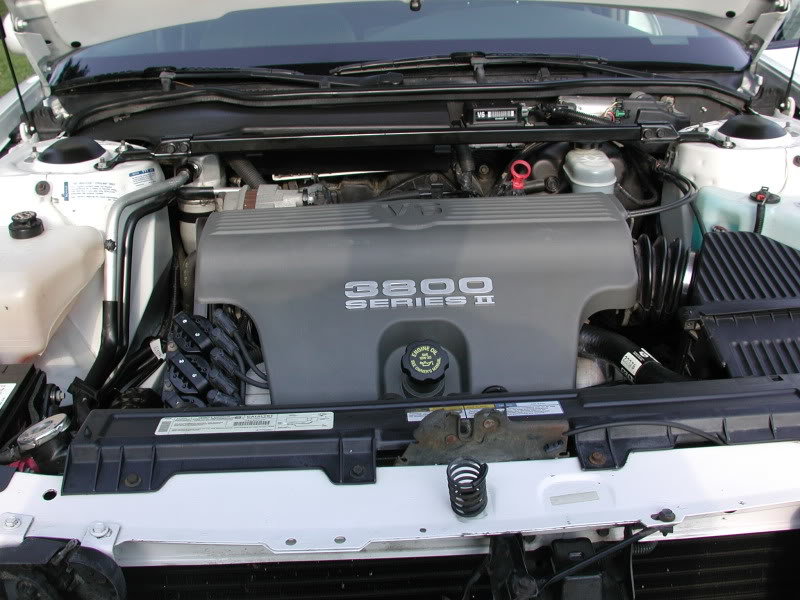

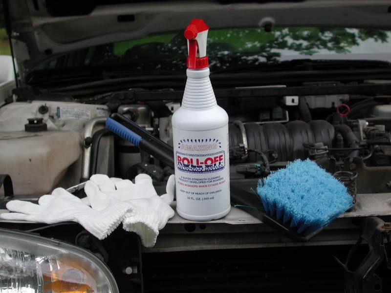

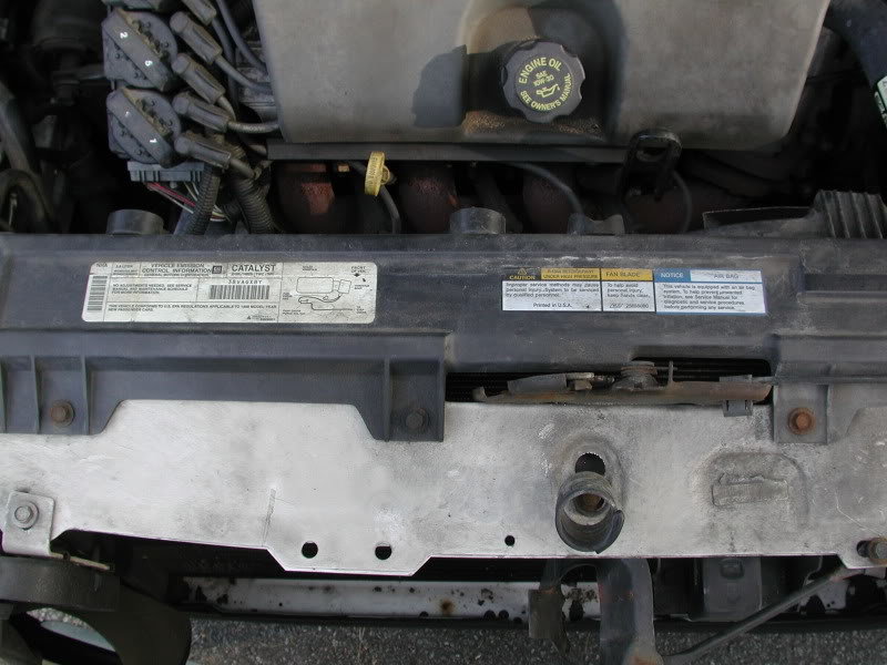

    Engine Bay was filthy.

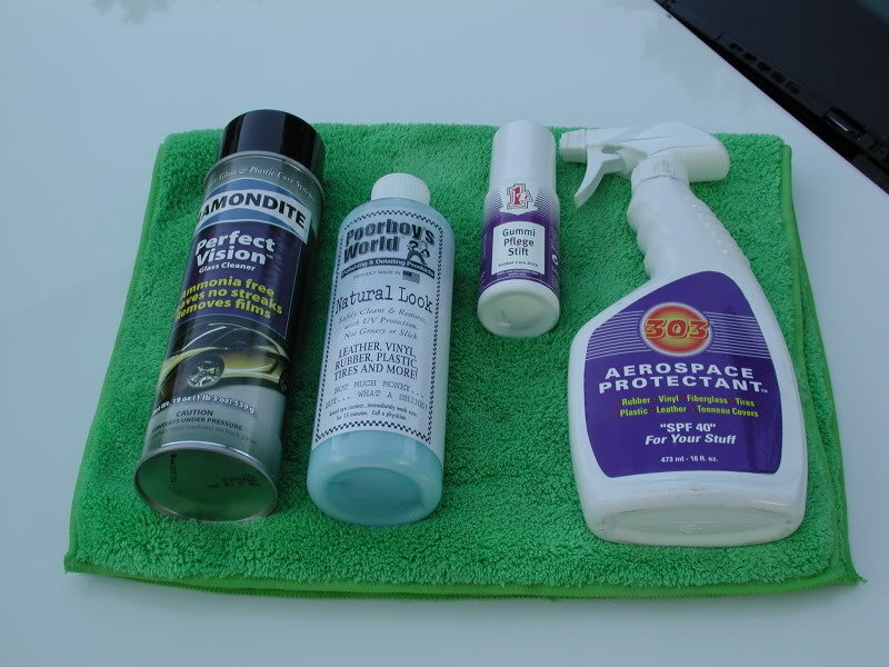

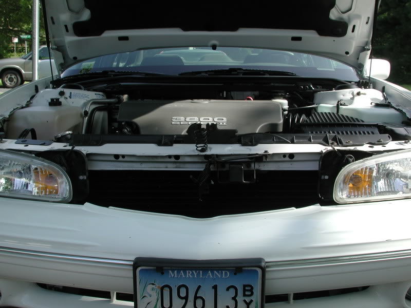

    ARO, Microfiber gloves and a brush took care of the filth. 303 added some protection to the rubber and vinyl items and Gummi Pflege helped with the seals. Diamondite window cleaner helped with the windows. Poor Boys cleaned the inside plastic and Folex cleaned the carpet and cloth seats
    Opps all better now.

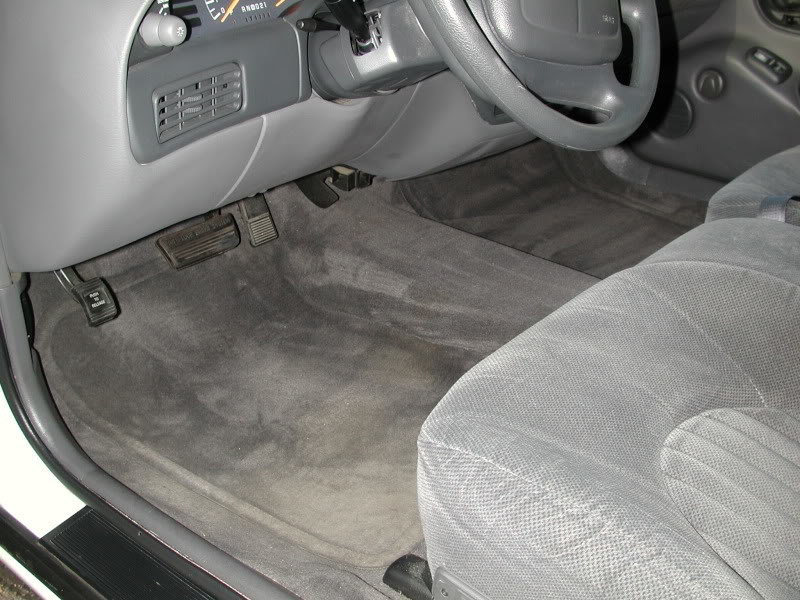

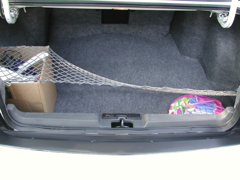

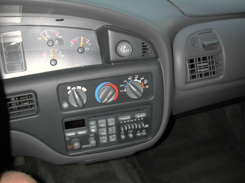

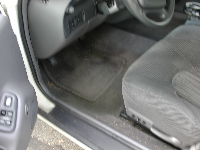

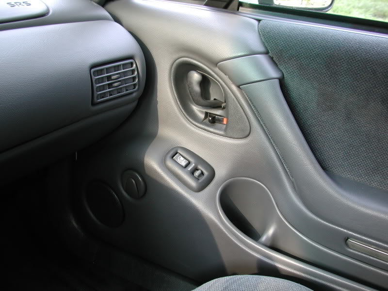

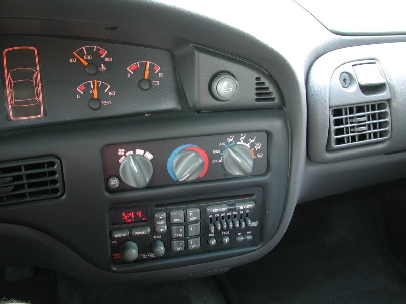

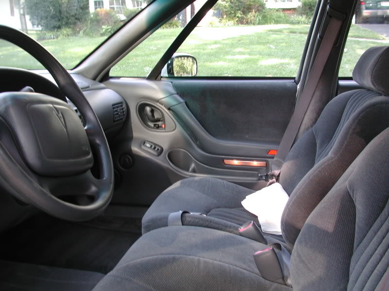

    Now for a few interior shots.
    Only one before shot but the entire interior was in this shape which was not too bad.

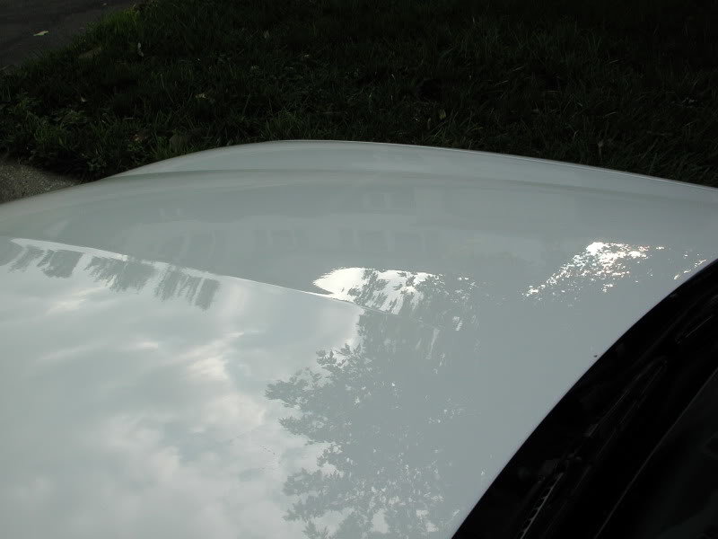

    The After shots
    I would like to thank Rsurfer, Killrwheels, Harleyguy and Asphalt Rocket for answering my questions on the forum or via PM to go ahead and top a sealant with a wax. And to help with my questions on using a Makita Rotary.

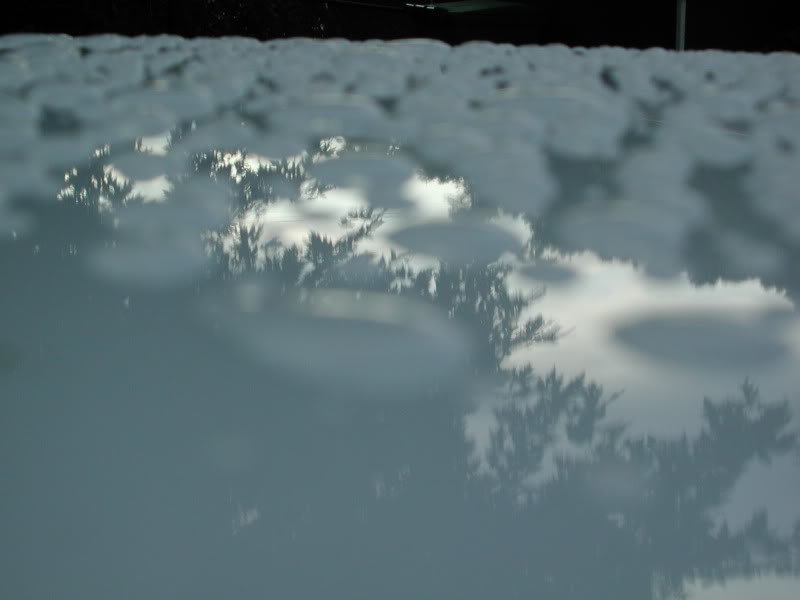

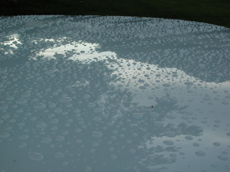

    I have to say that I really like the way Pinnacle Liquid Souveran wax looks on white. The wax goes on smooth and wipes off easy. It is like using liquid butter.
    It rained last night so I took a few morning bubble pics because I know you guys love them.

    Sorry I should have included the translation of the process that was used on my sisters car.
    Wash car with Z7- Zaino car wash. Zaino for the most part uses a Z then a number to name the products.
    http://www.zainostore.com/Merchant2/merchant.mvc?Screen=PROD&Product_Code=Z-7&Category_Code=Zaino&Product_Count=14
    Claybar with leftover Pinnacle Poly, Megs smooth surface, and Z18 clay. Three different types of clay. http://www.zainostore.com/Merchant2/merchant.mvc?Screen=PROD&Product_Code=Z-18&Category_Code=Zaino&Product_Count=20
    Use Makita with FMP and SIP for major scratches. Makita Rotary and Menzerna Super Intesive Polish.
    Use Makita with FMP and Micro for swirl marks on paint. Foamed Wool Pad and Menzerna Micro Polish.
    Use PC7424 white pad and Micro on the plastic body cladding. Porter Cable 7424 Random Orbital Buffer. Lake Country white pad for polishing.
    Use PC7424 with blue pad and PO85RD for final polish Menzerna fine finishing polish.
    Do an IPA wipe down Isopropyl Alcohol
    1 coat of Z5P Zaino swirl hiding sealant.
    http://www.zainostore.com/Merchant2/merchant.mvc?Screen=PROD&Product_Code=Z-5&Category_Code=Zaino&Product_Count=8
    Z6 wipe down Zaino Quick Detailer or QD
    http://www.zainostore.com/Merchant2/merchant.mvc?Screen=PROD&Product_Code=Z-6&Category_Code=Zaino&Product_Count=13
    1 coat of Z2P Zaino clear sealant.
    http://www.zainostore.com/Merchant2/merchant.mvc?Screen=PROD&Product_Code=Z-2&Category_Code=Zaino&Product_Count=6
    2 coats of Pinnacle Liquid Souveran wax The last step process referred to as a LSP. This is a nice wax that was recommended to make a white car pop.
