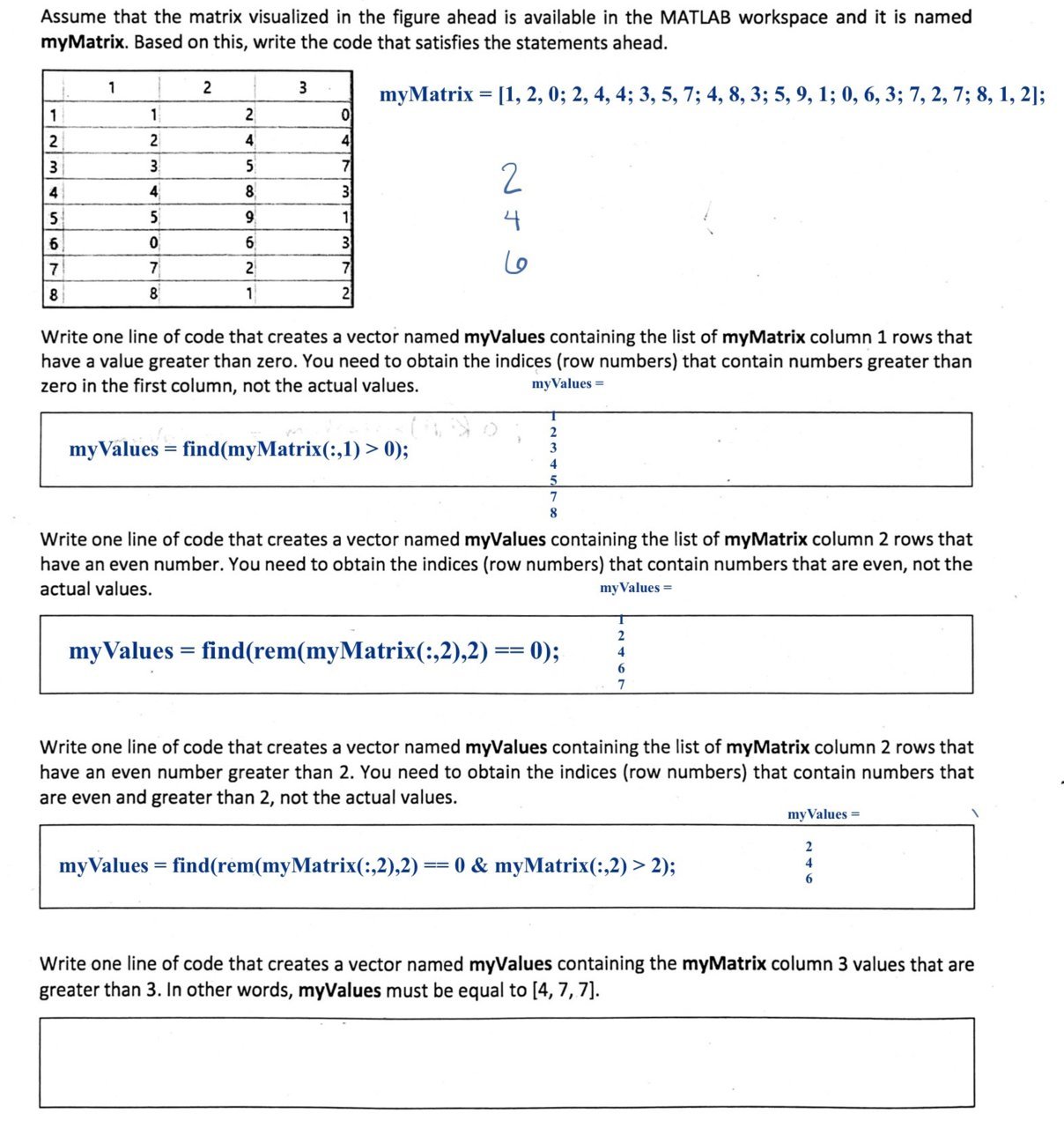

    I am attempting to get the last part of this done.
    I have attempted the following code and a few others but havent gotten a return of the values (which should be [4,7,7])
    myValues = myMatrix( :,3) & myMatrix( :,3) > 3;
    which returns the indices but not the values.
    myValues = myMatrix( :,3) > 3
    returns a logical array but thats not what I am looking for

    I got it to work using
    myValues = myMatrix(find(myMatrix( :,3) > 3),3);
    Most of the time I don’t have problems with programming (I have prior experience with java). I’m older than most as a civil engineering student but I am understanding most of the MatLab programming better than the rest of my class.
