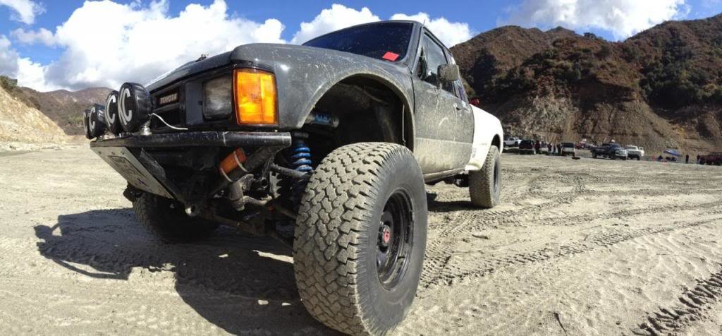

    Truck w/ Mileage- 1987 Toyota Pickup/ 400,000+
    Front Suspension- Total Chaos Get 2 kit LT
    Front Shocks- king Coilovers
    Rear Suspension- 62" Deaver f-67 w/ Total Chaos 12" shackles
    Rear Shocks- 16"FOA triple bypasses
    Front Spring Rate- 500lb
    Front Valving- Default
    Front Bypass Settings- N/A
    Rear Valving- Default
    Rear Bypass Settings- N/A
    Front Fenders- Mcneil fiber glass fenders
    Rear Bedsides- Glass works 89-95
    Front Track Width- Not sure, never mesured
    Rear Track Width- Stock
    Wheels- 15" soon to be American racing mojave teflon
    Tires- 33x12.50 procomp
    Engine Modifications-
    Drivetrain Modifications- NA
    Gussetting- No Additional Gussetting at this time.
    Additional Specs-
    Additional Modifications- Front Bumper, Taco seats
    Estimated Investment After Truck Purchase- <> Too much to rememer

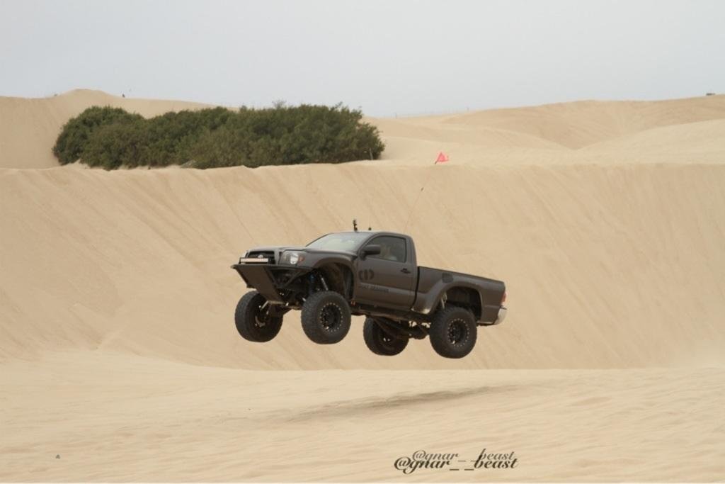

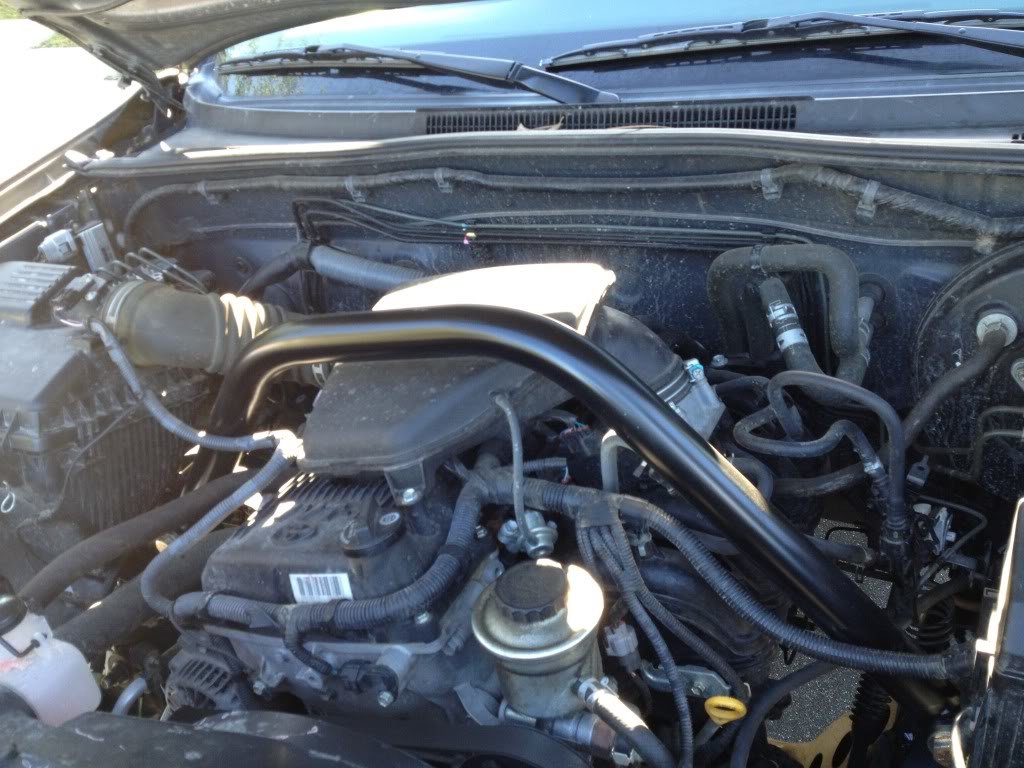

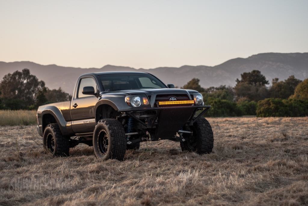

    Truck w/ Mileage- 2009 Tacoma Regular Cab Prerunner. 73k and counting
    Front Suspension- Dirt Designs Long Travel Kit with Spindles
    Front Shocks- Standard King Remote Resi 2.5x8"
    Rear Suspension- Stock front hanger, 12" shackle, f67s, 2.0x4 bumps
    Rear Shocks- 2.5 King Double Bypass
    Front Spring Rate- 600lbs
    Front Valving- 20comp. 12reb
    Front Bypass Settings- none
    Rear Valving- 12comp. 10reb
    Rear Bypass Settings- Rebound open, Comp 5 turns from full open
    Front Fenders- Mcneil 4" Flare
    Rear Bedsides- Glassworks 4.5" Flare
    Front Track Width- 88"
    Rear Track Width- im guessing around 85"?
    Wheels- Method Standards 17x9mm 4.5 backspacing
    Tires- BFG MudTerrains T/A KR
    Engine Modifications- Stock
    Drivetrain Modifications- Stock
    Gussetting- Dirt Designs Crossover Tube, TC Alignment Cams
    Additional Specs- Flowmaster 44
    Additional Modifications- Front bumper built by DTF Fab. Flowmaster 44, 1.5wheel spacers in rear.
    Estimated Investment After Truck Purchase- i stopped counting last year haha.

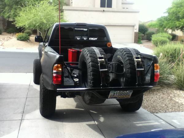

    Truck w/ Mileage- 2001 prerunner v6 ext cab 115k miles
    Front Suspension- MMW custom 6in over kit
    Front Shocks- Race runner/Sway aways.
    Rear Suspension- All Pro 8leaf pack, poly bumps, "Mini bedcage"
    Rear Shocks- 10" fox 2.0 Resi's
    Front Spring Rate- Kings (600lb)
    Front Valving- Unknown
    Rear Valving- Unknown
    Front Fenders- Fiberwerx 4.5in
    Rear Bedsides- Fiberwerx 4.5in
    Front Track Width- 85"
    Rear Track Width- 76"
    Wheels- Wheelers steelies
    Tires- Cooper ATP 265/75/r16 Spares 33/12.5/r16 BFG Km2s
    Engine Modifications- Spectre C/A intake, Garage fab 1/4in boxed frame perches, Bomb proof motor mounts
    Drivetrain modifications- Soild mounted tranny/motor
    Gussetting- Trailgear rear frame box kit, TC cam tab gussets
    Additional Specs- Front: Fox 2.5" air bumps, Limit Straps Rear: 1.5in allpro wheel spacers.
    Additional Modifications- Custom front and rear bumpers (garage fab'd myself), 22Gallon Jazz racing fuel cell, 3 Kragen 7in HID offroad lights. amber chase light, blue chase light, Magnaflow exhaust.
    Estimated Investment After Truck Purchase- <> Tooo much!! :notsure:

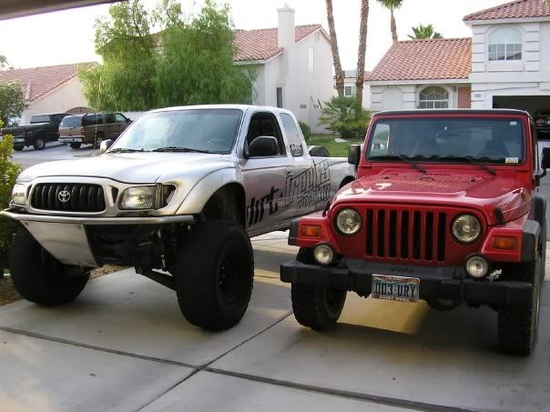

    Truck w/ Mileage- 2004 Tacoma Prerunner
    Front Suspension- MCM Fab Tacoma Race Kit
    Front Shocks- King 3.0x10 Bypass, 2.5x10 Coilover
    Rear Suspension- 62" Deaver H-70 (actually E somthing now I think) with custom 12" shackles
    Rear Shocks- King 3.0x18 Four tube bypasses
    Front Spring Rate- UNK
    Front Valving- UNK
    Front Bypass Settings- UNK
    Rear Valving- UNK
    Rear Bypass Settings- UNK
    Front Fenders- Fiberwerx Tundra Conversion 1 Piece
    Rear Bedsides- Fiberwerx 8" bedsides
    Front Track Width- 85" (est.)
    Rear Track Width- 83" (est.)
    Wheels- American Racing Baja 5.25" Backspacing
    Tires- 35x12.5x15 General Grabbers
    Engine Modifications- AEF Intake, Doug Thorley Headers
    Drivetrain Modifications- Currie Housing/35 spline Axles, Strange 3rd w/6.00,
    Gussetting- Tons, front/rear frame.
    Additional Specs-
    Additional Modifications- Fiberwerx dash/center console, Twisted Stich seats and window nets, Lowrance Elite 5M, fully caged with 2" DOM cab, 1.75" throughout the rest.
    Estimated Investment After Truck Purchase- <> Guessing $15k-$20k
    Tons of build pics and vids on our Facebook page:
    July 2009, the day I bought it....

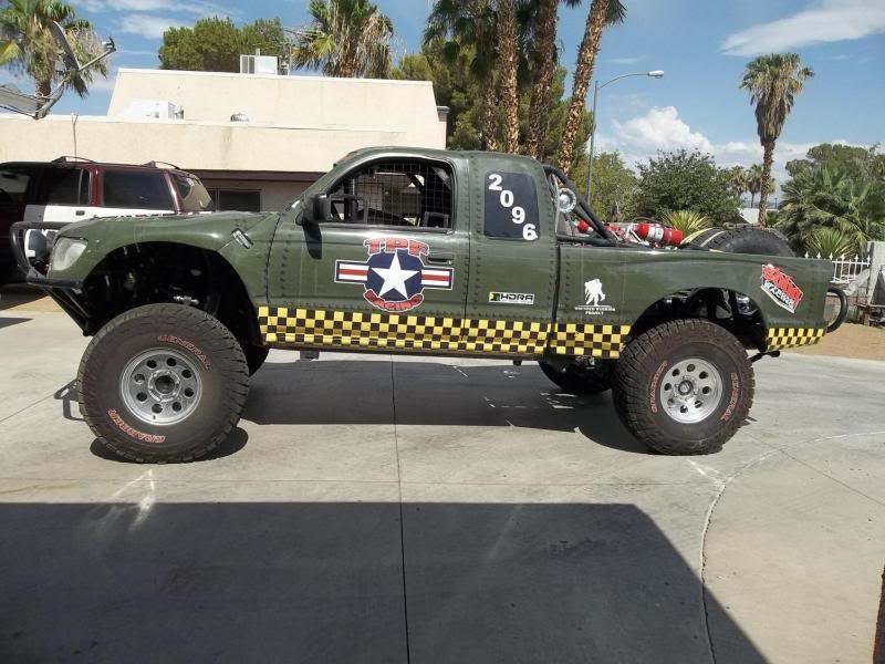

    How it looks today almost exactly 4 years later...

    ^ love that paint job!

    Looks like a wrap

    Thanks, and yes it's a wrap done by Warrior Wraps in Las Vegas, NV. We kicked around the idea of just painting the truck in an OD Green and then adding some logos, etc but worked out a great deal on the wrap and was super excited about how it turned out.
