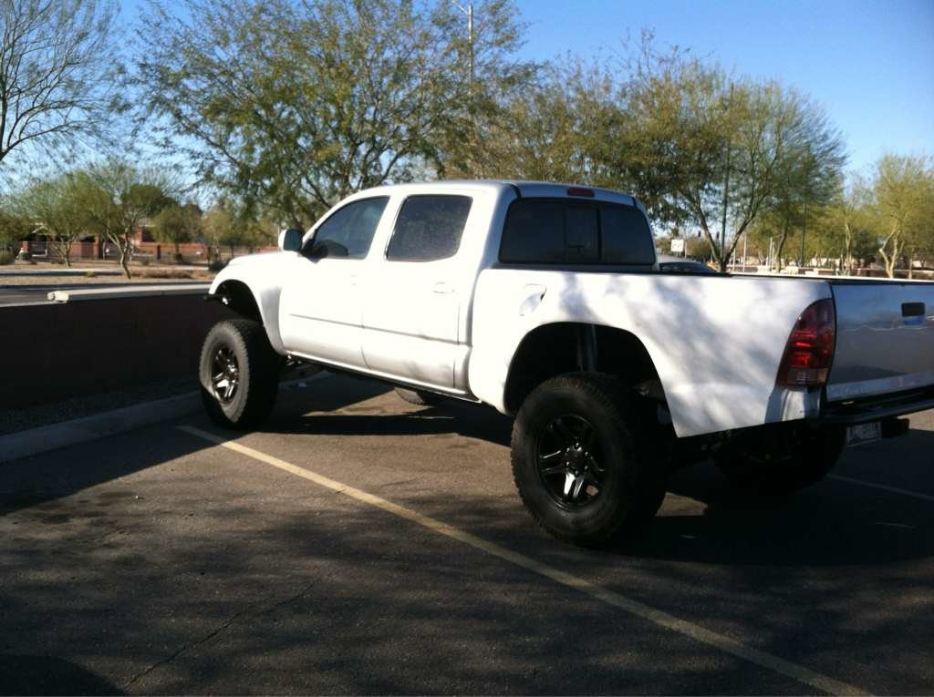

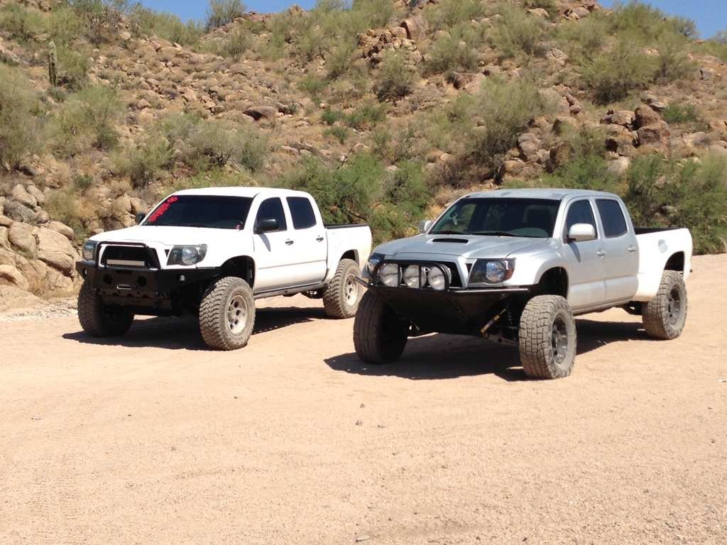

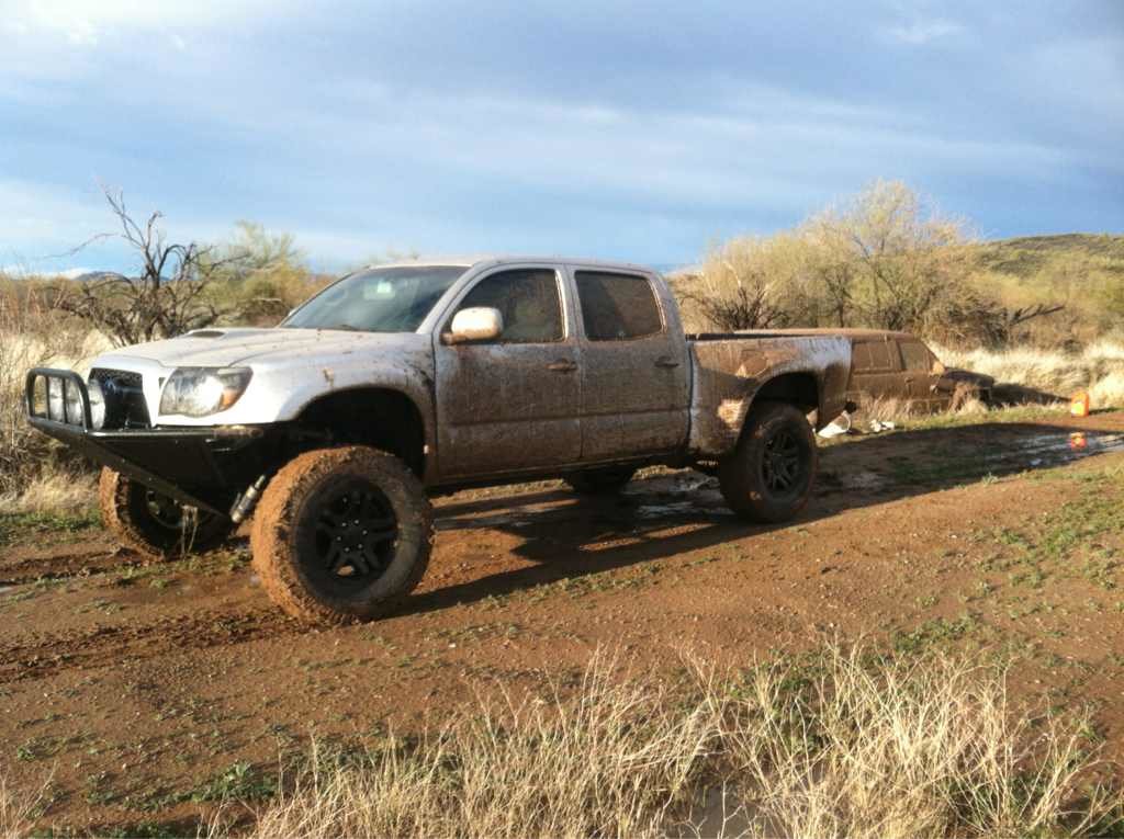

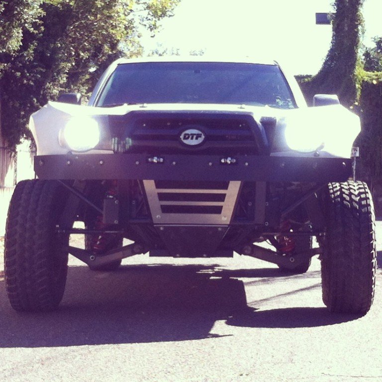

    Figured I would finally add my truck to the list.
    Truck w/ Mileage- 2005 Double cab long bed 124000mi
    Front Suspension- Total Chaos Long Travel Kit, Allied Motorsports 4" lift spindles
    Front Shocks-Fox remote resivoiur coil overs
    Rear Suspension- Dmz Spring under
    Rear Shocks- 16" Fox Double Bypass
    Front Spring Rate- 500lb
    Front Valving-
    Compression
    1.8 x .008
    1.6 x .006
    .8 x .010
    1.4 x.008
    .8 x .010
    1.8 x .015
    1.6 x .015
    1.42 x .015
    1.35 x .015
    1.1 x .015
    Rebound
    .8 x .012
    .95 x .012
    1.1 x .012
    1.35 x .012
    1.42 x .012
    1.6 x .012
    Front Bypass Settings- N/A
    Rear Valving-
    Compression
    3x) 1.8 x .015
    2x) 1.6 x .015
    1.42 x .015
    1.35 x .015
    1.1 x .015
    .95 x .015
    .8 x .20
    Rebound
    .8 x .008
    .95 x .008
    1.1 x .008
    1.35 x .008
    1.42 x .008
    1.6 x .008
    Rear Bypass Settings-
    Compression 6 full turns in
    Rebound all the way open
    Front Fenders- Glassworks 4.5" Flare
    Rear Bedsides- Glassworks 4.5" Flare
    Front Track Width- 88 out side to outside
    Rear Track Width- Never measured
    Wheels- Stock Tundra wheels 17x7.5 4.5BS
    Tires- Bfg All Terains 315/70/17
    Engine Modifications- Afe Stage 2si Intake, Urd Maf calibrator, Spintech muffler replacing stock.
    Drivetrain Modifications- Regeared to 4.88, powertrax locker
    Gussetting- Frame boxed from gas tank back. Stock hitch moved into frame
    Additional Specs- 3 lightforce 9" 240 blitz hids on the front.
    Additional Modifications-Front bumper, rear bumper, and bed cage all built from 1 3/4 .120 wall tube.
    I'm not a picture taker so here is what I have on my phone.

    Are you 4x4 ?
  17. Aug 29, 2013 at 1:55 PM
    #117
    05TacoRunner
    05TacoRunner You say tomato.......... I say fuck you!
    Apr 26, 2011
    #55578
    3,664
    Jason
    Peoria, Az
    Aftermarket nuts and bolts
    No sir
  18. Aug 29, 2013 at 1:57 PM
    #118
    precoma
    precoma Well-Known Member
    Jun 23, 2011
    #58730
    5,358
    Corey
    Lake Arrowhead, CA
    2009 4x4 trd sport
    Total chaos Long travel kit, swayaway coilovers, deaver leaf pack with icon resi's
    Ahhh nice truck man. I couldent tell if in the muddy pic if it was cause your 4wd or just the front tires being so far out the fender haha

    That white truck is pretty sexy
