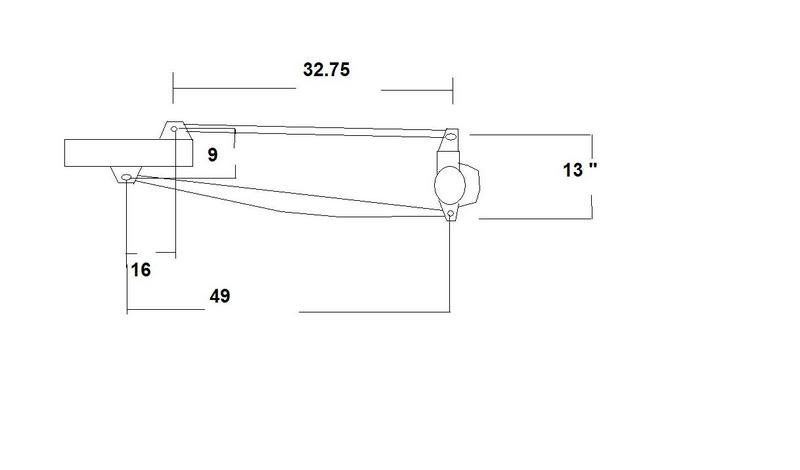

    Ooooh yeah. Slowly getting it. Link separation, pinion angle, anti squat, all that stuff.
    Speaking of a/s , saw a real nice, super wide, leaf sprung 2nd gen Lt DC Tacoma last week out in el cajon. Holy a/s batman !! Rear rose a good 6" under load. Im shooting for minimal a/s. Lots of measurements and angle finding in my near future.

    Here is a shitty paint drawing but it will get you in the ball park

    Question: What is anti-squat?
    So the truck doesn't squat under load?

    Right on. With that hypothetical set up, what a/s % is that ?

    Step on gas, rear end goes up, and not down. That's anti squat in the crudest of explanations.

    Your over thinking it trying to.figure out percentages. Keep your pinion change.reasonable, the plunge reasonable, and make sure the instant center is somewhere in front of the flywheel.

    Also, you could make the upper link mounts have holes at two different heights so you can play around with different settings. No set number is perfect, different drivers like more/less anti-squat setups

    I was with you until the instant center part. Lost me.

    IIRC, where the upper links and trailing arms hypothetically meet

    No clue, never took the time to measure it out. It is going to change per vehicle with wheelbase and tire size differences. This is just a starting point as your taco frame had similar rack to my 85 frame. This will have more anti squat then say your typical ranger with a giant link kit.
    Anti squat is just a relation to how much force your suspension gemoetry will push down on the tires during acceleration or braking. But whats funny is with all your big shocks, bypasses, valving, spring rates, and ect you can counter act a poorly designed suspension. Just get the bitch in the desert!

    Exactly. I wouldn't even worry about plunge, obviously you don't want 10" but a couple isn't going to hurt as long as you have the slip accounted for.
    I did this, never changed it once I got it set lol.
