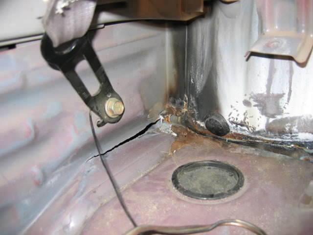

    Yea...I'm having a similar issue, but it isn't nearly as bad...yet.

    Going to need to weld and overlay plate on it , or if you don't have access to a welder use a bunch of bolts

    Yeah I may have to do both sides saying its like the seem is split all the way across
    I have a welder, it's just a pain trying to weld such thin material. I got a rivet gun the other day and feel like riveting a plate to it may be a good idea:notsure:

    That's how they hold airplanes together...go for it.

    Yes but planes still get cracks.... Aske me how I knw

    Rivits would be good!

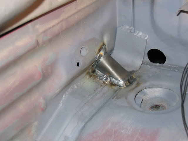

    IMG_0885_db8c65eb685450d32512b7d6c982ef3a4d83afe7.jpgIMG_0887_b989fd0f50178f9960c445d66e38d243ec5f51eb.jpgIMG_0896_542ff744e2f88a931a8a5be3c7ba85b2403ab287.jpg

    :laughing: first glance at this pic I was like, "yea, duct tape, that'll work!" lol.

    Who's truck is that?

    Trusso's :notsure:
    *derp....thought it was a truck DTF worked on till I clicked the link.

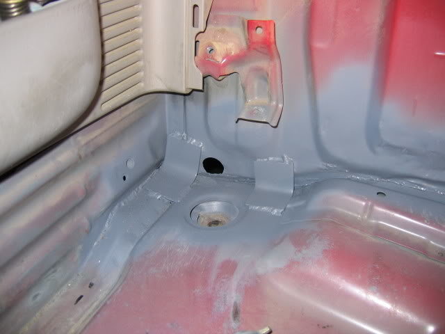

    Mine... well my buddy milton. Its the truck in my avatar. I think the only reason the cab stopped cracking was the cage.

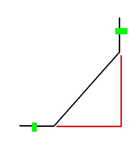

    If you want to try without a cage. Id say weld the seam, use long pieces of angle iron the length of the crack and spot weld it together (full welds are actually easier to fully crack out once they start on sheetmetal). And maybe even try getting thin sheetmetal, and gusseting over the sheetmetal and riveting it in.
    Seems like overkill, but if you beat on the taco like we were, then theres not much to stop it. Just build the sheetmetal in levels so the break has to go through more so its longer between repair jobs.
    Red is angle iron, black is thin sheetmetal, green is rivets
    I know, looks like something michelangelo would draw
