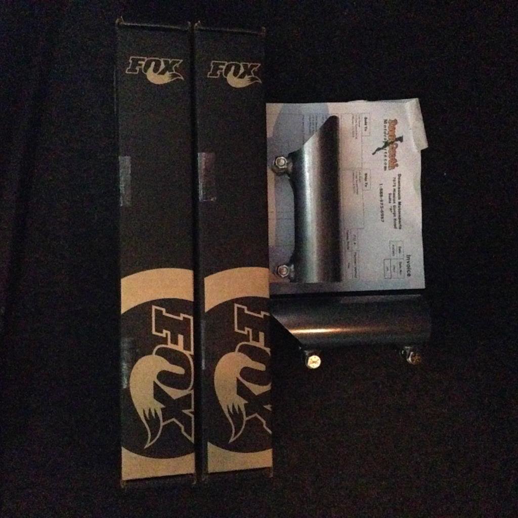

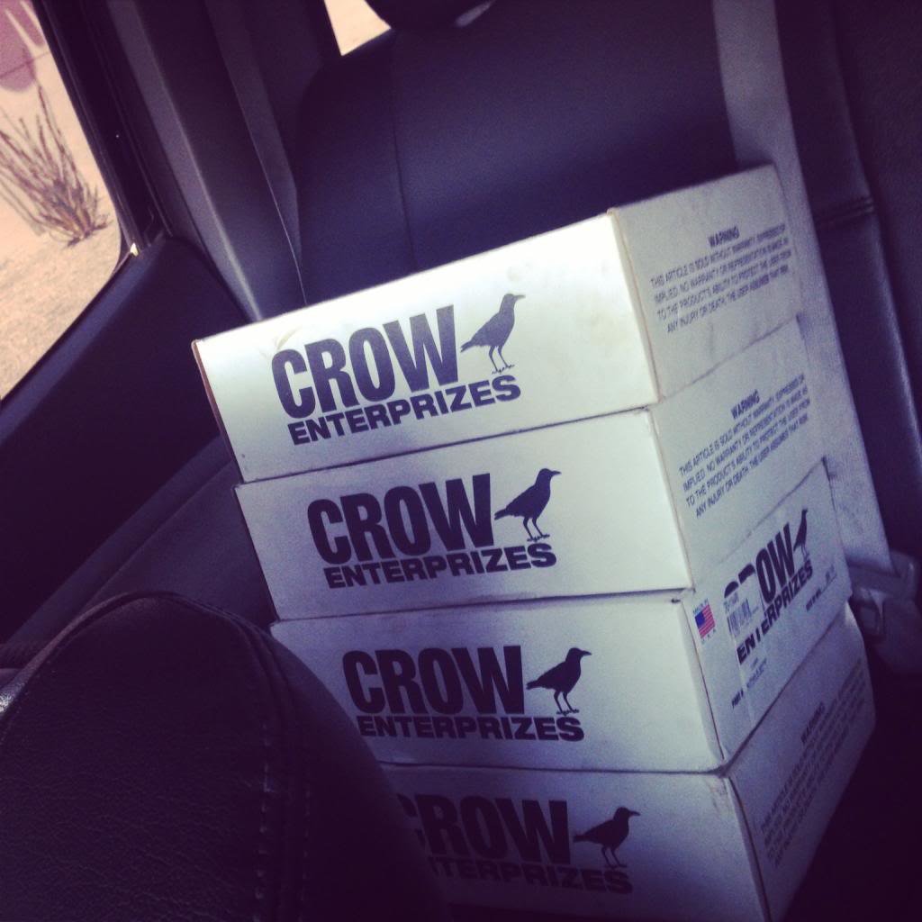

    bought some goodies today

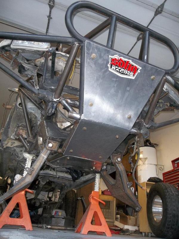

    Thanks, I plated all the way around the mounts, front and rear ones and tied the fronts together. Also tied the fronts to the rear and made skidplate mounts off them as well. I didn't actually plate the entire cross member though. I did fix the lowers and the alignment is done on the uppers. Pros and cons to this IMO but it's the direction I went...
    Not a finished shot and some things changed but you get the idea...

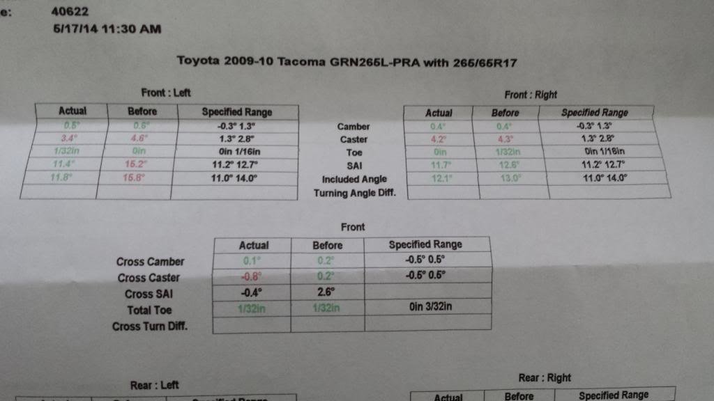

    I did a little digging through here about alignment of long travel, and just wanted to double check the specs of what my front end is at. We couldn't get the caster any better but it seems to ride alright. Will having the caster where it is at cause any problems on the trails?
