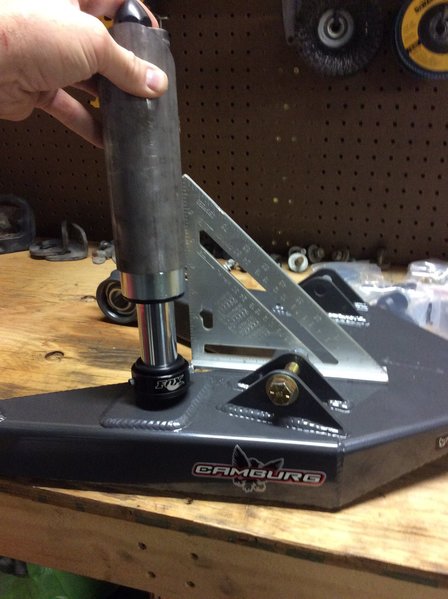

    This is my first technical question so here goes.
    I'm building a 01 DC 4x4. I have Camburg LT Kit.
    I'm mocking up the front end Fox 2.0 Bump Stops. My question is (thought process) should I mount the angle of the bump stop, so that if I measured the angle at full bump it would be at 90 degrees with the LCA strike plate? Am I missing something or over thinking this?
    In the picture the stop isn't fully compressed. I'm just using it as a reference for my question.image.jpg

    get the kit on the truck and cycle it out and then mount the bumps

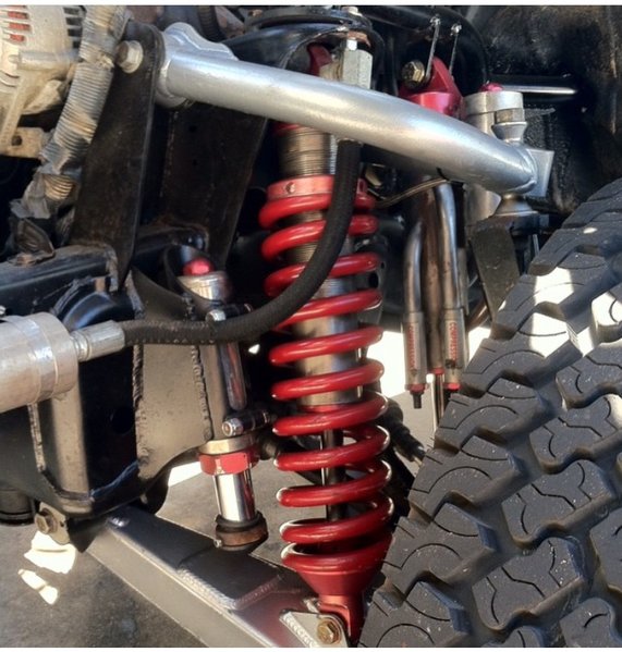

    Mine are at an angle...no issues, barely clears the coil over...at bump it's at 90 ...don't think it would work the way you are thinking about image.jpg

    this is what I'm wondering. Yours are mounted at an angle from the frame. Im curious if yours was cycled to full bump if the inside angle would measure 90 degrees. I think it would be the strongest at 90 degrees.

    Thanks man...at full bump the lca and the bump are 90. I would recommend doing it that way
