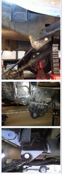

    Anyone running f67s with 12" shackle on a first gen? I need some measurements. I have a customers truck here that American Motorsports did some work on and I am suspicious that the shackles are mounted way too far forward.

  4. Mar 5, 2016 at 3:11 PM
    TRACperformance
    TRACperformance Well-Known Member
    Jan 8, 2014
    #120172
    139
    Should be 52.5" between the front pivot and the shackle pivot.

    I run mine at 52.5" too with a 12" shackle over frame.

    I've been told over and over again that 52.5 is really only for the precomas. I Just set it based on shackle angle at full droop. But if it did come from American Motorsports it is definitely wrong.

    well..seeing as to how pre tacos leafs are 3'' shorter than 98-04 tacomas..not sure they share the same measurements..now 95-97 tacos do have the same hangers and mounts as per tacomas. But 98-04s the fronts are 1'' further forward on the frame and the shackles are 2'' further back.

    I was concerned with the location of the front hanger. Not so much the shackle location. I'm stripping the pack tomorrow to bump it and finish the cage.

    It really depends on how you make that front hanger. As you can tell they are all slightly different. I measured the length of my leaf pack from axle to front eyelet with about 5 trial and error so the axle would bump in the stock location. I just used frame reference points to figure out the other side location so my truck doesn't drive sideways.
