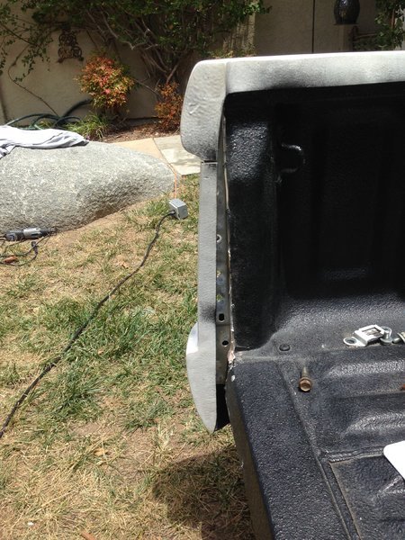

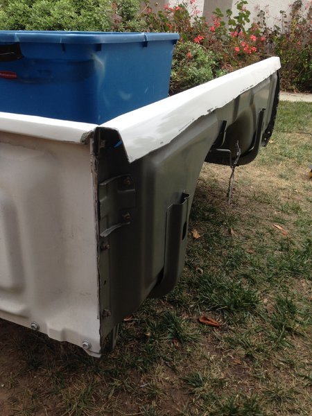

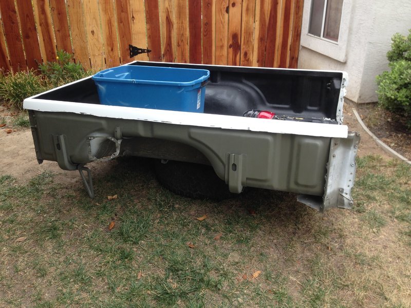

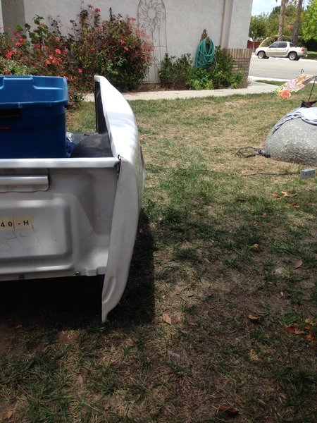

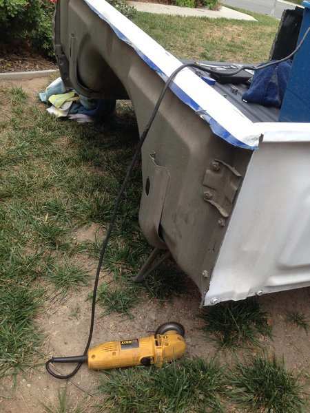

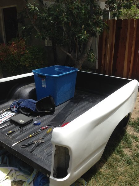

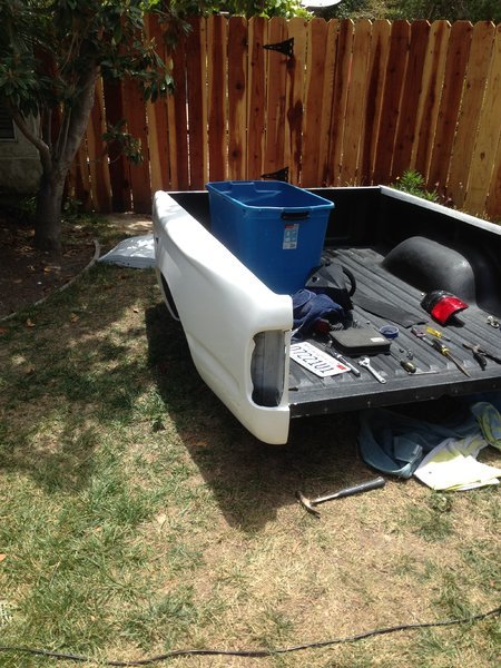

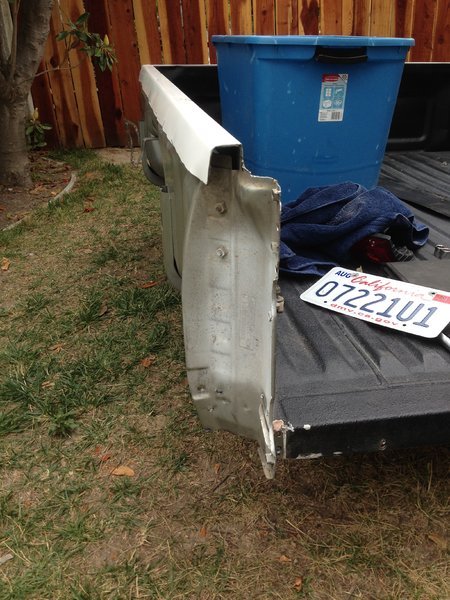

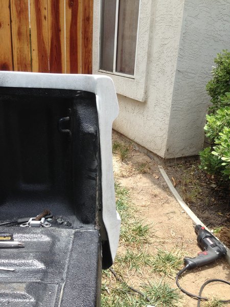

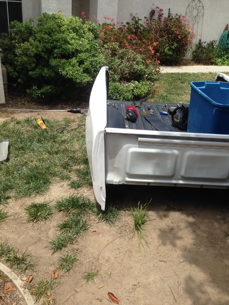

    IMG_1217.jpg IMG_1218.jpg IMG_1219.jpg IMG_1220.jpg IMG_1221.jpg IMG_1222.jpg IMG_1223.jpg IMG_1224.jpg IMG_1225.jpg IMG_1226.jpg IMG_1227.jpg Alright here is where im at for those interested... passenger side fits better than the drivers, still gotta trim and fit the tailgate and lights.

    i think glassworks are the best ones if you plan to keep the tailgate

    Make sure you prime and paint where you cut or rust will be there in about 20 minutes. Looks good

    I have fiberwerx 4.5 and I ended up drilling all my spotwelds and and removing all the excess metal. I couldn't get them to fit worth a crap until I removed the upper lip also. I will see if I have any pics. Might be some in my build. Mine fit well with the tailgate but I never run it.

    yea they are pretty snug with my frame rails like that but it seems like a good fit plus im gonna try and run my shell so i wanted that extra support. The tailgate ended up fitting pretty good the only thing was that it sat a little lower than the bedsides probably because i kept the old bedside lips:confused: The tail lights are fucked im gonna figure that out tomorrow

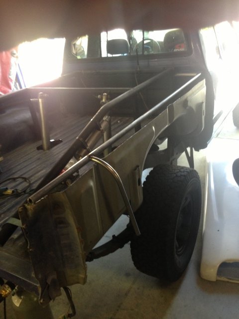

    If you want more support, you could always weld up a tube bed rail. Granted I have a bedcage to go off of but it should be doable with a little extra support.
    Kinda bad pic but this was the general idea, I added another side support up front. Solid support for the top and sides. (Sorry dont know why it wont upload rightside up)

    thats bad ass! I might have to try that. what size tubing did you use?

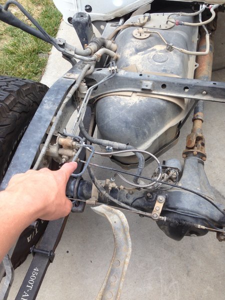

    while you guys are on the ebrake/rear axle topic what do i do with all the brake line shit when putting in my rear shocksIMG_1233.jpg (fox 16" travel 2.5)? Also does anybody have a solution for putting tail lights on the bedsides cause im stumped?
