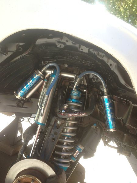

    Yeah that's a good catch, Kings use pipe thread so you can't just turn the fittings however you want too like a Fox. @FlapJack935 did you rebuild the CO with a different fitting ?

    Mine came with a 90* swivel fitting

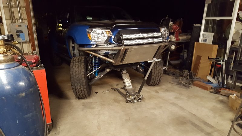

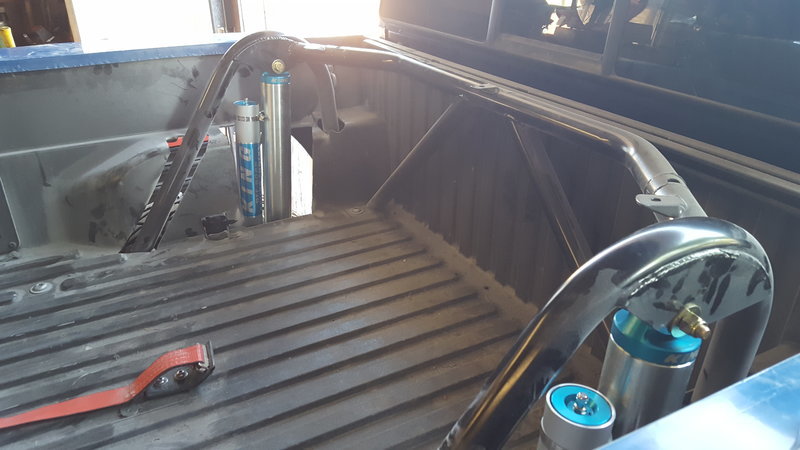

    Plan is to wrap up tonight. Bending up the bumper now, then im on the road. When I get home next week Ill have to play with the rear glass some more and little tweaks here and there, but all in all im super impressed with Jeffs work

    Oh that's cool, when I had a rubbing problem I had to buy all new fittings and hoses to be able to reroute mine because they were NPT.

    That's what I'm running and gives you proper thread engagement. Easier/ cheaper than doing longer studs

    Yeah I found the ones on wheelers that are open ended with much more thread engagement. Gonna order some and install when I get home next week

    I wish I had done remote resis too vice piggyback resis. Setup looks great.

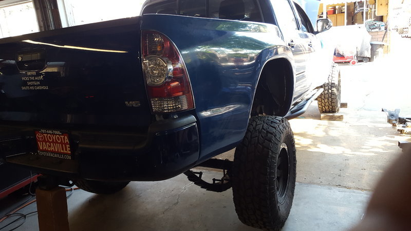

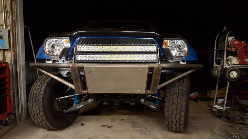

    Yeah but worth it! Fuckin hotel front desk lady was chilling in the back and didnt hear me calling the front desk for like 20 minutes, behind the locked front doors lol. Had a panic moment, thinking I was gonna have to sleep in the truck lol

    Looks awesome!!

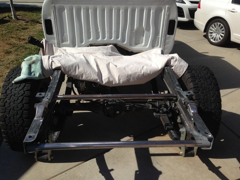

    J.Maynard
    J.Maynard Well-Known Member
    Feb 21, 2015
    #149276
    386
    Josh
    Oceanside
    2001 Tacoma Long Traveled Daily
    -K&N cold air Intake, Spintech catback exhaust with fender outlet, Total Chaos Front Long Travel with Fox 2.5 10" coilover, Bed cage with Fox 2.5 16" smoothies with dsc, TC shackles, fiberwerx bedsides, frame boxing,

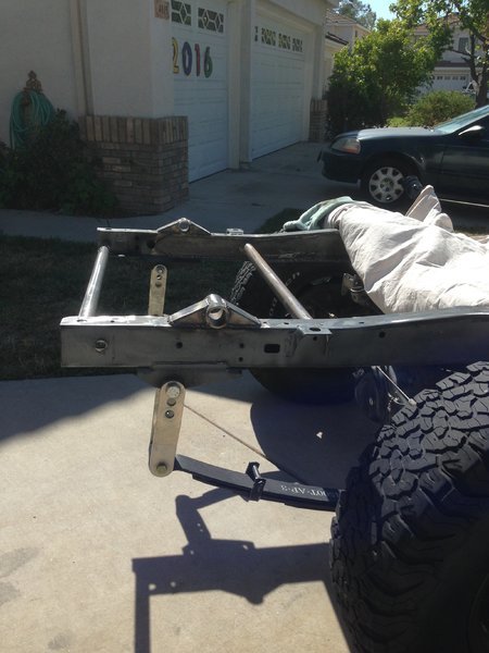

    IMG_1272.jpg IMG_1273.jpg Update: finished another tube across the middle and the TC shackles mounts. Not sure where exactly i needed to mount the shackles but i knew they needed to be pushed forward so at full droop it wont go past vertical. paint will be coming soon as well as actually installing the TC shackles with my leafs.
    P.S. welding on a hot day outside sucks!!
  18. Jun 4, 2016 at 6:10 PM
    jeffz0rz
    jeffz0rz Well-Known Member
    Dec 9, 2009
    #27296
    3,958
    san diego
    1996 tacoma 4cyl, 5spd
    The only problem with running tubes like that from side to side is frame rails have a tendency to twist or move up or down when the stock cross members are removed. I learned that years ago when I cut everything out of the back of my first gen. Those frame rails turned into wet noodles
  19. Jun 4, 2016 at 7:30 PM
    TC yota
    TC yota Well-Known Member
    Feb 4, 2010
    #30692
    2,127
    Tyler
    Escondido
    Ha
    is that your shackle angle at ride height?
