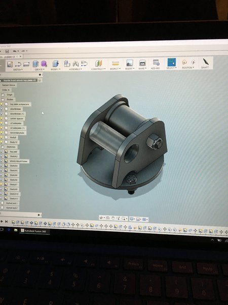

    Would anyone be interested in something like this.... was thinkin of makin a batch of em

    Dirt designs ran a group buy on a kit that looked identical to that. I think they sold quite a few sets. I have a set sitting on my work bench. You may want to add a hole to the center of the bottom plate for coilover clearance

    Ahh didn't realize they made a kit for this, the bottom plate has standoffs at the bolt hole locations to give clearance on top

    I saw the standoffs. Just wasn't sure if they would offer enough clearance. I'm sure they would have enough clearance on most trucks, but if you look at most secondary shock kits they tend to have way longer stand offs

    Ah yea I know what ya mean, the vertical plate should be plenty tall enough to make up for it, hate the look of those tall standoffs

    i think everyone with Icons that ordered the dirt designs ones resold them on here because the Icon top hat sticks up through that hole crazy far
