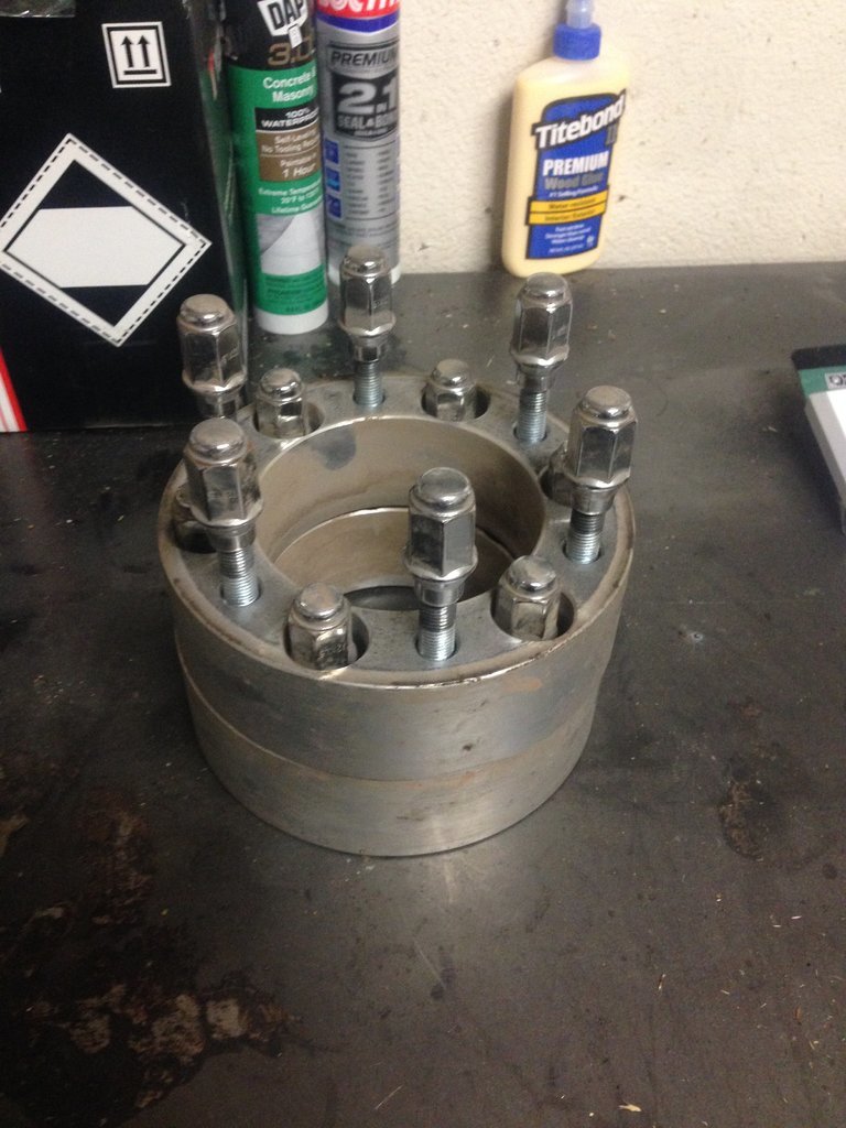

    So gentleman and everyone else. What wheel spacer do y'all recommend brand/ size. Rear only.
    Got Dmz Sua and 16" triples for rear. Was thinking 1.5" spacers. Any thoughts? Anyone have a set to get rid of?

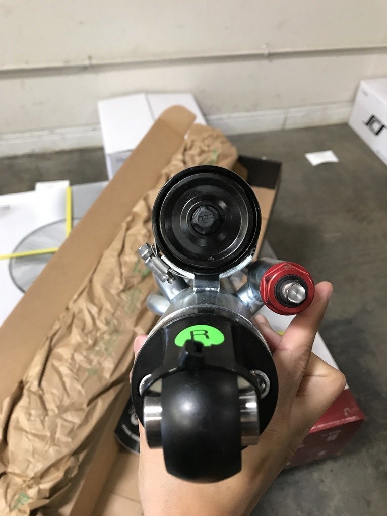

    How did you get the bypass tubes laid out?

    You mean orientation? I don't. I still have to fab up a bed cage. Sua should be here Monday. I have these. image.jpg

    When I wasn't talking to Tim at dmz about my setup that I just ordered, he said they usually use 1.25 or 1.5 spacers and depending on how it gets set up, and bypass layout, they either notch the frame a little or potentially have tire rub on bypasses under articulation. I've got a set of 2" spacers that I am running, and I also happen to have a set of 2" spacers I am trying to sell right now. $50 if you pick em up or $60 shipped. IMG_6447.jpgIMG_6448.jpg

    Take a picture of the actual shock. We're looking for where the bypass tubes are located in relationship to the top cap orientation.

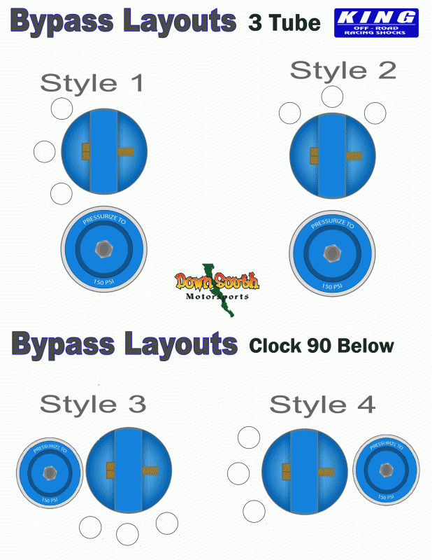

    Ummm I would definitely recommend hub centric spacers... and while you're at it replace the studs with arp. Most lugs on spacers are pretty soft.
    I think I might have some spidertrax 1.25 or 1.5 in the garage but the studs aren't in the best shape.
    Regardless of what brand you go with, get hubcentric

    Just to clarify. Hub centric do make it easier to put the wheels on. Other than that if you have acorn style lug nuts they are what really centers the wheel and once torqued down are the only thing holding the wheel to the hub / drum regardless of what kind of spacer. Hub-centric spacers are convenient to hang the wheel on something while you torque the lug nuts. Other than that there is no advantage. Still I'm trying to make some hub centric spacers fit my manual hubs for convenience sake. :oops:

    That's the correct layout. Depending on how far off the frame your bed cage puts the shocks you should be able to get away with a 1.25"-1.5" spacer. If it was my personal truck I'd notch the frame i case I ever decided to go 3.0's but with a premanufactured bed cage it may not be worth it. It all depends on how tight to the frame the shocks are mounted

    Fox top mounts are clockable also fyi. Just loosen the allens and clock it how you need. Fox ftw! #foxlivesmatter

    That is a nice feature since they only give one option for tube layout. Really could help you dial things in so they don't rub
