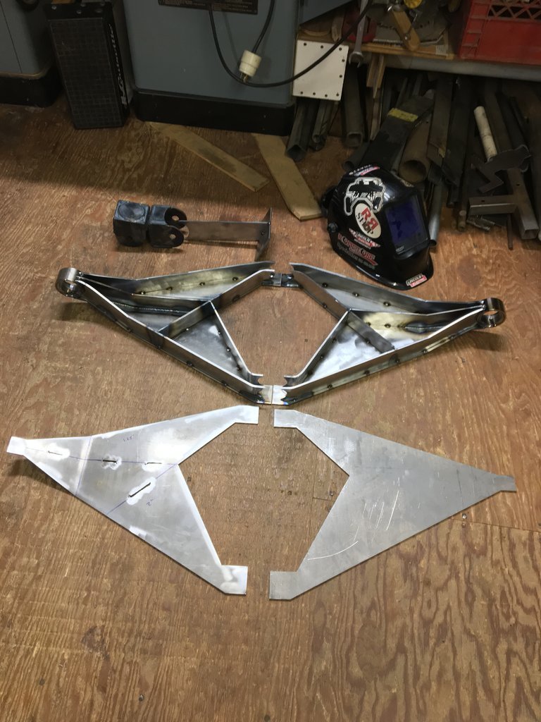

    Just curious, but how are you keeping that from warping without a jig?

    well I had a full length tube tacked in there for the frame pivots when I put it together. and tacked it to a 1/2" plate. tacked the living daylights out of everything....and welding in sequences to distribute the heat, I checked em on a surface plate granite piece....theyre like within a 1/16" of each other...close enough lol. I have a jigfor the frame pivot spacing for when I put the bushings in and final weld it all too. and really if you draw it on the computer with some interlocking bits and don't weld it like a retard it aint gunna move enough to matter
