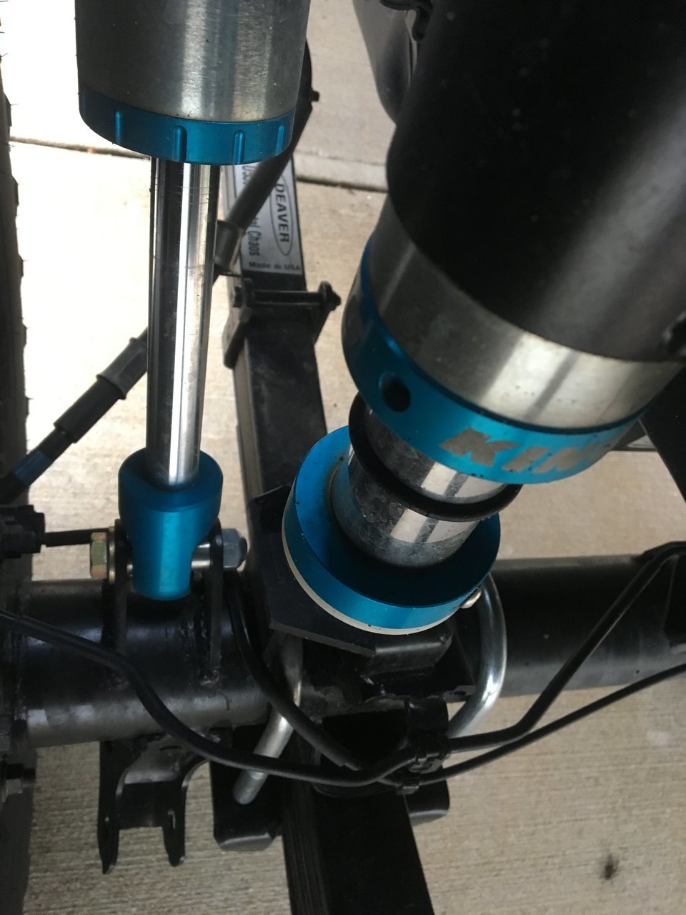

    Edit: @Caboose117 you are going to want to keep the rear end narrower than the front by at least about an inch to let the truck track where you want it to when going fast off road. Whether that helps your shock rubbing is another issue to your track width question.

    ;IGY6 Rescue Truck
    smashed this, broke that, covered it up with tape and paint

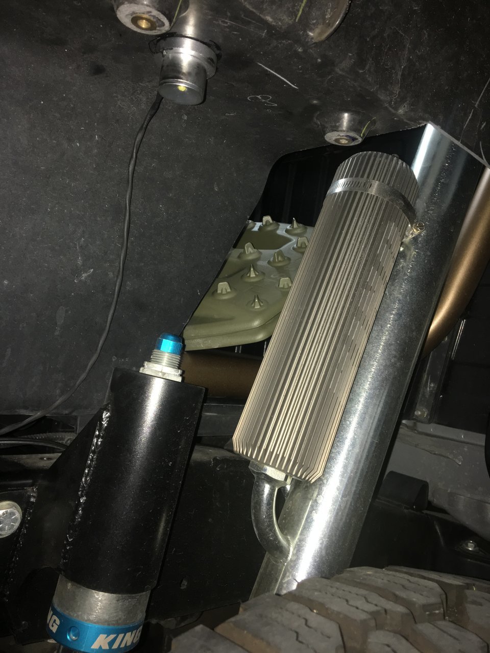

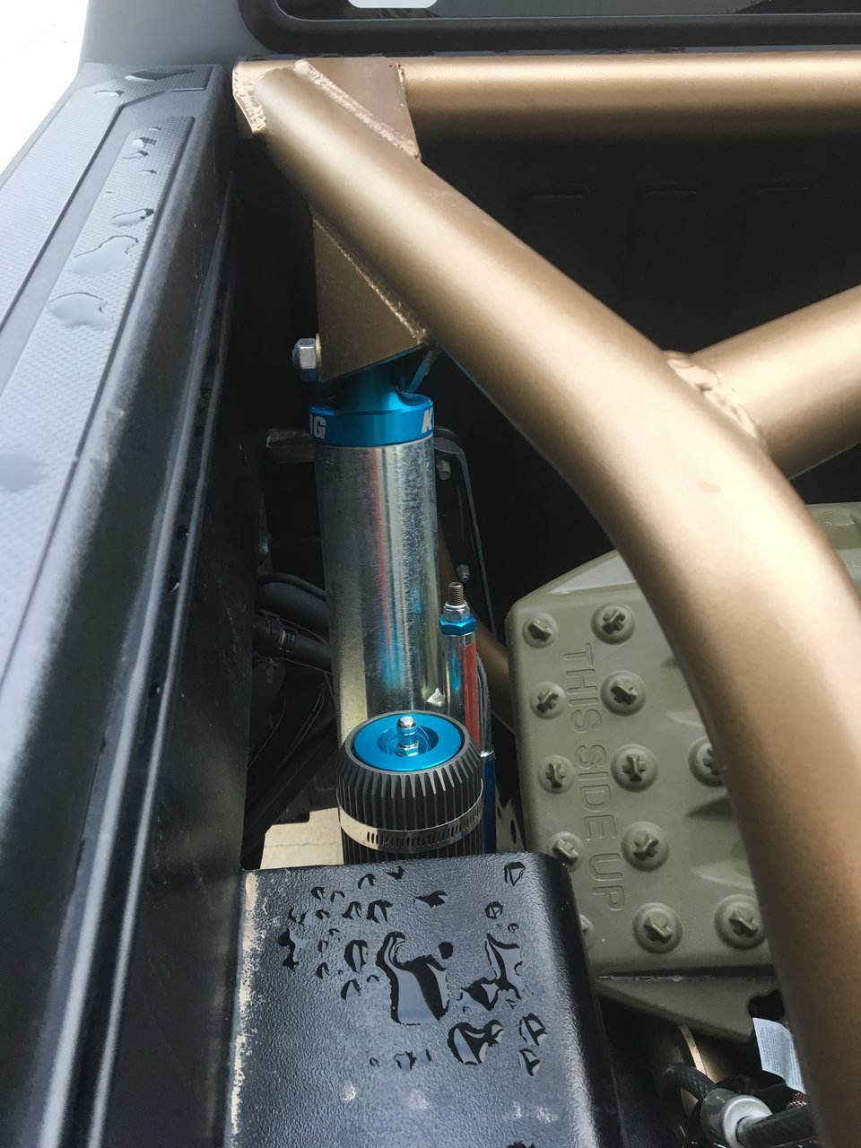

    Well not to make you do more work, but it looks like you are sacrificing both upteavek and shock clearance. Whomever did your install did not remove the old stock shock mounts, nor did they remove the stock bump strike pads. I know I modified my strike pads for the hydro bumps, but your fabricator lost you like 2" of uptravel. IMG_1351.jpg
    Your shocks should be positioned a few inches further inward and lower with strike pads an inch or so lower than yours.
    Hawk373, tetten and Tbasch like this.

    The stock strike pad is where my bumps are hitting, I did notice the stock shock mounts were still there but is it really affecting anything?
    Pardon me, I'm a bit slow

    Your set up does not look like it would have anymore up travel than his.

    No it doesn’t matter. You can position the shock tabs wherever you want, so long as it cycled clean and for max bump and droop travel

    At this current juncture my up travel is limited by hitting the truck itself lol
    As for droop I am def limited by my shackles but I have the new hangers and shackles from @archivegarage on order

    Whether my uptravel is more or less than yours, your shocks are at least an inch mounted further outboard than mine plus the fact they are mounted on top of the axle. Mine are as low as they can go and inward as they can go before hitting the frame and hiring the leafs on the downward side of things

    The SUA kit is all TC but if I remember the numbers correctly I'm only getting around 11-12" of travel

    What I meant is my up travel stops at the point right before the rear end would smack the frame. And my droop is limited by the hangers/shackles
    Even without shocks attached it will currently only droop so far :p
    But I do get what you mean about how far in or out the shocks are mounted.
    I think he was just trying to avoid notching my frame on "my new truck"
    One of those situations where someone is willing to do the work and take your money but hates to see a truck with 15k on the odo completely chopped up haha.

    Sorry to keep asking questions, but I want to get as much info before telling hopefully not telling you to start over, but what length shocks are you running? If they are less than 16" then you need to sell them for some 16's and relocate your lower shock mounts. Otherwise I would still advise relocating your lower shock mounts to allow for more clearance and better utilize the full travel of the shocks.

    Plus looks like your bumps are striking about an inch sooner than the stock strike pads with this addition to them. IMG_1517.jpg

    Cans could be welded higher to compensate

    Just want to clarify in that picture the bumps aren't touching anything yet
    Just the angle of the picture.
    The shocks are 2.5x16
    It's all good info man! I do appreciate it
    Not to worried about relocating the tabs since I'm going with a full fabbed Currie rear end here shortly, but is def good info for when I get that one set up.
    Can I get a few pics of how your lower tabs are located and your bump strike plate?
