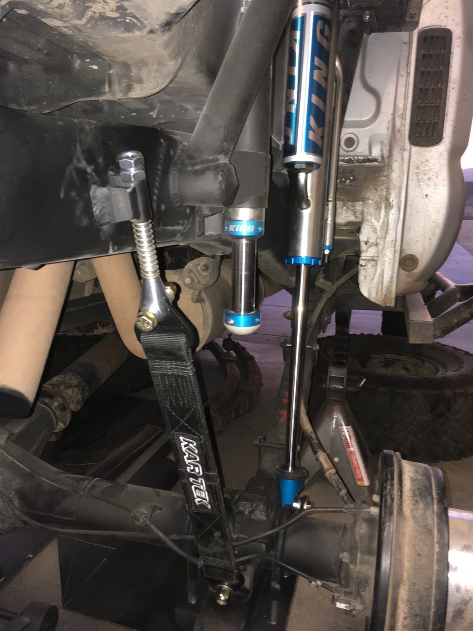

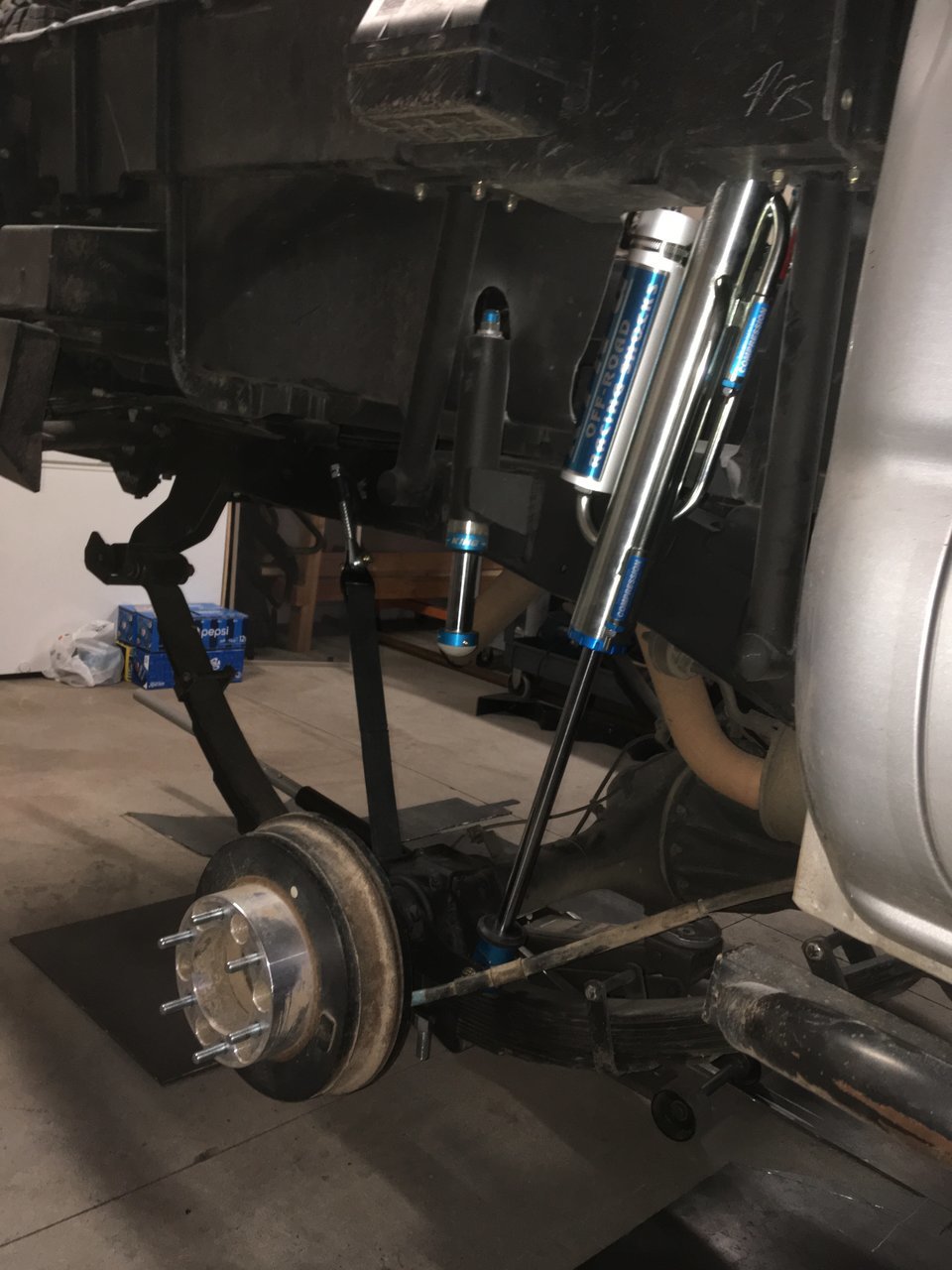

    shorten your bumpstop....a lot
    you too!! shorten that bumpstop..... control the bump zone with the bypass and only use the airbump for the big hits(like airborne and the oops kind of bumps)

    if you have 16's, and from the looks of your bedcage(level with the top of the bed) with the shock mounted ontop like that I would be skeptical that its setup correctly. looks like your shock bottoms out too early. axle mount should be a bit lower

    I think he has 14s. No way you could go on top and have the shocks that height in the bed

    Are you sure it was cycled?

    yea I wouldn't go out and "test" it out like that.....damage those pretty new shocks of yours

    Yep
    At current set up
    I get 11-12" of travel
    Which obviously means I still have unused shock length
    But my limiting factor here on travel isn't my shocks it's the SUA set up.
    The designed intent was to put shocks in that matched anything I would ever do to that truck short of trailing arms, which I won't be doing any time soon.
    The shocks and bed cage can grow with the truck as I upgrade other things in the rear suspension such as new hangers and shackles or cutting my frame.

    at ride height how much shock shaft is showing? and how much up travel do you have to full bump?

    I’d like to see a pic of it at full bump showing the shock shaft

    I will check tomorrow for you with a measuring tape and pictures :)

    The only way to do that (as my tiny brain is aware) is to purge the pressure out of my shocks and bump and I currently do not have a way to recharge them.
    If you can teach me a simpler way I will take pictures tomorrow
