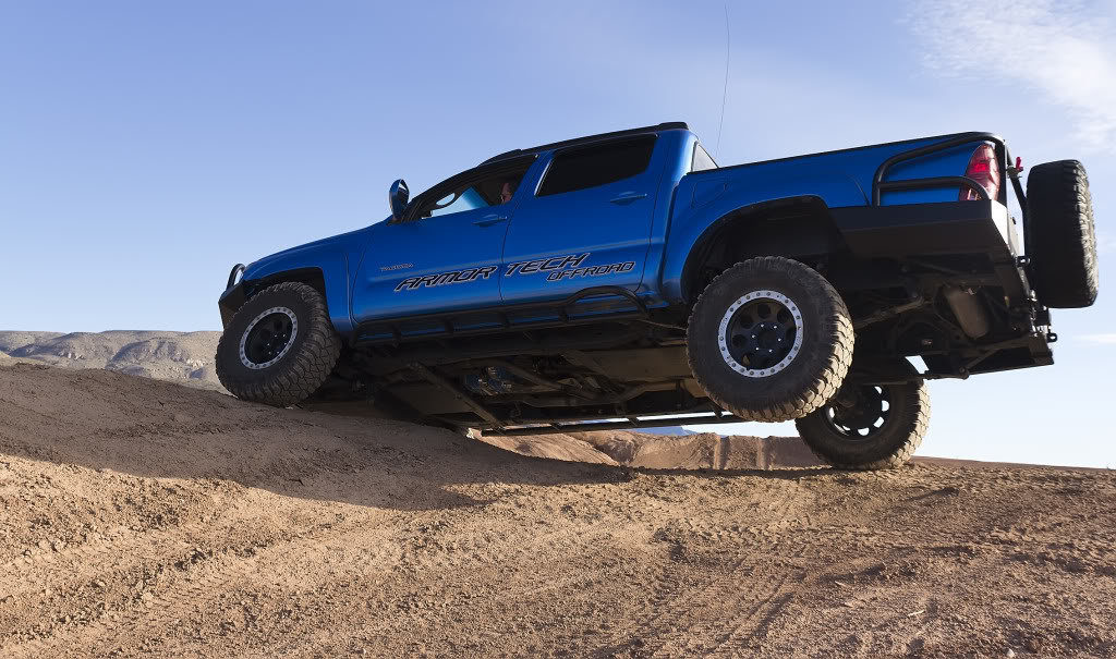

    Kevin's (ATO) bad ass rig he built
    Everything Kevin from ATO did on his... and then some. LOL
    Ok guys, I have a stupid Newb question for you long travel guys. I just bought Kevin's from ATO truck, and I love it, and its awesome, but I'm used to quite of rear travel and was wondering what I could to do to improve rear articulation? He has made a awesome set of shackle flips on it and some 5100s on the back, but I want more! LOL
    Here what it looks like now...

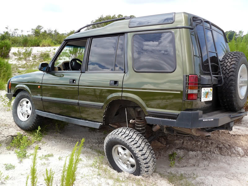

    and I'm thinking something like this... This was done with no shocks in it. Picture004_9ded0cb8c7b557af3b7fce4d175dcb1add25ab4d.jpg

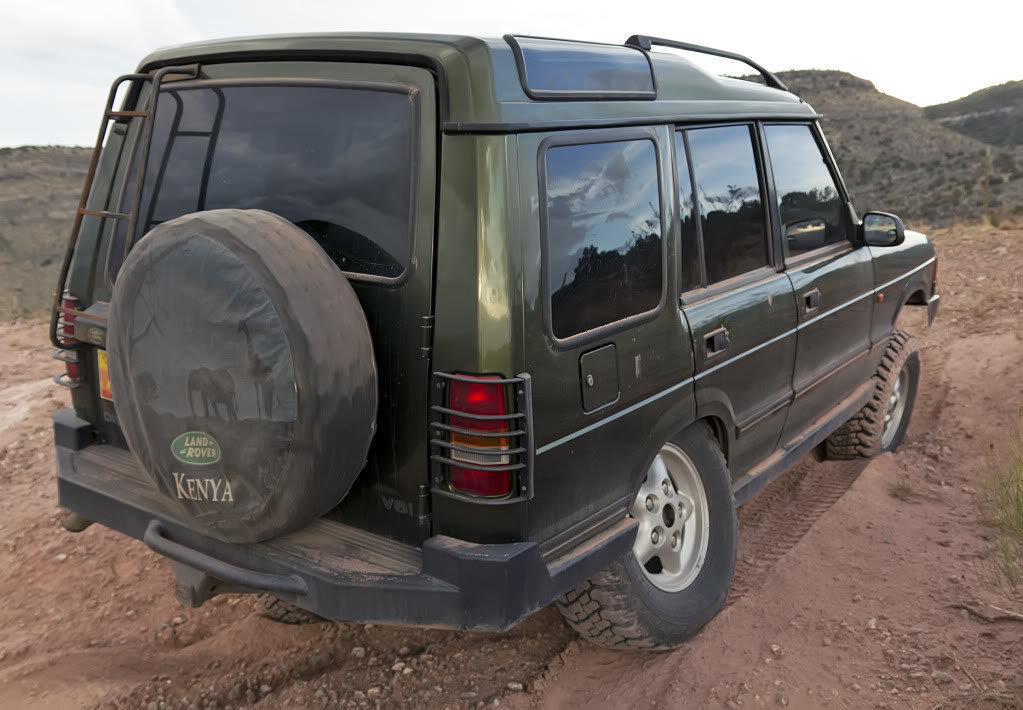

    This is what I'm used to
    any ideas? I wont be jumping it or anything, more for crawling so if I'm in the wrong area, feel free to slap me. LOL

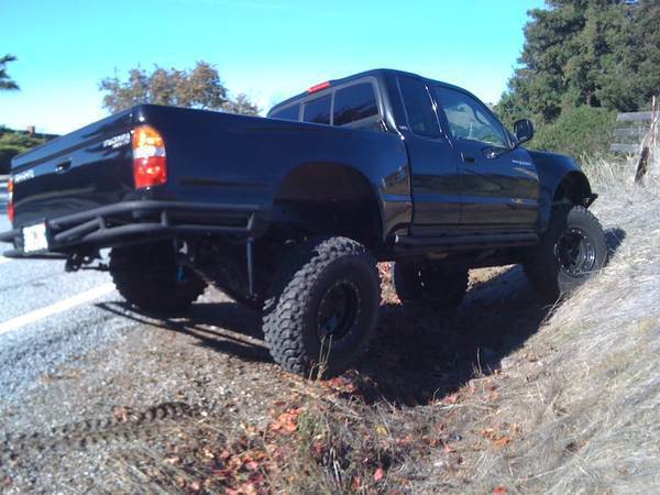

    like this? :notsure:

    Triangulate the shocks

    Tacokid, Yes, just like that! What have you done?
    cummins dude say what? LOL Is that what you did tacokid? if so wtf does that mean and look like? I salesman, not a mech. (hence the reason I bought kevin's BA rig. LOL )
    And yes nofords08. Its only been on sale for a yr or so... twice! LOL
  8. Oct 8, 2011 at 10:34 PM
    #6928
    rcfreak201
    rcfreak201 Well-Known Member
    Jul 24, 2010
    #40660
    6,064
    if you like what tacokid posted then your looking at a SUA(Spring Under Axel) kit. long travel for the rear :)

    If you're going more for low speed I wouldn't waste your money on a bed cage and long shocks. Just look into triangulating the rear shocks and run some 5100's

    triangulating your shocks will not do you good going high spped. not at all

    triangulating your rear shocks wont help you flex it out on the trail and its even worse for high speed stuff. where do you guys get this crap from?

    Triangulating your shocks allows you to run longer shocks without punching a hole in the bed in turns allowing more droop then the stock shock location. It helps a lot with 2nd Gens seeing how the stock shock location limits the rear spring travel. And yes Triangulation of shocks for high speed sucks because you reduce the shock damping. Ideally you want the shocks at 90* or close to but if you want droop and don't want to cut holes in your bed and run a bed cage triangulating your shocks will allow more droop.

    Giant motorsports SUA (spring under axle) Long Travel kit with 16" Kings that come through the bed. Yes...it flexes. If low and slow is your game, then LT is overkill. A better spring pack (deaver or AP) and a midtravel/extended creative shock placement would probably serve you well and be significatly easier on the wallet. Something like this: http://solomotorsports.com/index.php/prod/prodtoy/27-toyota-tacoma-20-rear-shock-hoop-249
