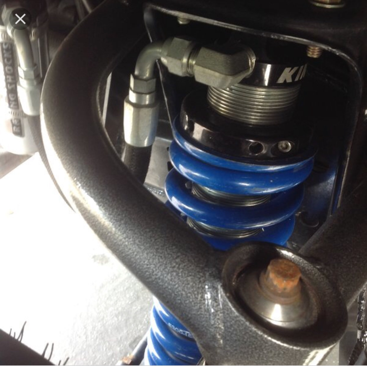

    This is what I have....would likely work for you

    what kind of paint did you used on your uca

    Not my picture unfortunately
    Not cool enough for lt this time :anonymous:

    thats powdercoated

    I might be able to make something like that work - I guess it will come down to how the uca cycles - they have it pointing straight up around 1 o'clock and between that and a long hose there could be an easy way to make it work.

    Rustoleum Hammertones looks a lot like clear coated powdercoat from a distance- I painted my valve covers and transmission with that stuff. Durable paint!

    That's mine, I was just looking for the same pic to post :) It is "silver vein " powdercoat
    edit - it is silver vein powder coat with clear powder too

    I had a feeling that was yours lol! Idk anyone else with that powdercoat.

    where did you find that photo ? It looks like someone took it while I was parked somewhere ?
    The fittings and hoses all from Crown Performance BTW, I have the adjustable resi's so I had to use a 90 at the resi. Jeff and I had to cut up my King resi mounts and mod them to fit around the Solo double shear gussets. I've had a few people question that bit too...

    haha...looks like I am my own stalker lol. I know I've posted a shot like that a few times whenever someone mentions the older King hose rub problem, I rubbed through my hoses down to the inner braid after my very first trip and stole that fitting set up idea from FOX...went to Crown and they set me up with those new hose and fittings while I waited.

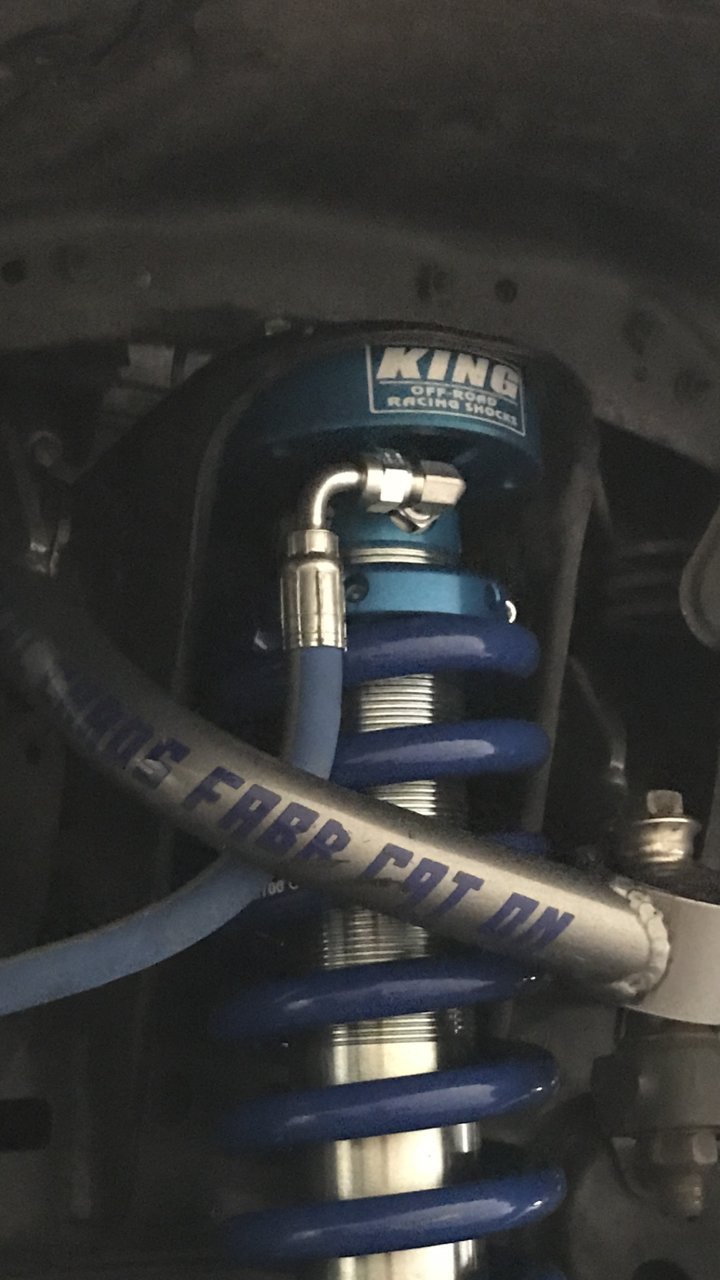

    Pretty much exactly how my oe Kings are
    My buddy ordered 2.5x8 kings and it came with this same fitting setup vvv04A79AA5-086C-495C-A7D5-9AA0F3C75D79.jpg

    about time they changed that, everyone rubbed through the hoses on the old set up
