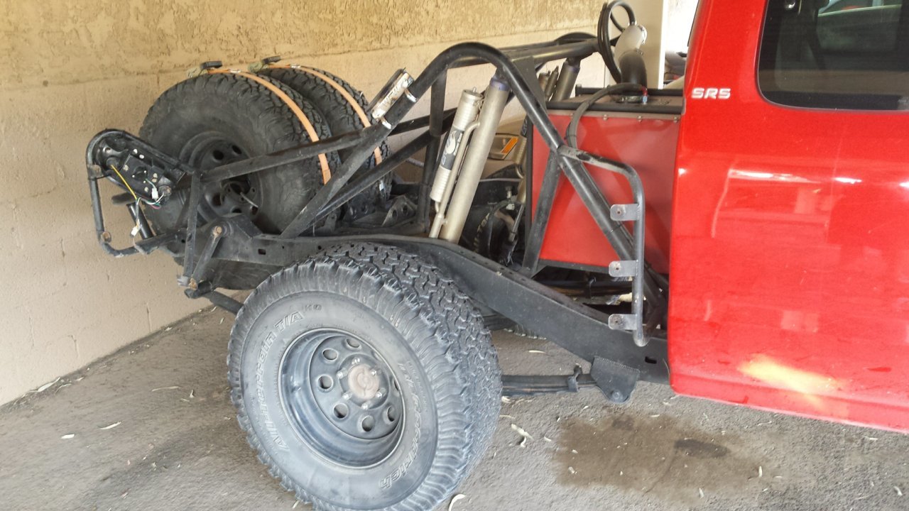

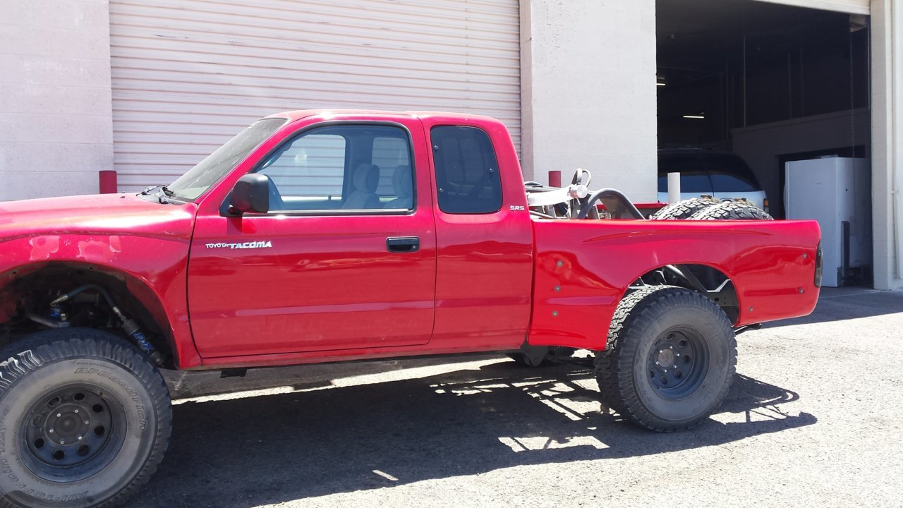

    Im running j55 springs and a 9" total chaos shackle and it sits really low (2 full size spares, fuel cell in front of axle)...in order to swap to a j67 or similar spring you would need to move to a 12" shackle and relocate the shackle right? I'm wondering if it's worth just reorganizing the rear to only have a single spare...would that make a difference?

    I thought j55 and 9" typically went through the frame for the mounts, yours look like they are sitting on top which will lower the ride height. What is the spacing from front to rear mount? You might be able to swap shackles without relocating the mount, 12" usually sits on top of the frame the way yours is
