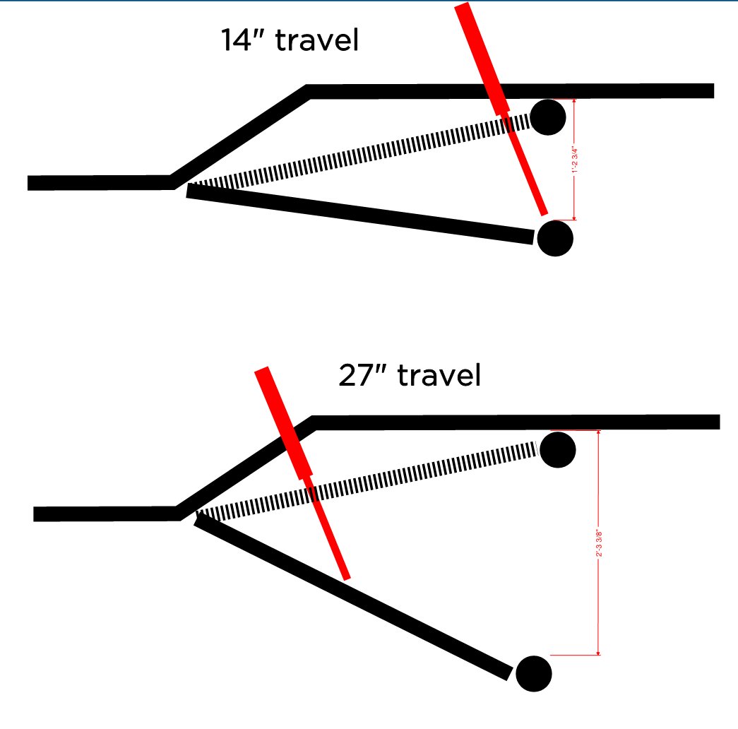

    Yes sir, you are correct the leverage ratio is different in every possible scenario where any of the dimensions are changed but the primary factors are the length of the link and the distance from the front of the link to the CO.

    I'm not annoyed, it's just that the question has been posed so many times that I truly wonder if the basic geometry / math is understood so I wanted to throw together that diagram to help explain it in very basic terms w/ somewhat of an extreme example.

    Before any of the suspension design savy crowd get off work today and chime in about this - please understand that the CO angles I sketched are bad, you want your CO to " hang" as close to 90 as possible when at full droop. Again, my sketch is just diagrammatic to show the basic principles.

    I have asked about short course vs traditional for my truck.
    I was legit asking about the short course trucks not a prerunner or rock bouncer
    Like
    The actual short course trucks.
    I asked cause dem bishes huck through that course and it seem’d ample for that application but I wondered why it was designed that way if it’s so inefficient
    Yes that was helpful, no I didn’t/don’t quite understand the math.

    Short course trucks and thier setups are run really stiff, the courses are relatively smooth other than the jumps...
    The rules in those racing classes limit the allowed suspension travel as well.
    With a almost 1:1 motion ratio you dont really have to stack the valving as much as you do with a traditional trailing arm linked setup.
    As far as packaging goes a short course linked truck will have the coilover sticking out above the bed by alot and is gunna look goofy(in my opinion) where normal links they run nice tucked against the cab and about flush with the bed line...aesthetically cleaner looking.
    Advantage of short course is the links are stupid sinple... just tubes and depending on how u set your anti squat up you have better ground clearance by a couple inches. Whereas traditional canoe style links hand down some. But sliding em on Rick's really isn't an issue when u build em with enough beef..they act like rock sliders...soooo the advantage is really pretty minimal.
    If you want to keep bed space I'd suggest a 3 link setup with the panhard bar like the one dirt designs does... if bedspace or a bed isnt a factor either do a triangulated 4 link or 3 link wishbone like I did.
    Now if u want to get into 4 link vs 3 wishbone... you are able to get a better triangulation on the axle since the frame rails are really only so wide (44"). And the wishbone trucks seem to have a lil better anti roll characteristics inherently built into the design.
