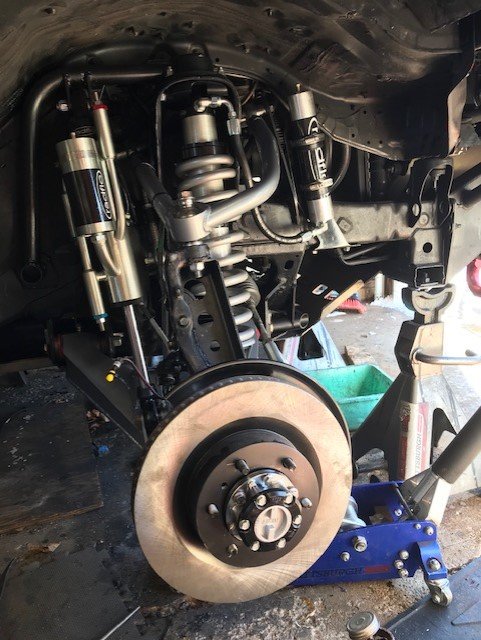

    JD Fab +4 kit final assembly under way

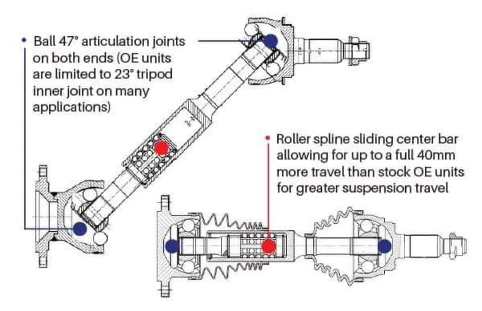

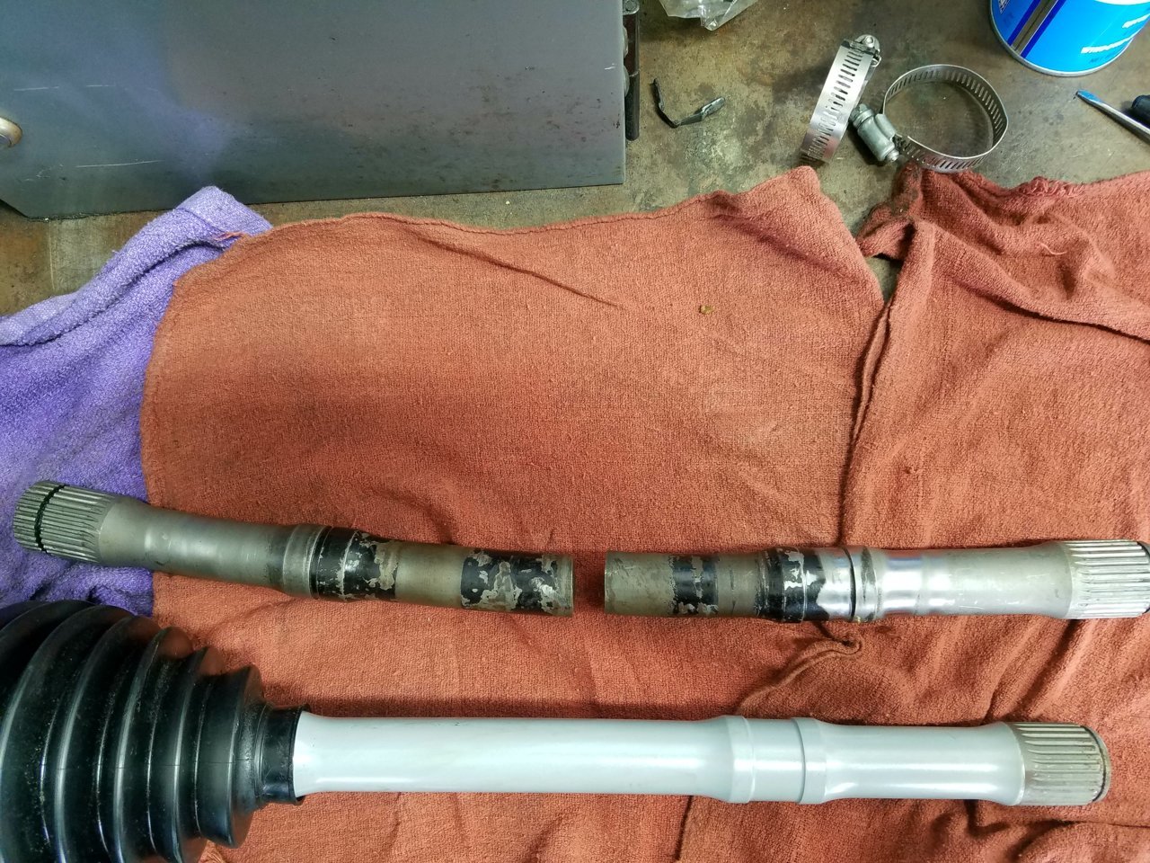

    I'd take my Currie extended shafts over a 300 shaft all day long. You'd want a fuse somewhere within the driveline

    yup my black king bumps are 4+ months out too so they custom fab’d a temp bump stop for me that fits into the King can

    See resi tabs for a bypass :spy:

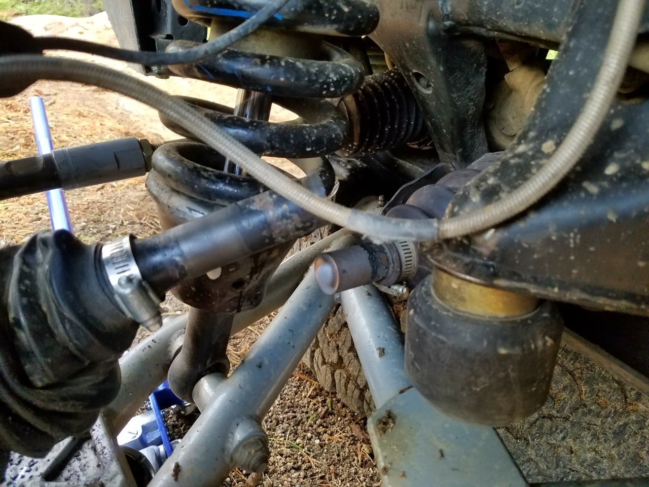

    yes, i already have black king free bleed bypasses they just were not installed yet in that pic but we are running a 2” air bump too51681494-1D2F-49C2-80AC-9B05440B38E4.jpg
    Here’s a side view of the bypass hoops

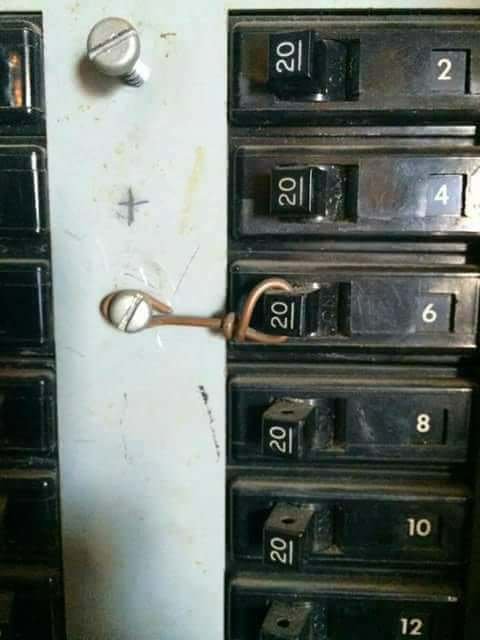

    I fix my fuses/ breakers permanently lol.

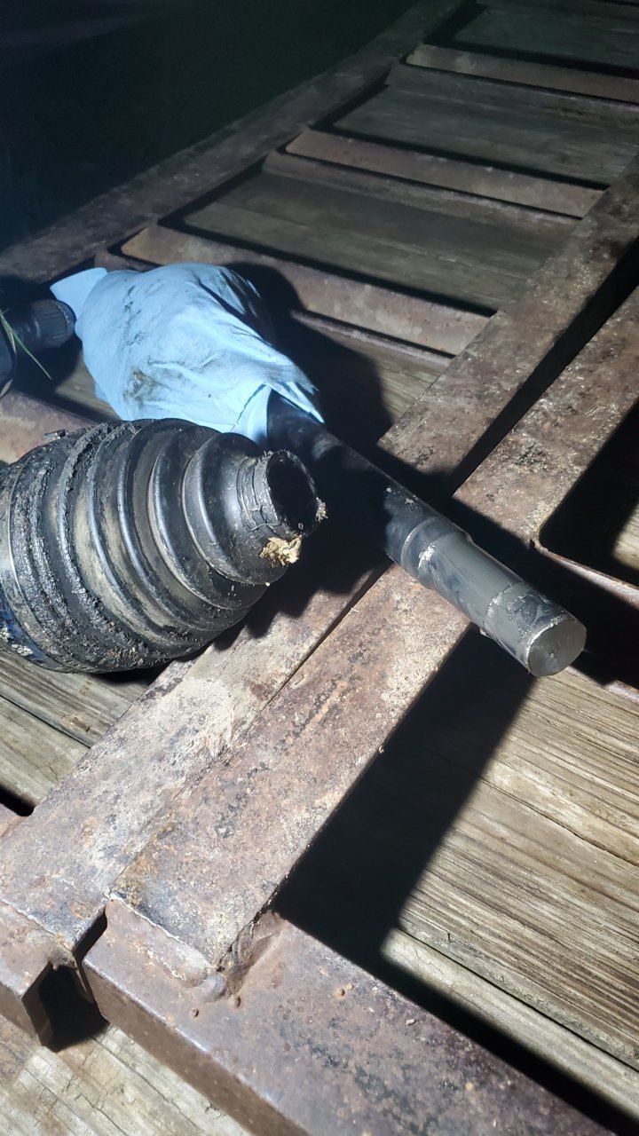

    But yeah when I jump to 5.29’s I’ll be cryo treating and rem polishing my gears. A cv problem is annoying but a relatively easy fix on the trail. I’m just gonna shoot for no problems. If i do have issues I’ll just center mount a 9” diff and go full ultra 4
