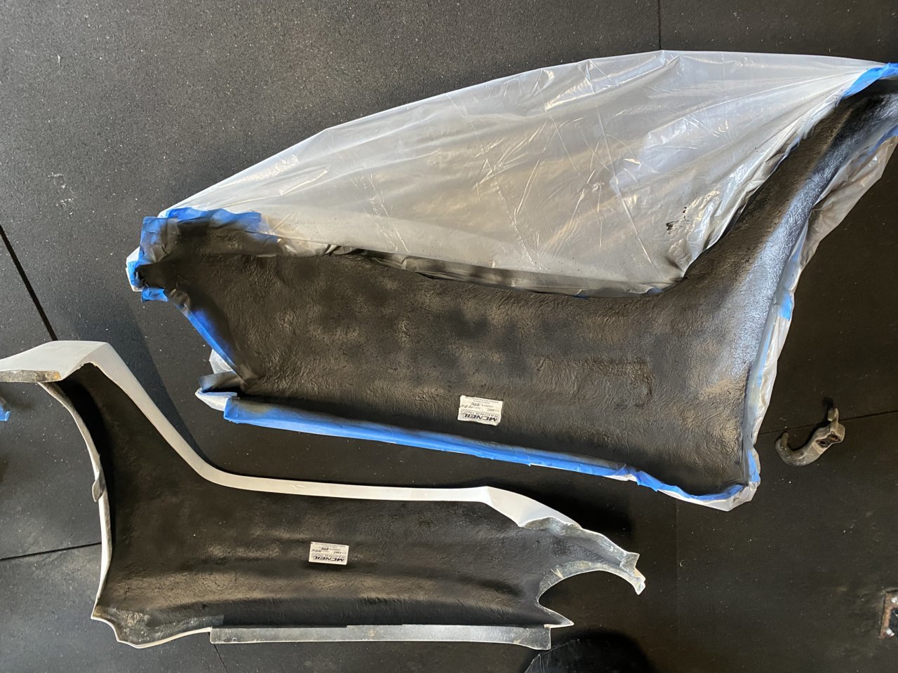

    4D51F49E-E51B-4430-8B21-91A698948FA3.jpg I am about to install these McNeil +2 fenders. You guys got any suggestions or tips?
    Put some undercoating on the back sides.
    I hear you may have to trim/shave around the bottom edge of the door. What tools do you use to shave off some material?

    A good rasp or file works wonders, i had to trim the section that overlaps the cowl panel at top edge of fender. Other than that the mcneil front fenders fit really well.

    Definitely mock up everything - close the hood, put the headlight in on that side, even the grill. I made The mistake of not closing the hood and somehow left an extra wide gap. Between the two at the top go the fenders.
