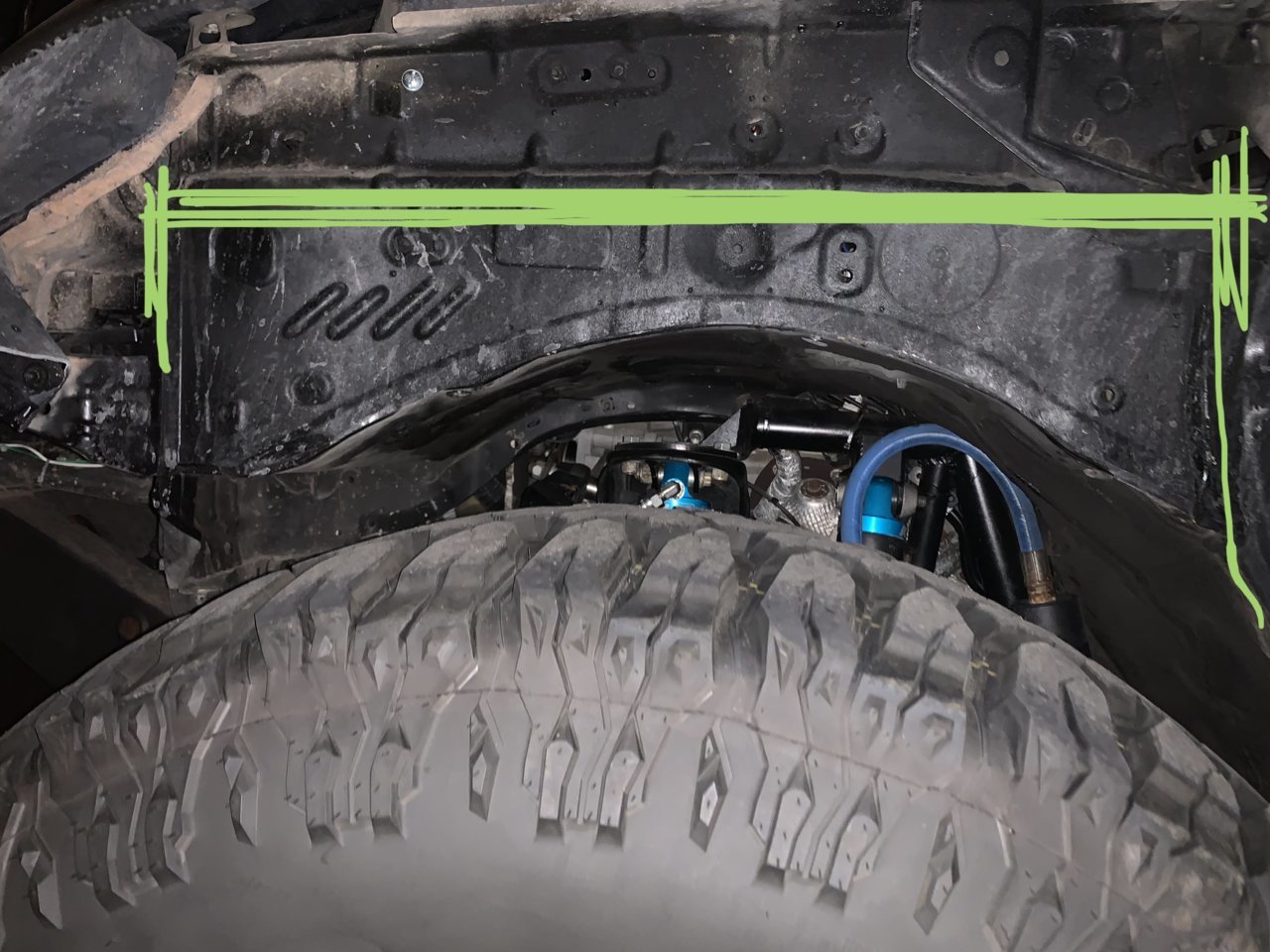

    So tell my why this is a bad idea or what I am missing.
    I’m going to finally start tubbing my truck next week. Obviously I need tire clearance but I think I can get another inch or so of uptravel if I clearance for my upper control arm.
    After looking at a few engine bay pics and seeing the jd fab inner fenders, it got me thinking. Why not just hack the entire wheel well out and replace it with tube?
    I’m moving my battery, switch pro, and compressor to the bed. That only leaves me with the fuse box, ps reservoir, washer reservoir, and misc wiring/ac lines.
    For the pieces staying I can just add some tabs to bolt them to the tubes. Then just add some rubber fender liner stuff for dust. I live in CA so I don’t need to worry about salt or anything like that.
    I’m debating putting it where this green line is. Then cut the firewall where needed as well of course.
    In addition to the front and rear being bolted or welded, I’d run some bolts into the tube where it meets what’s left of the inner fender.
    This seems a lot easier than cutting and welding in panels. Especially since I have a bunch to remove. There is probably something I am forgetting.

    The thing to keep in mind is that you will still probably need to tub the inner firewall with cab. So you’re not going to totally avoid the hard work.
    erok81[QUOTED] likes this.

    I used 1x1 square tube.

    Oh yeah I’m dreading the firewall. That’s why I want to take the “easy” way out with the rest of it.
    Nice. That would probably work better than round stock. Especially if I want to tuck it up against what’s left - not quite as extreme as what you did. Although I might as well do it like you did since I am hacking it off anyway.
    You happy with the end result?

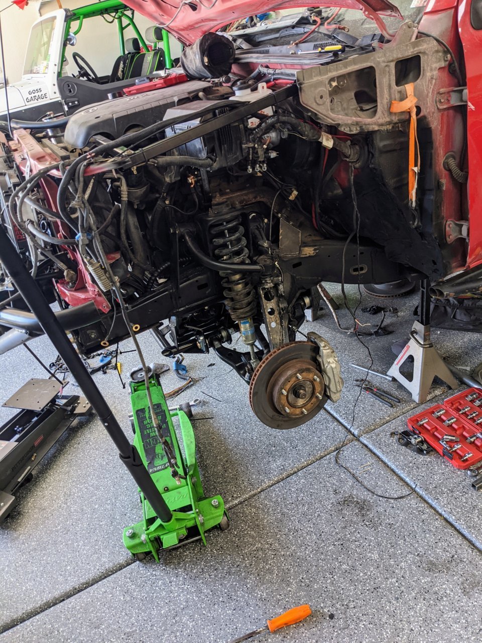

    I added custom fender wells....which i'm now gonna cut out because i didn't go high enough...oh well they looked cool while they lasted.

    Yeah im happy with it. Its easier to work on the truck without all the sheetmetal. If i added any panels i would make them removable.
    I made a fuse box mount off the top of my strut tower. Made a crossbar to mount my PS resevoir and wires. And ill eventually be doing a cowl intake mod. I dont run windshield washer fluid.
