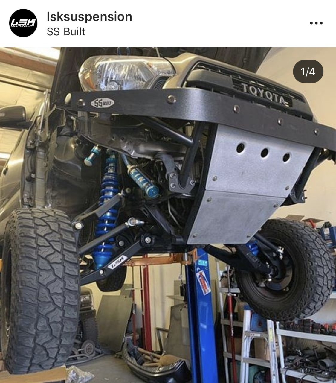

    LSK posted up a few pics on their Instagram a few days ago.

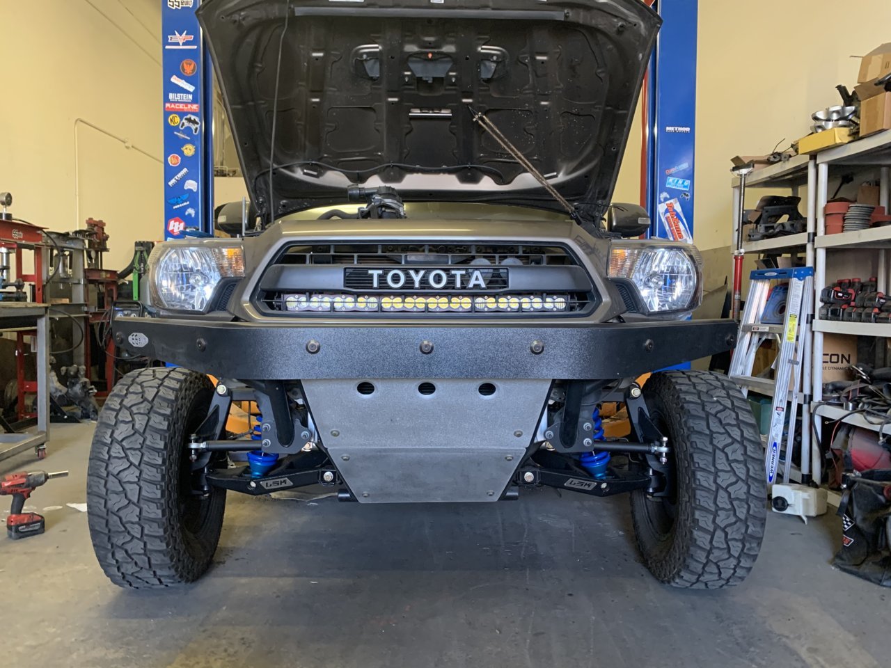

    Still have a few more things to do. But overall really happy with how it’s turning out.

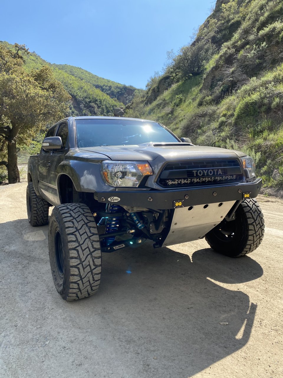

    6826F1AC-14CD-49DE-8B03-5825CEBA3409.jpg 17C8E143-A14C-4A94-A15F-B7A4F9439733.jpg 6A495E03-F9E0-4009-8E7D-DDC2AA253567.jpg 6B306D9A-AB5C-40E8-A766-548A60416220.jpg
    Slashaar, MattCowsmasher, 2WD and 6 others like this.

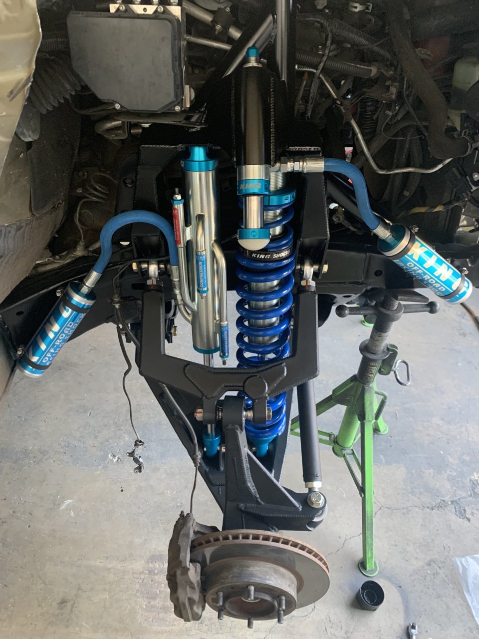

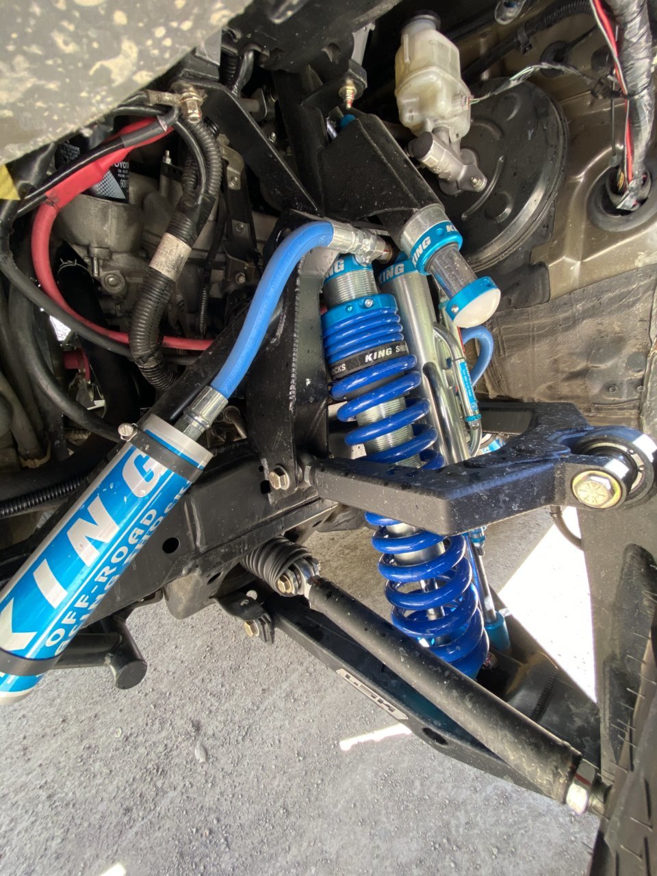

  8. Mar 27, 2020 at 5:17 PM
    #28
    lemons6245
    lemons6245 [OP] Well-Known Member
    Oct 23, 2018
    #270396
    73
    2012 Tacoma Prerunner 4x2
    LSK race long travel, King 2.5x10 coilovers, 2.5x10 bypasses and 2.0 bumps. 2.5 Tundra fox rear DSC shocks, Icon RXT pack, Icon bump stops. 4.88 w/ TruTrac. AFE Y Pipe, URD cat-back. CSF radiator, OVT 91 tune, Ripp coil packs.

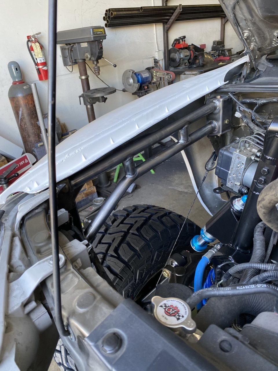

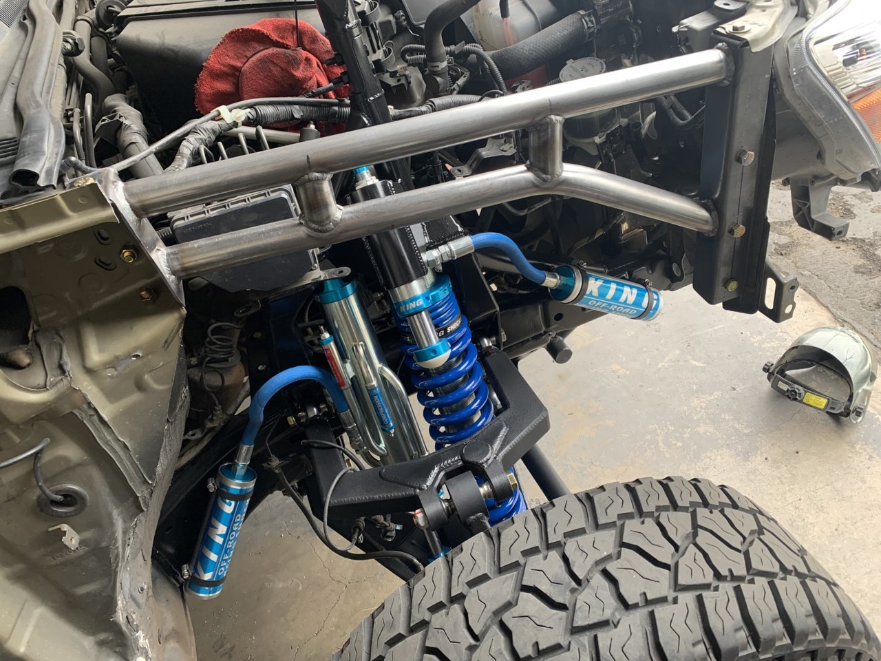

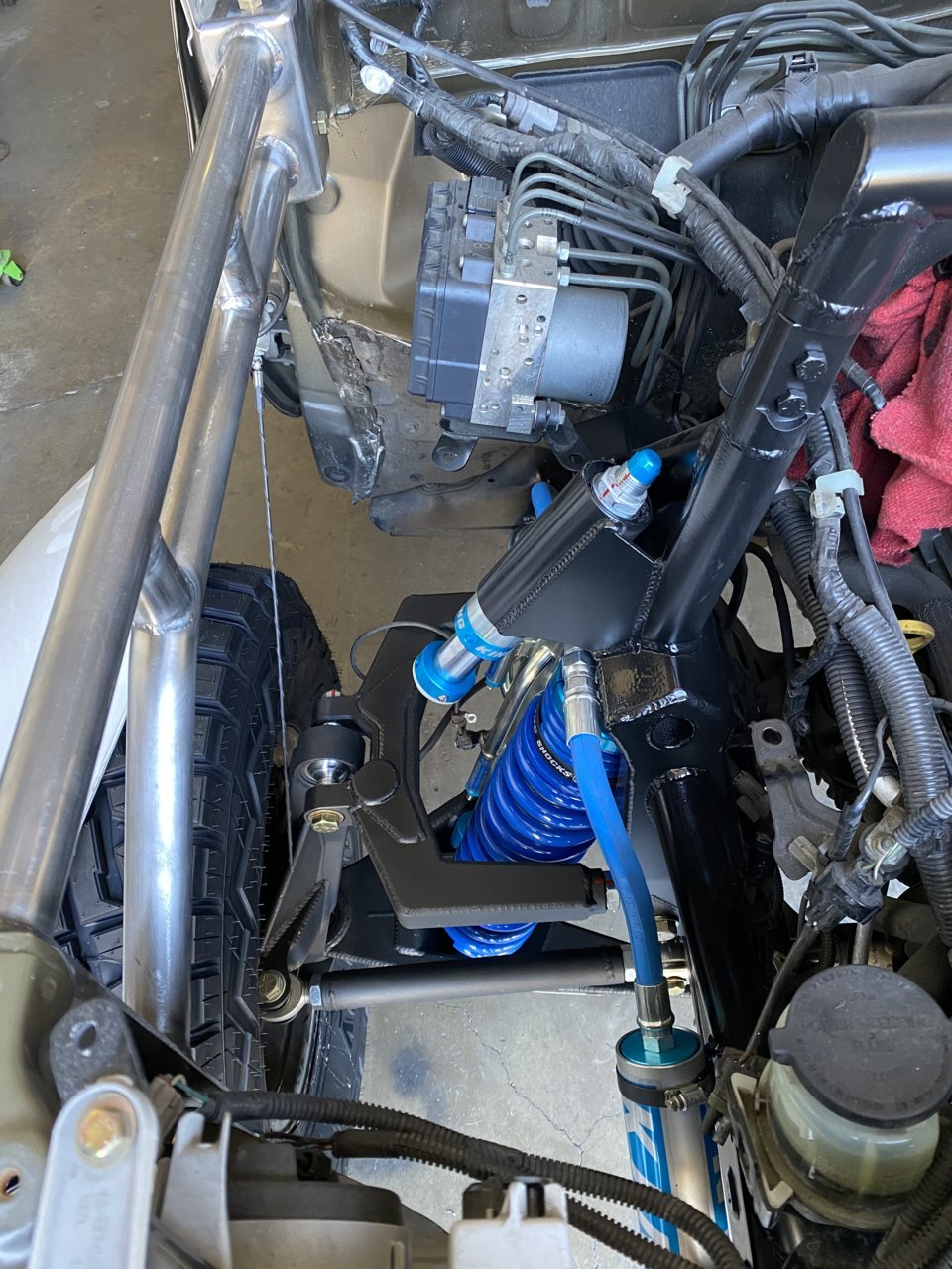

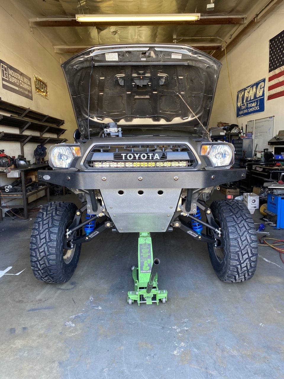

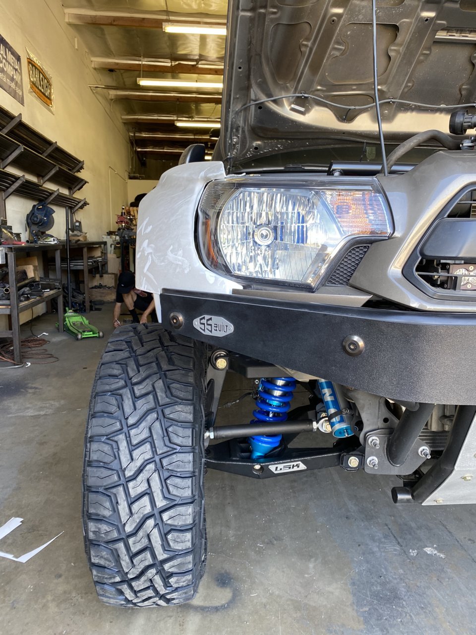

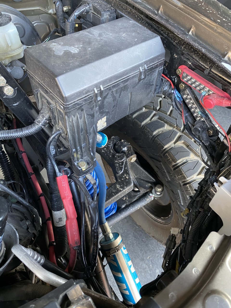

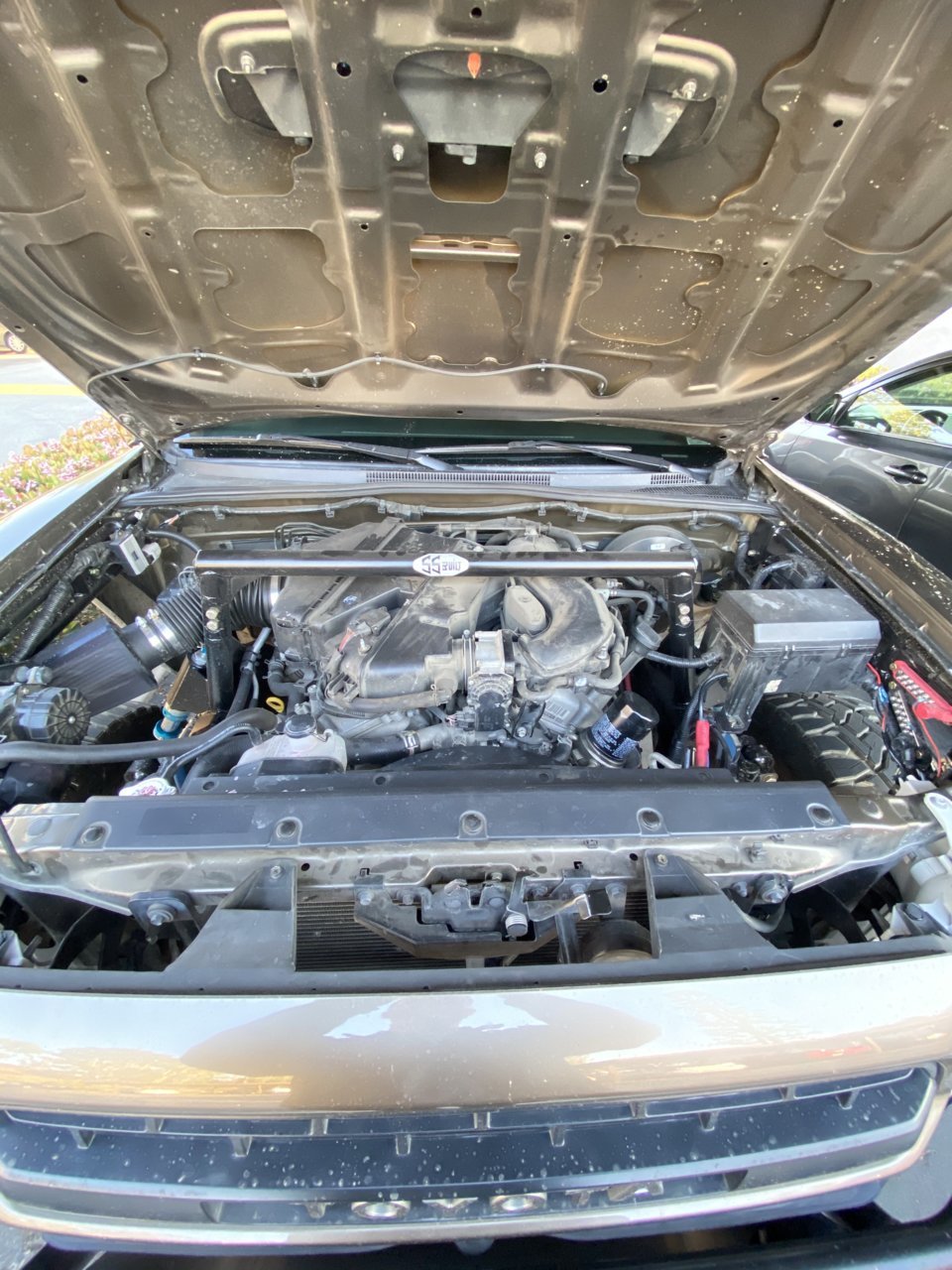

    So I got the truck back and have a few weeks on it. There was an issue with the ABS and trac light on, but that was due to the wires used to extend the abs was 14 gauge wire and it was to big. Anyway that and now that the new gears broken in and locker installed everything is awesome. My buddy steve at SS built that installed the kit and LSK knocked it out with this kit. The battery was relocated the bed. The kit is awesome, it is bumped and strapped at 17 inches of travel in the front. Haven’t got to use the full travel yet still need to figure out what to do with the rear end.

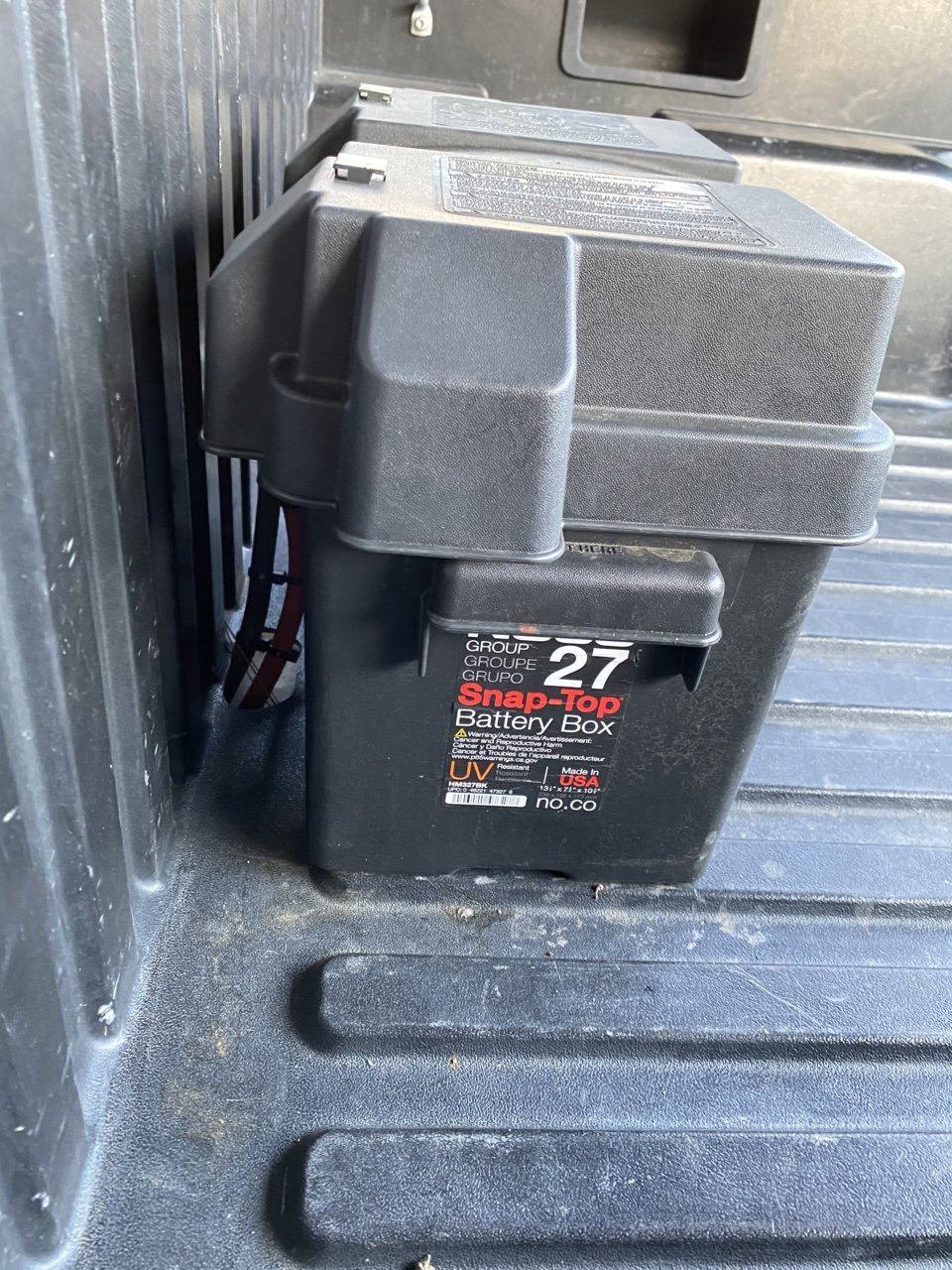

  13. Mar 27, 2020 at 6:25 PM
    #33
    lemons6245
    Oct 23, 2018
    #270396
    73

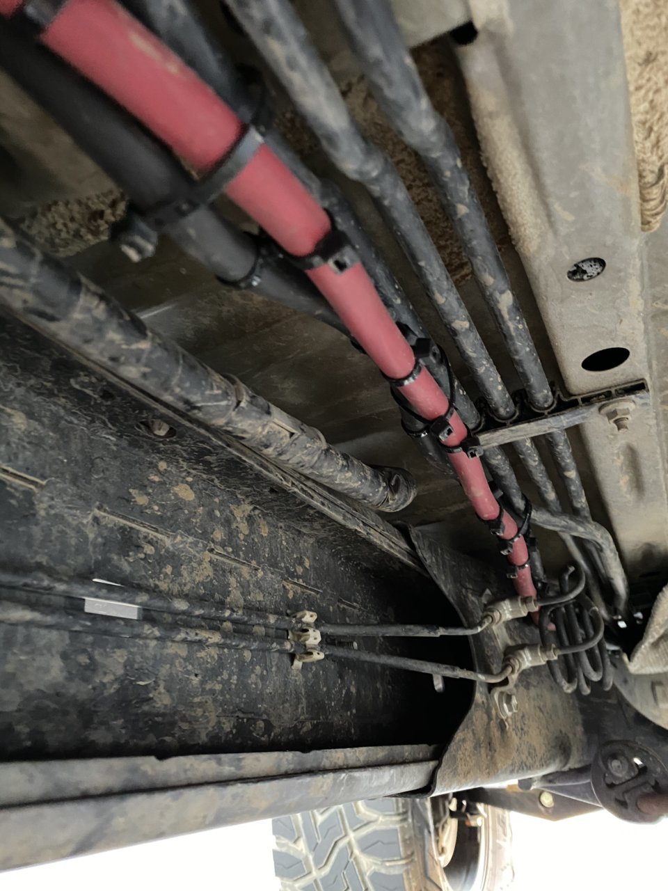

    The battery is bolted to the bed in the box. Ran under the cab and connected to the main connections and then wrapped in glue heat shrink. They are also connected to the terminals on the fender bracing so I can connect accessories like my front light bar. On a side note going to find a more stable solution then a million zip ties but they work. haha

  14. Mar 27, 2020 at 7:02 PM
    #34
    buyobuyo
    buyobuyo Read The Fucking Manual
    Jan 24, 2008
    #4417
    6,291
    Jeremy
    Camden, AR
    08 PreRunner SR5, I4, Manual, Silver
    A thing or two...
    Awesome setup. Is a bricked top spring at ride height normal?
  15. Mar 27, 2020 at 7:17 PM
    #35
    lemons6245
    Oct 23, 2018
    #270396
    73
    I was told yes, but I am going to have Accutune re-valve and put new springs on to match the valving. This set up is just temporary.
    Slashaar and buyobuyo[QUOTED] like this.

    I've seen that same set up on some sort of quad, I can't remember the brand or model but as long as the other spring doesn't bind as well it doesn't look like it would hurt anything.

  19. Apr 10, 2020 at 11:46 AM
    #39
    Downsouth Motorsports
    Downsouth Motorsports Downsouth Motorsport Vendor
    Nov 28, 2008
    #11116
    2,106
    Lakeside, Ca. 92040
    2017 4-Runner Dirt King Long Travel King 2.5 Coil-Over / 2.5 Bypass Front and Rear ICON Rear Upper and Lower Arms ICON Rear 2" Springs 34" x 10.50" x 17 Toyo Tires on 17" x 9" RaceLine Wheels
    yes that spring set up is normal. on a a-arm set up this is standard, you are only using that spring while at full droop to keep the lower spring from rattling around.
    your transition if running a traditional dual rate set up would be so high, it would beat you to death when it crossed over.
    springs predicate ride height and valving shims control the ride.
    truck came out great.
