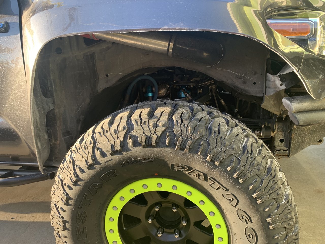

    That’s a good thread. I really wish I had a garage to do something like that. Eventually I want to bump off of my upper arm so I might as well get rid of the wheel wells now.
    Ouch. That sucks. I saw yours when searching. You did a nice job with those.
    Agreed. Looks like much more room. Doing it this way seems way easier than rebuilding the wheel wells. Especially if you live somewhere without salted roads.
    I’m going to do a cowl intake as well. Right now I have this pseudo snorkel that’s going to get ripped off one of these days.
    It has a regular snorkel head on the fender. Kind of lame but it worked for a while.
