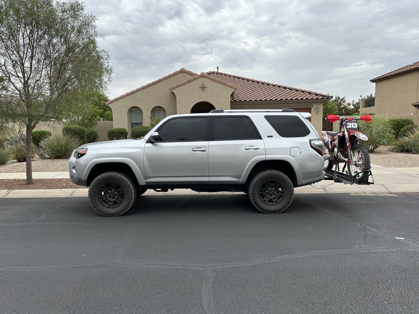

    The one I have can supposedly carry 550 lbs and the spec’d tongue weight on the 4r is 500 lbs.
    https://www.amazon.com/dp/B07DFTGFSB
    Whatever setup you choose, you’ll want airbags on the back of the 4R. 350ish lbs hanging off the back here and no squat with the bags.

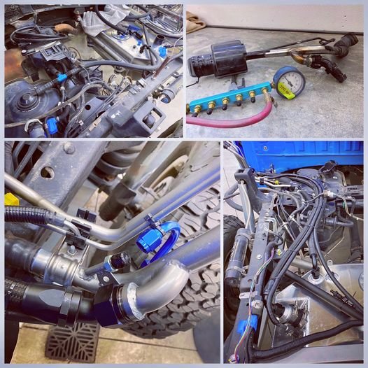

    Long travel house on 35s with a custom aluminum utility bed and FWC
    some welding required
    slightly different reason for changing (additional fuel tank in my case) but the stock fill necks are weldable steel

    did you add a second roll over valve?

    hm, i did not. this is the first I've thought about that. is the stock one internal to the tank at the fill neck entrance?
    I have no open ports from the aux tank, stock EVAP system is handling venting with no issues or CELs (5000 miles or so on this setup so far)

    yeah it is internal to the tank, you should be able to add an inline one to the aux tank pretty easily.

    any other details on your aux tank?
    planning to do almost exactly what it looks like you have done. run an aftermarket sender for aux tank low and a (cheapish) transfer pump to the main tank

    bought a tank from Boyd Welding, came with an internal 340 pump I'm using through a relay, controlled by a Apexus switch/fuel level gauge
