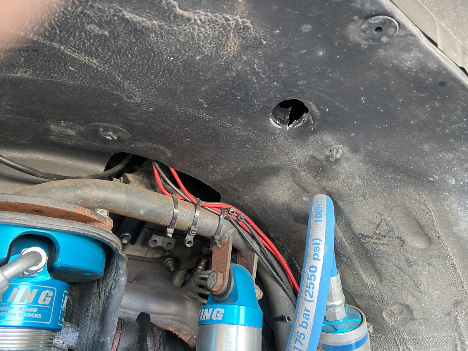

    I had those UCA love holes on my old truck when it was mid travel. Just kisses from fun!
    Aren’t modded truck fun!!! I am super curious to hear what was causing it, when you find out.

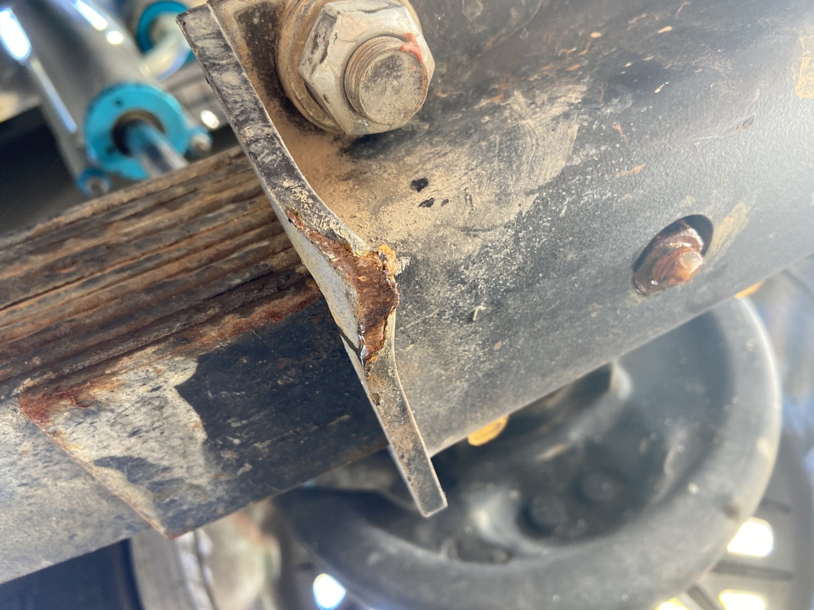

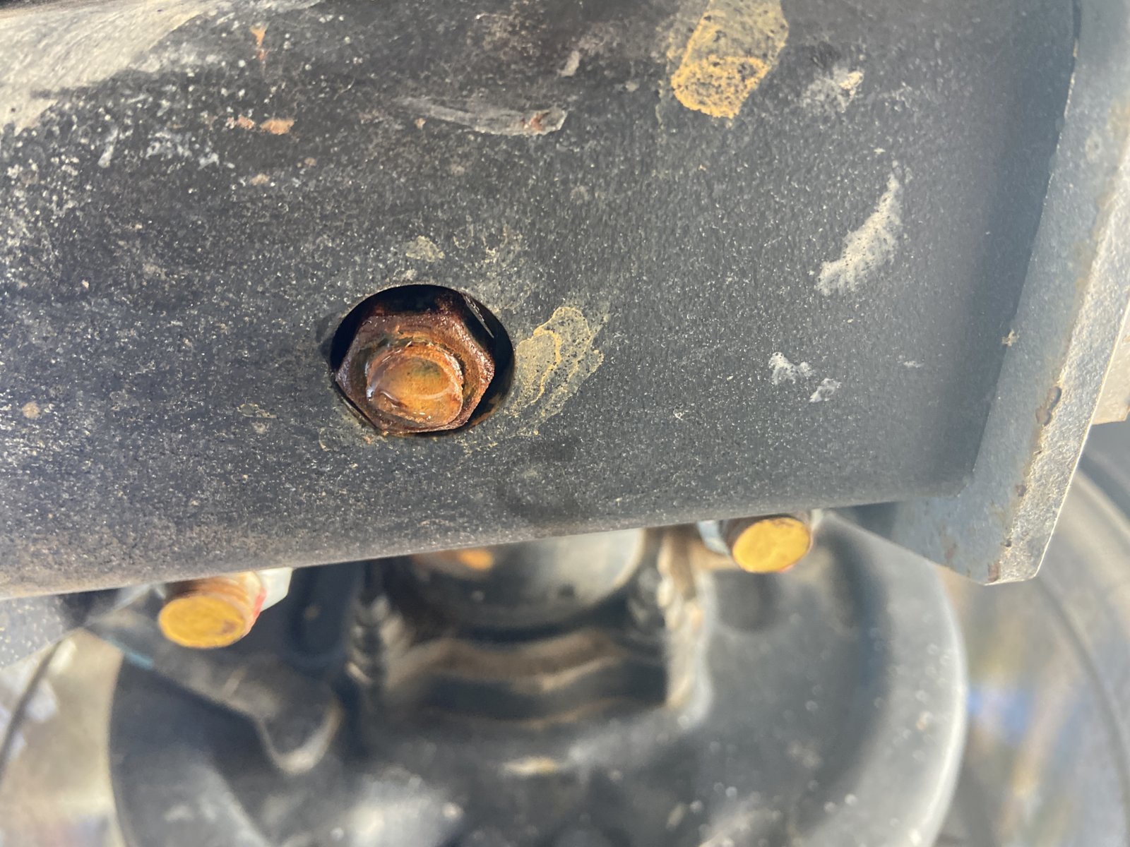

    Hit something, first pic shows point of impact, to the left is towards the front, this is the passenger side.
    Second pic is the drivers side, to the right is towards the front.
    Difference between driver side and passenger is about a 1/4 inch or more. Is it enough to cause hunting while at speed? Shrug...
    For the most part all the bolts/nuts were tight in the rear.
    Pulled all my skids and inspected all pivots, nothing seem bent and or cracked, all the frame welds were clean and 0 visible cracks. (front)
    Today I am going to drop the leaf packs ( hopefully) and switch sides. This will give the opportunity to inspect deeper and try something else if nothing turns up. At this point I am willing to try anything.

    I bet the Center Pin isn't very happy right now..

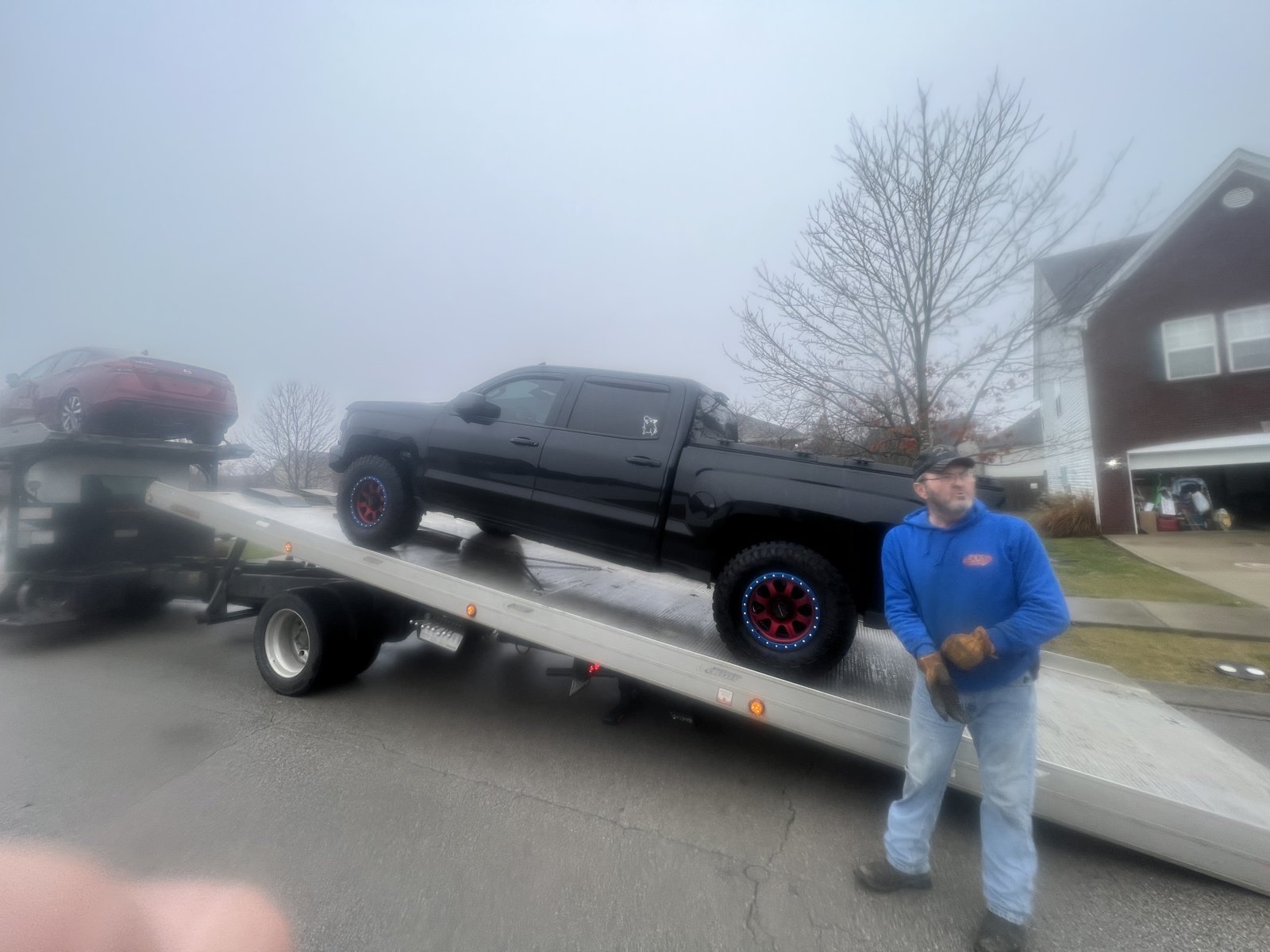

    My daily shit out it’s transmission about a month after the dyno
    So it left on Thursday to go get a circle D rebuild in tehas
    While I was under it
    I checked exactly that pin cause of you guys

    even if you follow torque / re-torque guidelines, you can still beat up a center pin. what's real fun is trying to get it out of a leaf pack not knowing that you've made a custom "stepped offset" bolt. took @Torspd and I a minute and some unproductive sledge swings to figure out why it wasn't budging.

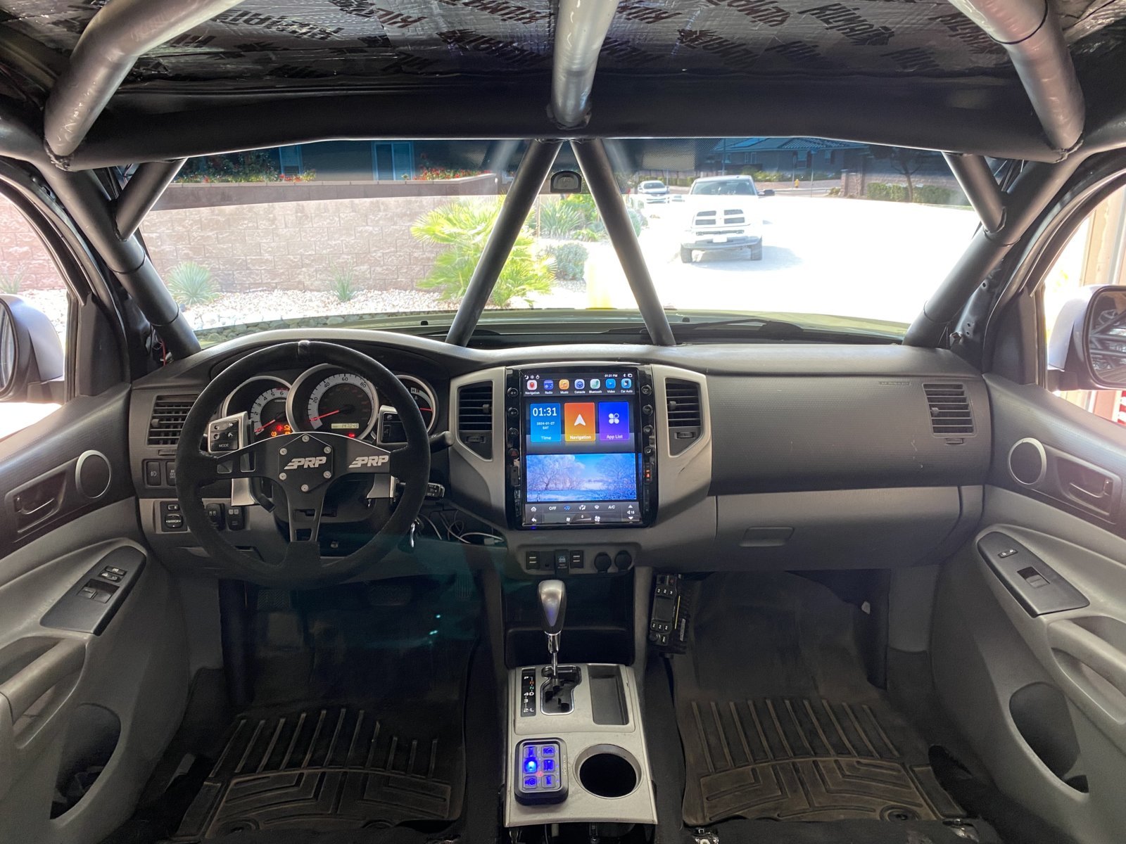

    Yes
    if you need any interior help lmk, i’ve got a lot of experience with upholstery and making interior panels etc

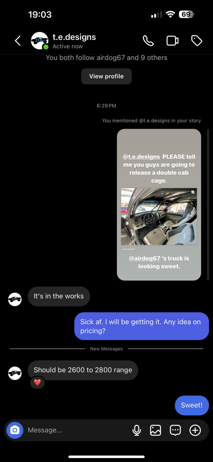

    This is great news

    You need to break those packs down. I’m betting you have a messed up center pin with a hit like that.

    This really gives me hope that when I cage the truck will still look somewhat normal
