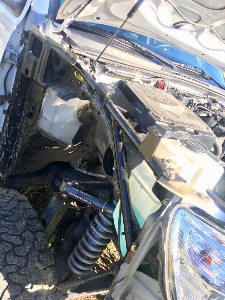

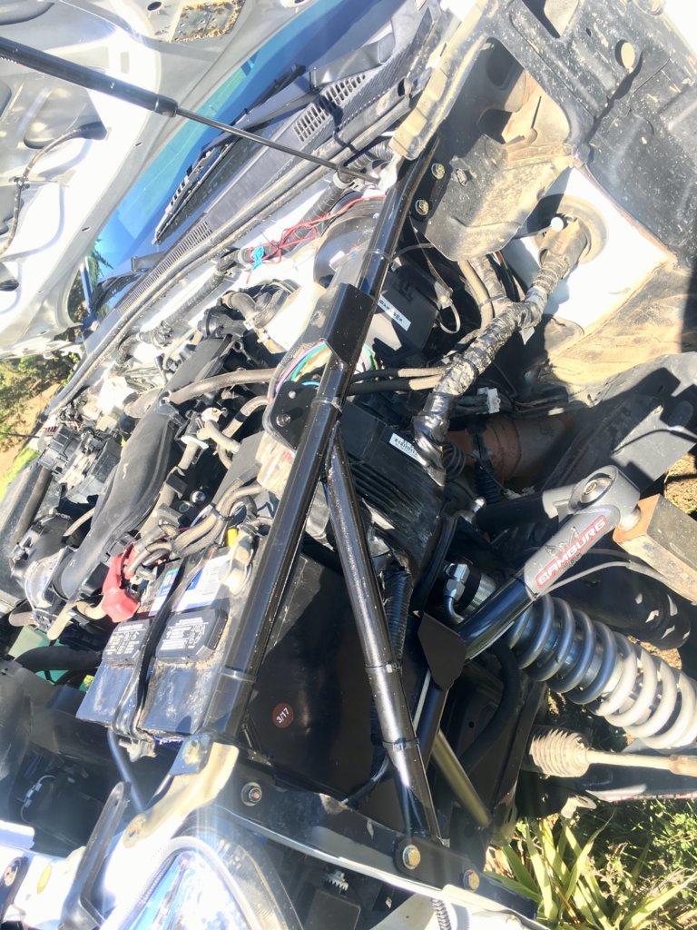

    I have the poly performance bushings up front only.
    I swapped to those a few years ago after the OEM ones were so toast the whole from end of the truck would clap around.
    I don’t have any recent photos, but this is how mine is set up:

    If yall are going through all this effort, why not mount the radiator to the frame, then make a separate frame that makes the hood/fenders/lights all one piece that hinges forward?? Can't have a core support that's constantly ripping itself apart if you don't have a core support at all :notsure:

    That's next. Except the hood will be normal.

    lol. I was cruising thru all my old build photos and those two pics were in my files. Gives me ideas :sawzall:

    That piece yours is bolted to at the body is pretty flimsy, so I am guessing yours has enough flex to keep it from destroying itself.

    Exactly, I think that that piece is just weak enough to save the cab further back.
    In hindsight, I’m glad it’s working out this way after seeing some others.
    I’ll do something more permanent and beefy once it’s all caged, cab and engine.

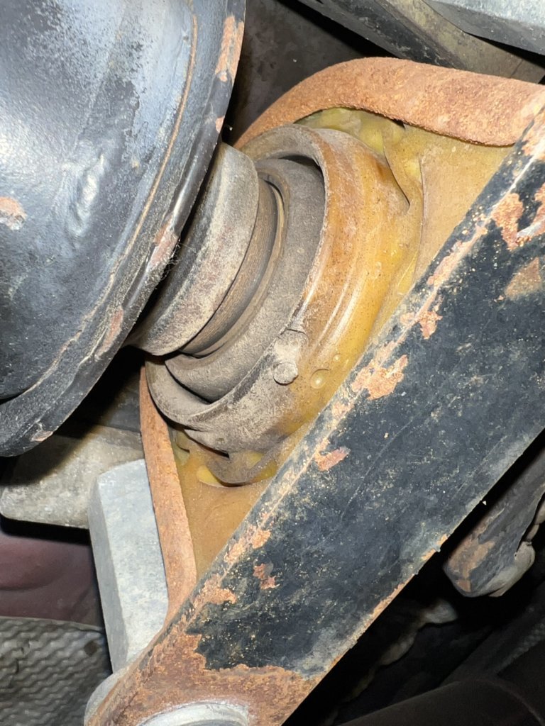

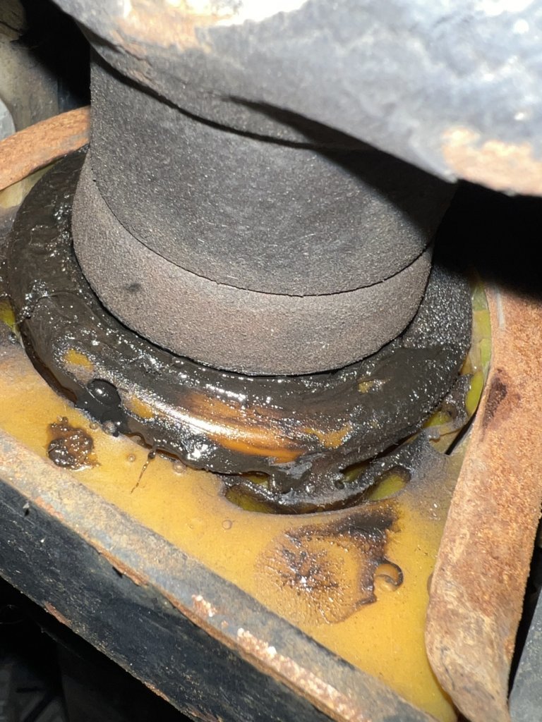

    Is this an oem carrier bearing or something else? And does all this grease mean that is going bad and it needs to be replaced? The is not much play in it. IMG_9492.jpg IMG_9493.jpg

    That is not oem. That's the "wookie" 'upgrade'

    Thanks any idea what brand it is or where to get one like it if this one goes bad or is bad?

    No it’s an IEDLS poly bearing for a ford ranger.
    https://www.tacomaworld.com/threads...uy-iedls-polyurethane-carrier-bearing.421410/
