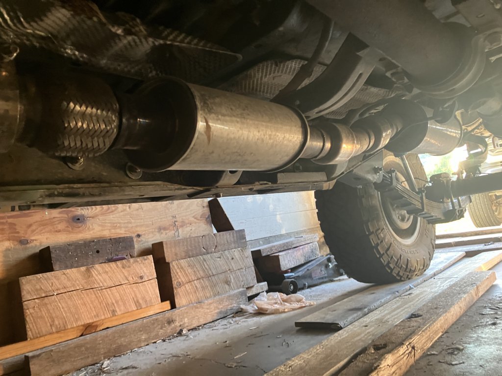

    This is my set up from the Roost Y to the dump... Ran a couple of mini resonators between the two large resonators it really helps out...

    I have Zero rasp with set up above... Oval front resonator for clearance to two minis and a round rear resonator that was offset on the inlet side and center at the dump works great and sounds smooth...

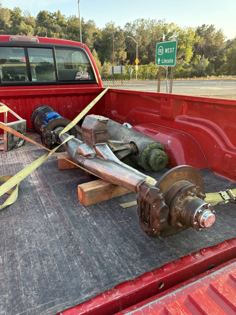

    I finally got bigger tires 2020 Long Travel Tacoma 1997 MAGNUM
    Picked up a new rear axle today for $800.
    Toyota 8.4
    Trussed
    Full float
    Disc brake swap
    Chromoly axle shafts
    I’m going to throw my new 5.29 3rd member into this axle
    just have no idea how to incorporate my rear wheel speed sensors

    I think @Airdog managed to use the front wheel speed sensors and tricked the ECU into thinking it was the rears. He did a write-up on it when swapping in his JD 9" rear axle.

    I only wanted a speed sensor so my speedo would work. Since the signal for the speedo comes from the rear sensors I found a way to trick fuck the system and its all in the thread posted above. If you want to keep ABS you are shit out of luck going with a full floater unless you really think out of the box.....though ABS is a worthless sytem offroad anyways...and onroad IMO.

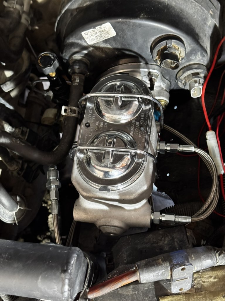

    I actually completely redid my brake system this weekend. Added a Corvette style master cylinder to my tundra booster got rid of all the toyota brake lines that ran to the ABS module(where I had a bunch of tees installed after removing the ABS module) really cleaned up the engine bay. I literally have 3 brake lines now...left and right fronts and 1 line to the rear. Braking feel and pedal feel is phenominal.
