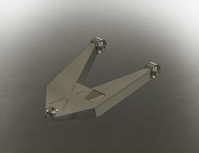

    I'm going to make some tweaks for him this week and build some new lower arms. I thinking I'm going to stick with a Mid-travel on my truck but I will build custom upper and lower Arms with spherical bearings and get rid of the bushings. Other than the ride, I have no complaints for what I do right now and I think most of that can be fixed with a taller tower and better coilover/shock package.

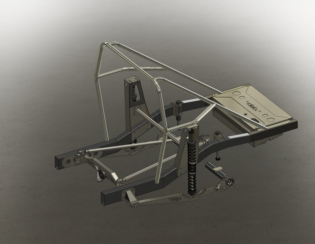

    and I need a place to mount a spare tire, rear light bar, and the cooler so I am going to add a bit more tube to the bed, but of course, I'm not going to cutter the shit out of it.
    051915_1a4407980cf44ed4ac75017d0732924dc7558639.jpg Just a roughed in version for now. No mounts designed yet.

    No fancy work on the front just yet, but the roughed in shape is there as well. Probably finish up the CAD work on this one tomorrow and assemble a new set of lowers this weekend.
