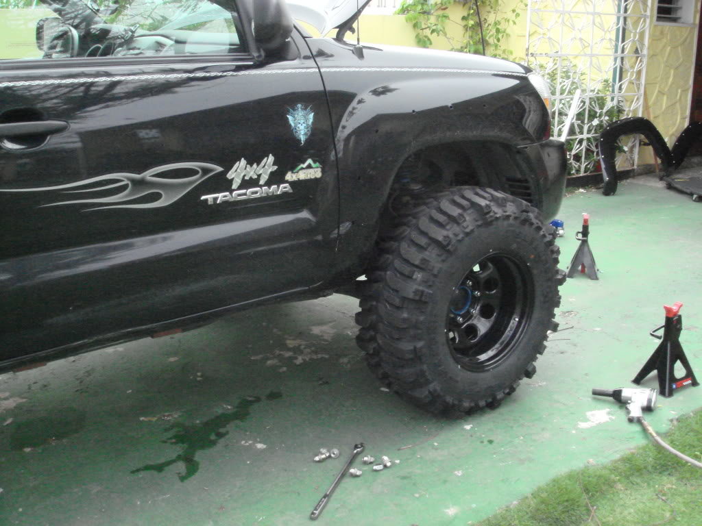

    I'll be doing around xmas the Allpro LT to fit my stashed away 33's on steelies , then some trimming of the body mounts and sheet metal and be done with it.
    I was planning on chopping it earlier, but will wait for the LT and do it once.
