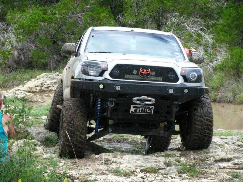

    That top one is Mark and he wasnt LT, he had LSK stock length lowers before it all got ripped apart a few years ago and awaiting a SAC. @MYT4CO
    But yes, you are very correct about the custom length Coilovers.

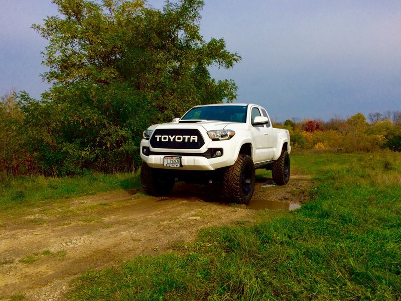

    Thanks for the link to Jerry's build. He is running a smaller tire too, just like me currently. Here is mine...

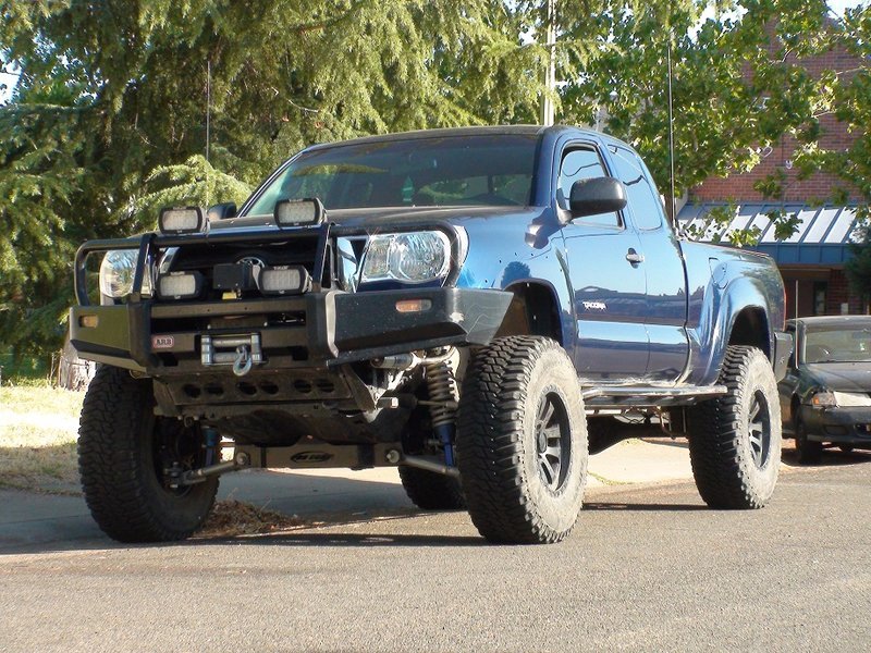

    Total Chaos got back to my guy and said its definitely doable, and I can use my existing shocks. Here r some pics of one w/ a 6" Procomp...
