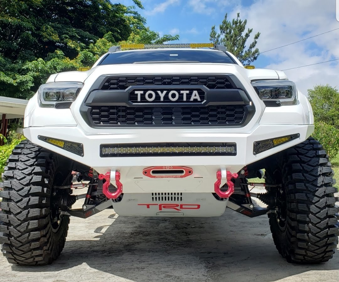

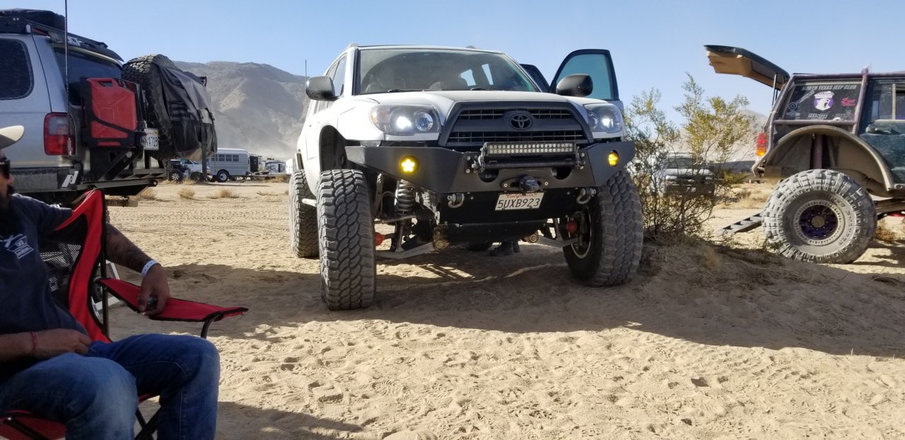

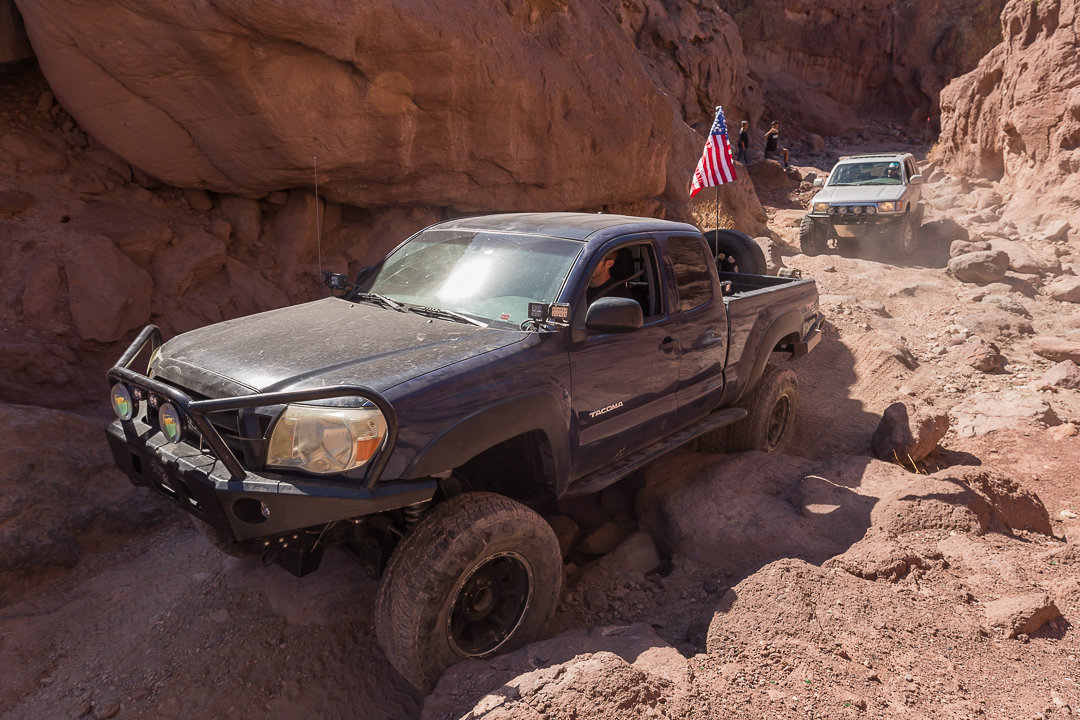

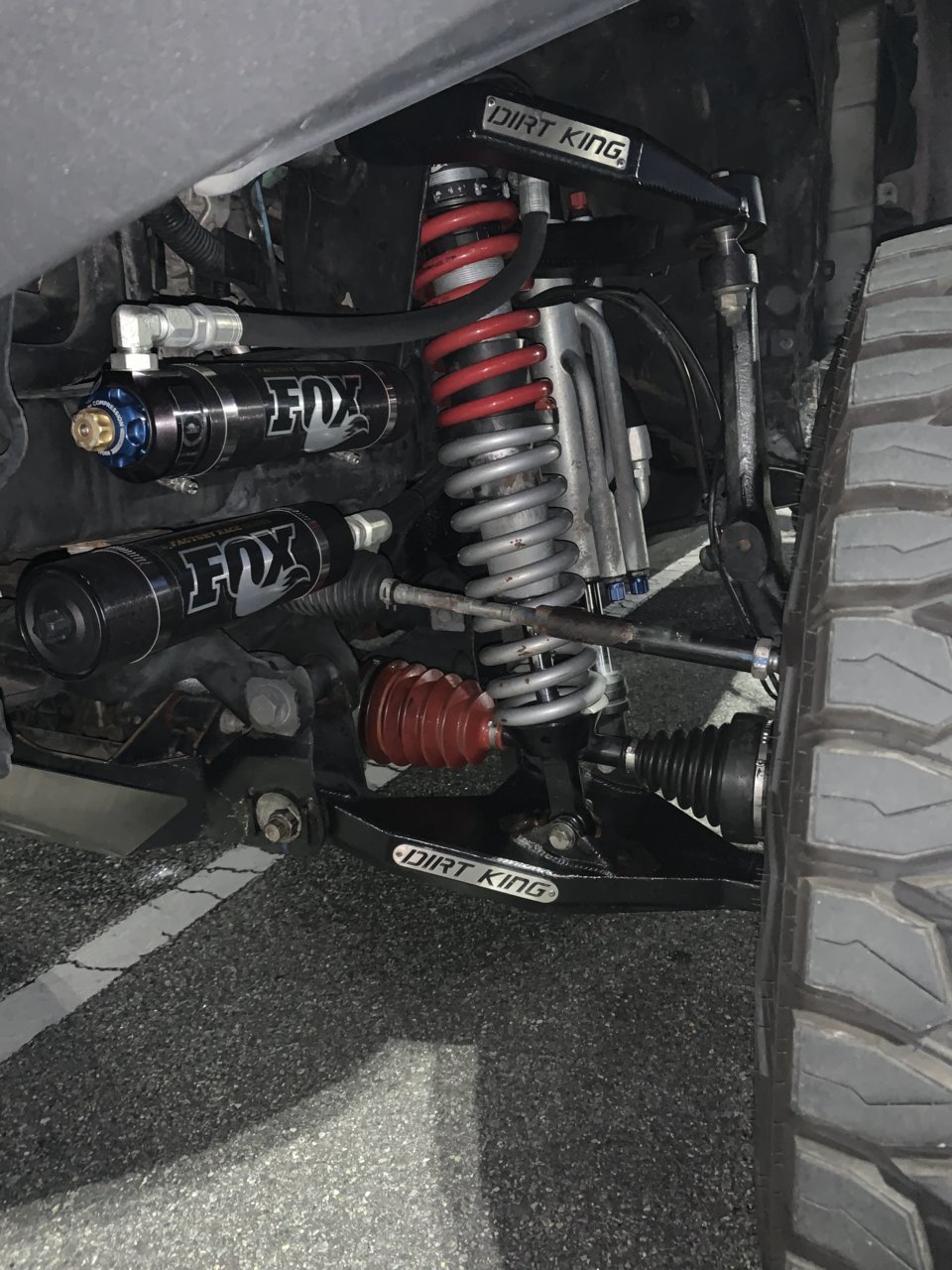

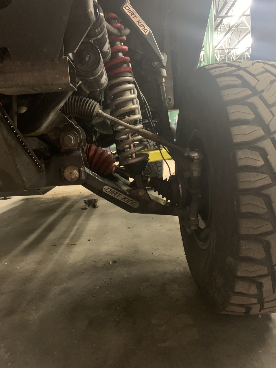

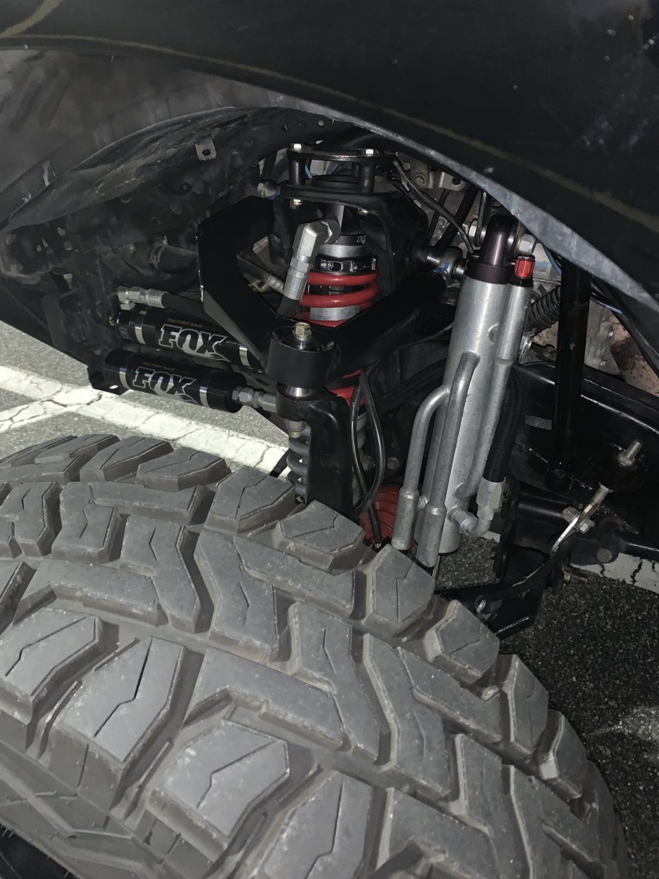

    I’ll just drop this here.... definitely possible. 2D4D9809-8A1B-4505-AB50-8D15456FB0F4.jpgB07600A9-A7A9-4672-B67E-98C082CF9DEB.jpg

  3. Feb 12, 2020 at 10:40 AM
    #163
    Spvrtan
    Spvrtan "Your assembly required."
    Mar 22, 2014
    #125872
    887
    Kris
    San Diego (North County)
    SC'd '14 Tundra; 5.5" lift w/ +2.5 LT; 40s on 17s; 4.88s
    Comet'spop and Bfox like this.

    I don't see anything wrong with this at all. Basically, all you would need to consider is adding 4-6" of shock travel. Some people say the bracket isn't designed for longer arms... bla bla bla.. I'm guessing the drop bracket is easily as strong as the stock mounts and they were only intended for stock arms, too. Personally, I think this is a great idea if you want more height out of your vehicle and long travel to boot. Good job and I may be joining you in the future.
    My big issue is I want to go with the LSK or the new Marlin long travel which both come with knuckles. This makes doing one of these lifts pretty much impossible since they need their own knuckles for the drop. Oh well. Just another problem to solve.... :)

    Ya man, my last Tacoma had a 6in lift and I rock crawled the crap out of it. I had no issues with the drop bracket other than the corner where the lower control arm connects , that got hit hard a few times which did bend and made getting an alignment difficult. On the plus side I never had to run skids other than sliders nothing ever came close to tranny or other parts.

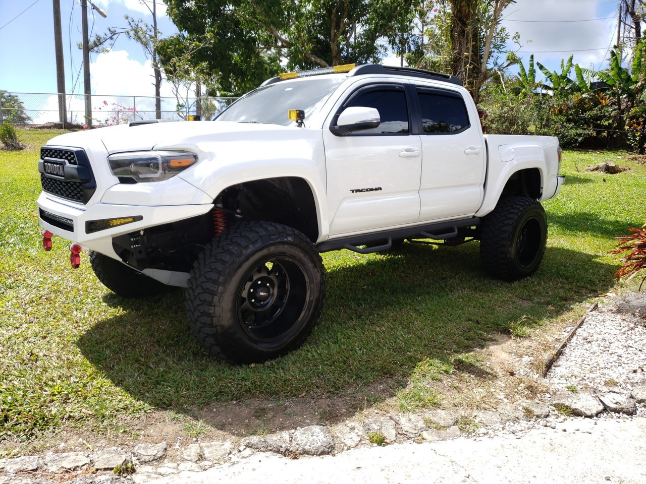

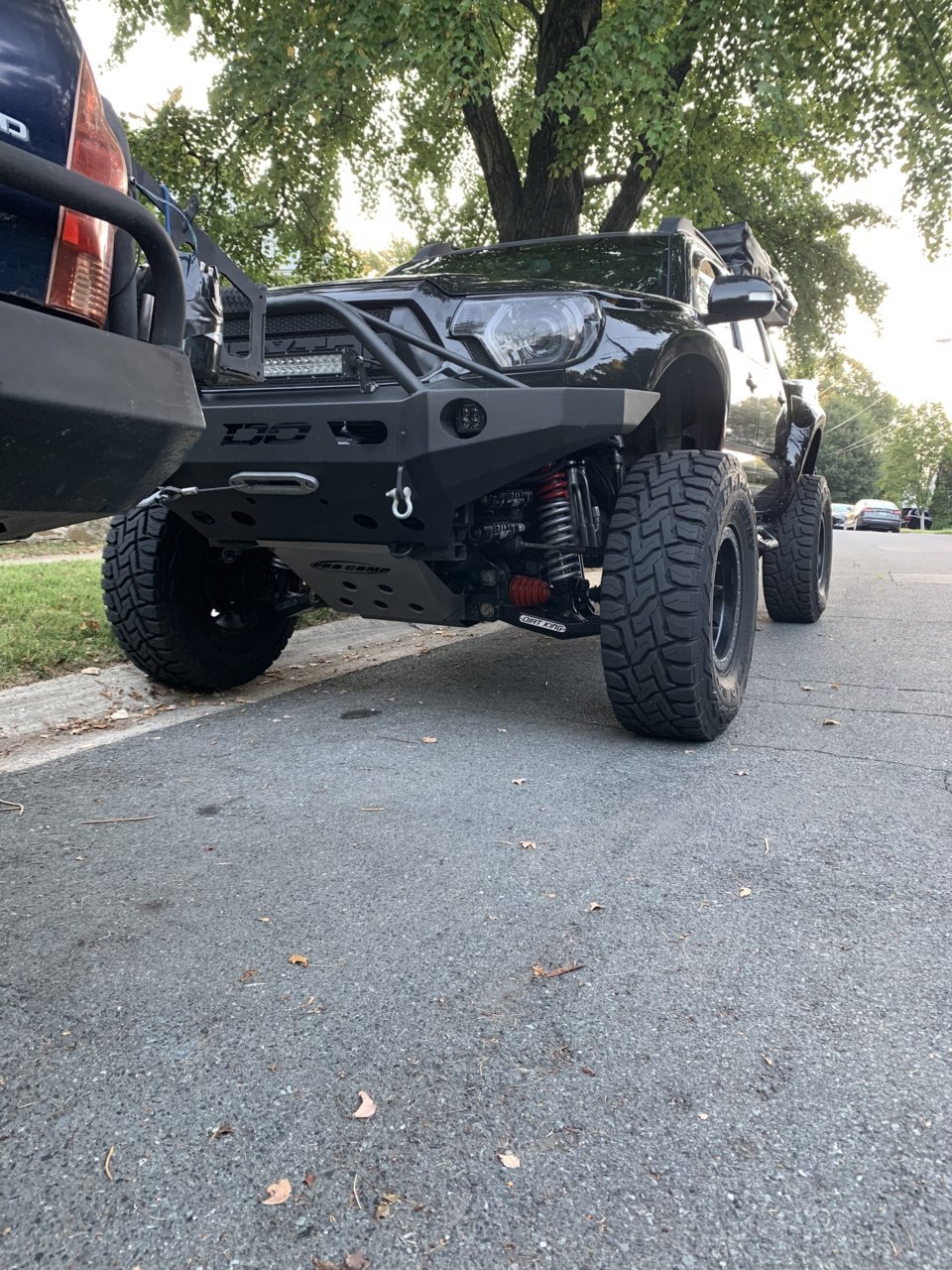

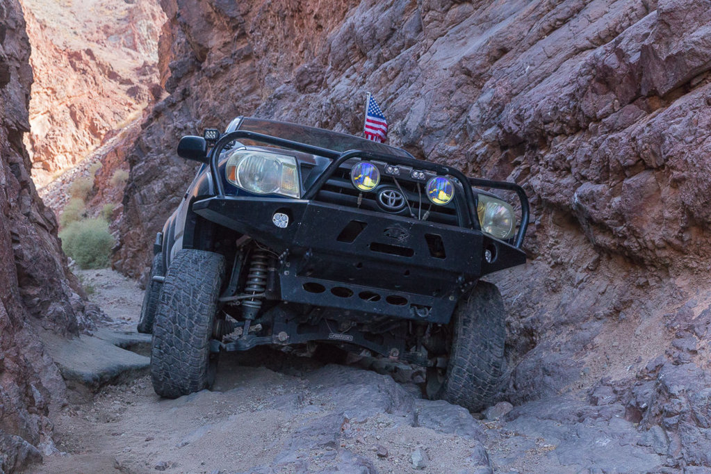

    B163A26A-7749-4CE7-91CB-CB707FAFA5C1.jpg 1C2018BD-55EC-448B-B291-648AFD1CACF9.jpg

    #175
    PolarBearX
    PolarBearX Well-Known Member
    Apr 8, 2014
    #127278
    164
    Willamette Valley
    2016 White Tacoma Limited
    Ok, that's sick. I wonder if I can order the exact suspension part you have and directly fit it onto my 3rd gen with Procomp DB
  16. Apr 18, 2020 at 6:35 AM
    #176
    Geral13
    Geral13 White/carisma
    Jun 7, 2016
    #189030
    202
    Geraldo
    Cayey,Puerto Rico
    Tacoma 2017
    Trd pro runner wheels, led lighting, 3 inch lift, trd exhaust, trd intake,subwoofer

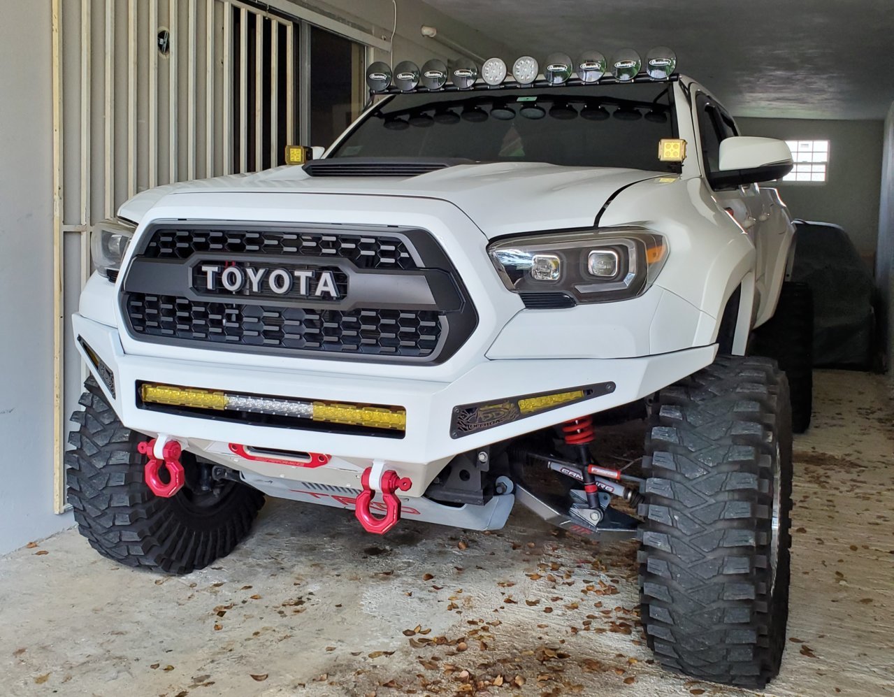

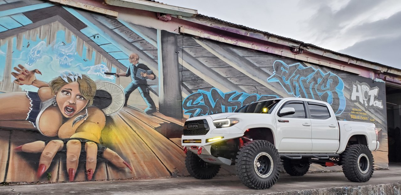

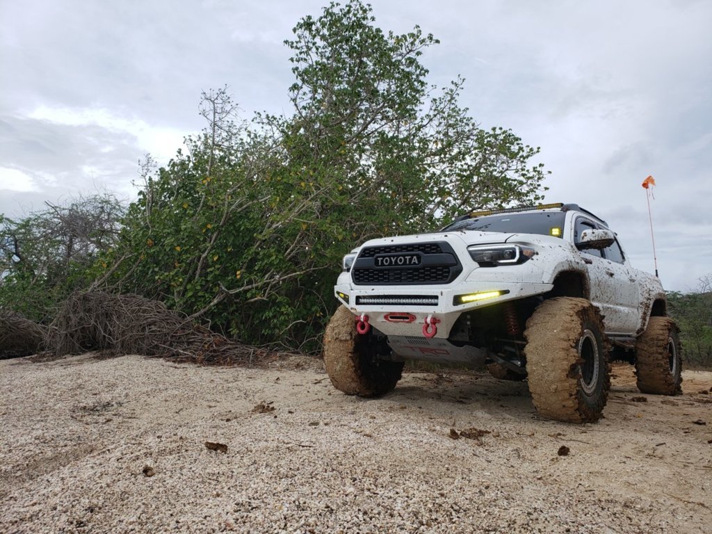

    I wish i had seen this thread before... I had a 6 inch DB and I tried to install a LT +4.5 but I never got the alignment correctly.. we tried many things but I couldn't get it align , so I end up removing the DB and went LT only .. but i was running 37"s with the DB and still running 37s still with LT only, ofcourse a lot of trimming involve..
    That was with DB and 37s, wheels 20x12 et-44 and spacers , also 3 inch front wider fenders
    Another glance on the DB
    This is what i had to trimmed to get 37 to fit
    And this is how it end up with the LT +4.5 , different wheel setup and complete +3" inch wider fenders and bedsides , 17x9 et-38 37x12.50 trepadors

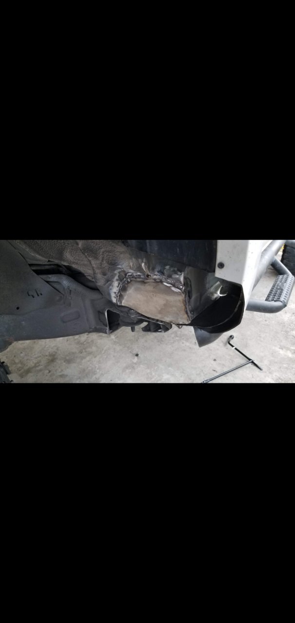

    15' DCSB OR S/C
    Lift, pedal commander, led foglights, led interior lights, led back ups, led under lighting, urd tcai, led headlights, methanol injection, 76mm tb, hood struts, dif breather mod, ratiotek trans kit, x-series gauges, true cool trans cooler, belt wrap mod, 2.8 pulley

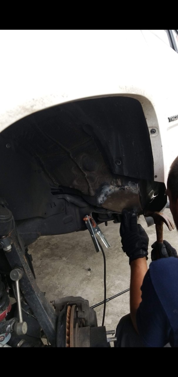

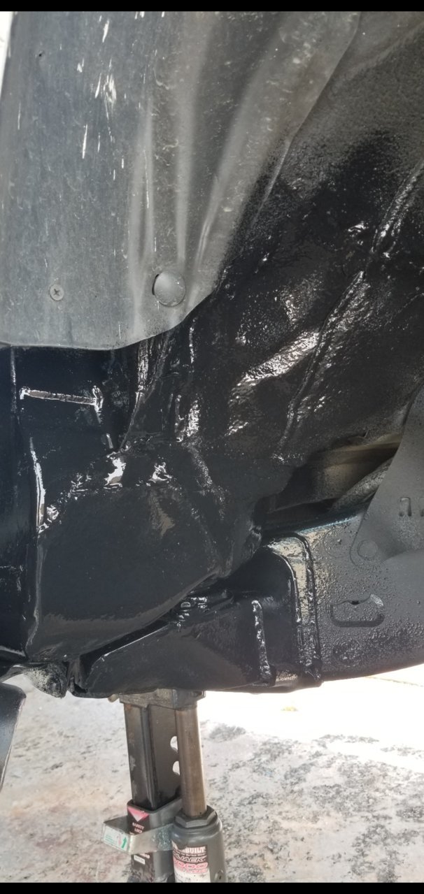

    any pics of the frame repair from the db lift? thats been my main reason for keeping it.
