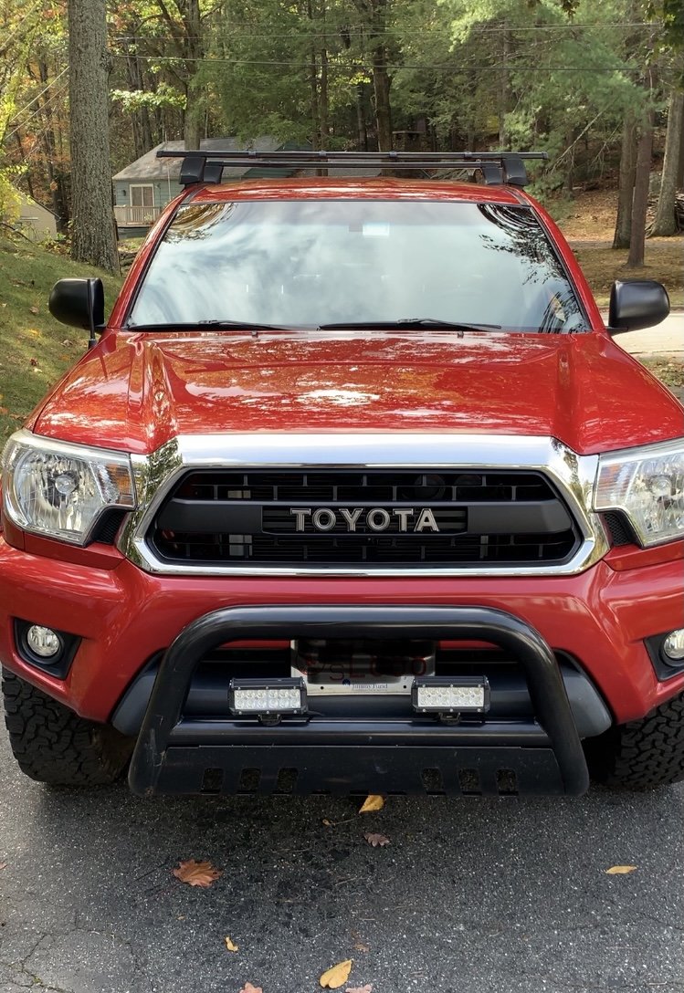

    I had been looking for a double cab, manual, 4wd Tacoma for a few months. Last week I got my Red 2013 Taco. 88,500 miles. The interior is immaculate. The exterior has a few marks here and there but for the most part in great shape.
    Here is what I have done since I got it. All maintenance items were performed by me for the cost of materials, and most maintenance items were beyond overdue:
    • Replaced cabin air filter. OEM
    • Replaced engine air filter. OEM
    • Installed Trexsport tonneau cover
    • Installed led bulbs in map/overhead lamps
    • Installed Homelink backup compass temp mirror. Sourced from eBay for $107
    • Updated firmware on Pioneer AVH-2300NEX head unit (love this - CarPlay is so cool)
    • Installed rubber cargo bed mat. OEM
    • Added Chevron Techron to full tank of gas
    • Replaced factory antenna with stubby antenna. My garage is too short. Amazon
    • Performed secondary air intake filter mod
    • Installed passenger rear 4x4 mud flap. Was missing. OEM
    • MAF and throttle body cleaning. CRC sprays
    • Replaced PCV valve. OEM
    • Swapped grille for TRD PRO grille. eBay
    • Drained/refilled front & rear diffs, transfer case. Mobil 1 75w-90
    • Drained/refilled MT. The fluid that came out was gross. Amsoil GL4 MT 75w-90
    • Greased all 5 Zerks. Used a rubber extension hose for tricky 2nd zerk. Lucas Red n Sticky
    • Vacuumed front door hinge rubber flap areas. Full to the brim with pine needles and debris
    I think I will do coolant and plugs and then I think I’m done. If you can think of anything else please let me know, and thank you to this forum and it’s amazing members. The posts here allowed me to accomplish most items with ease. THANK YOU all.
