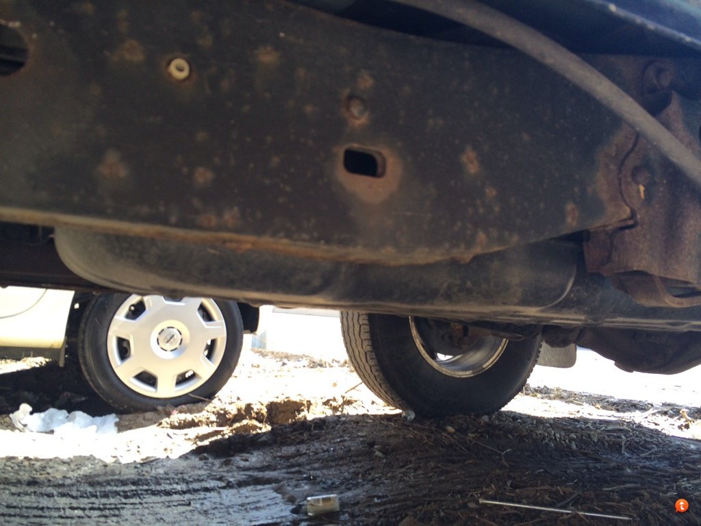

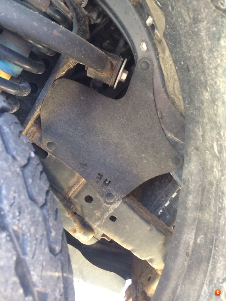

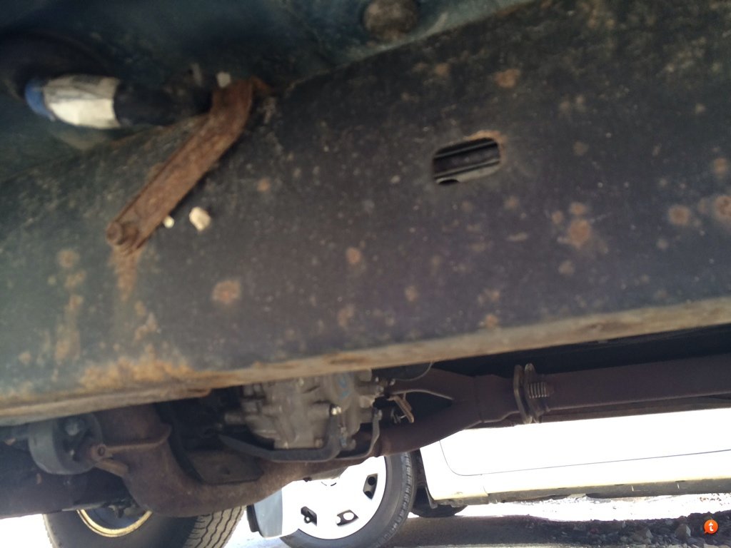

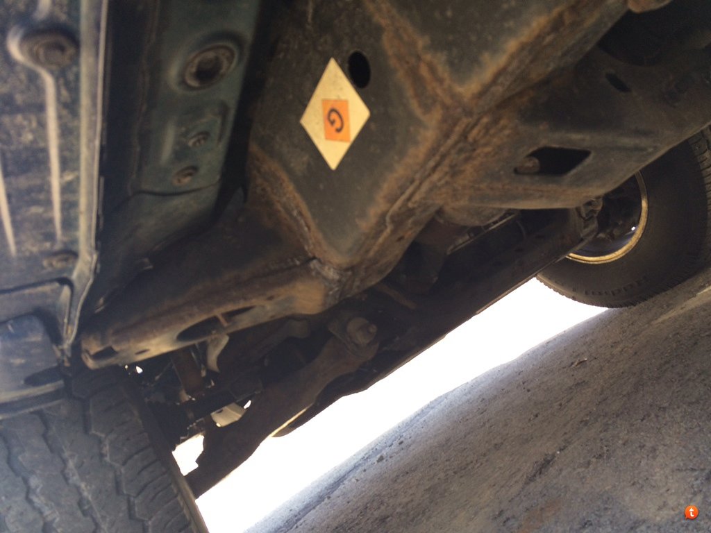

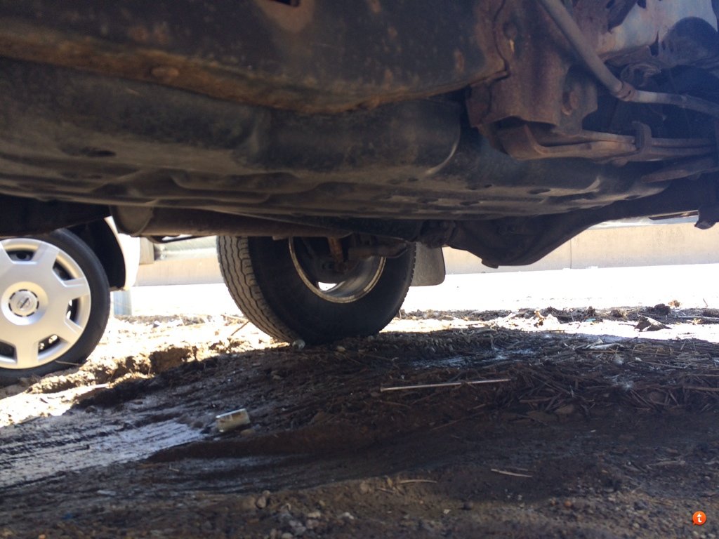

    2007 DC. 151k miles. Location Pittsburgh pa. 3a7azepa_34c966369724b51b0f6ce325d7fc34e47fd05a7c.jpgehy5esu9_b22091a81aee8bab2b5b6f5ef889b71462e536e3.jpgede8uvet_a8f10b1ecc67418c66caeb658cad7ef9437b1d3f.jpga9atytun_200c56a8ebfeea4b7b194fd451fec7cc4c4a8bea.jpgzy7eby8y_00b38da22ed243533a8ae40a2a0c8805db24a392.jpg

    This dealer just sent me these by text. Says by law they have to check the frame and it has to pass.

    OK looked at pics of frame that has never been cared for... now what?

    Looks rusty, maybe start wire brushing it and painting it every year.

    I think its about a foot foward of where the fully boxed frame ends, on the inside of the rails.

    The frame looks ok for 151k in the rust belt. I would want pictures of the rot spots before I traveled. A little power wash, a little prep, a little rust converter, and a top coat and you should be fine.

    I agree, that is not horrible and while it has cancer, I think the chemo would work.

    That's not bad at all, especially for those miles, my '06 was much worse. If you're worried about it, POR15 it. I'm sure that it has no holes in it with that little bit of rust. It's not neglected, its just PA.
    I'm not sure what I'm looking at in picture #1, but the dog leg for the cab mount is where mine got the worst and that one looks pretty good.
    Ask him what the brake lines look like and if the e brake works.... then take a good look at the trailer hitch and see how rusty it is.
