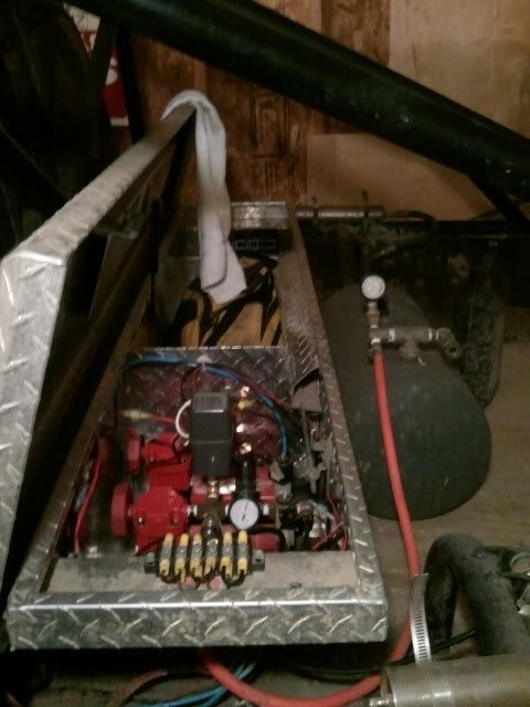

    Sounds like your tank was undersized. Heat kills any compressor, thats why most are equipped with thermal overloads to shut it down. That being said I ran dual MV-50's on a 7 gallon tank for over 2 years before the crank let go in one. Never get stranded running duals :D
    Half the manifold and the tank was at 120 psi, and half the manifold was at 90 psi for my lockers.

    How did you regulate individually? I am running one little ARB compressor right now but have another compressor on the truck and want to tie both together to a tank...

    ^^^Best picture I had. Basically tie them together with a header, branch off to the tank, then have a regulator on the header, then branch to ARB solenoids.
