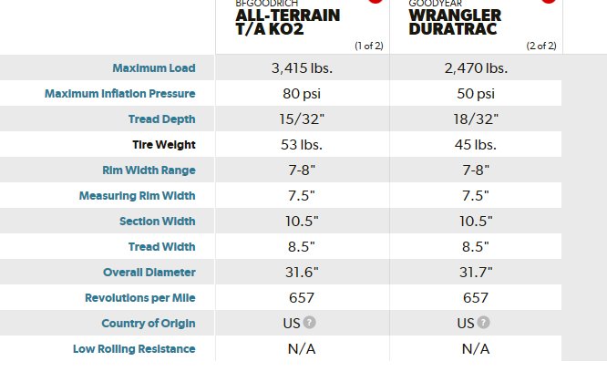

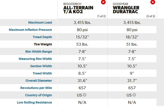

    Some stuff. Not a lot, just some.

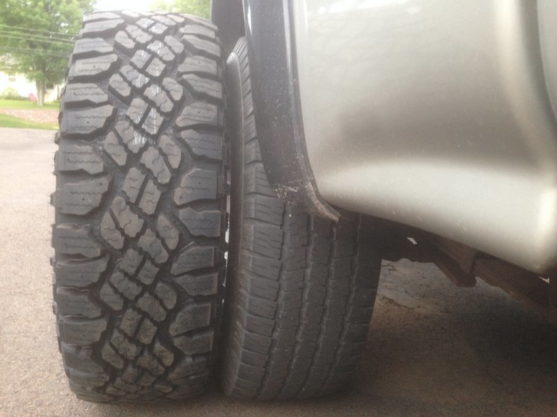

    The duratracs are a lot more aggressive and open tread design. Deeper lugs. Thinner sidewall. I got duratracs 25% off so I bought them

    So there is no size difference. The only complaint I keep hearing on the DT is road noise.

    specs are for load Es. Duratracs in a C are 46 lbs.

    Good call...however the KO is E load in this comparison. Tirerack doesn't list the KO in Load range C
