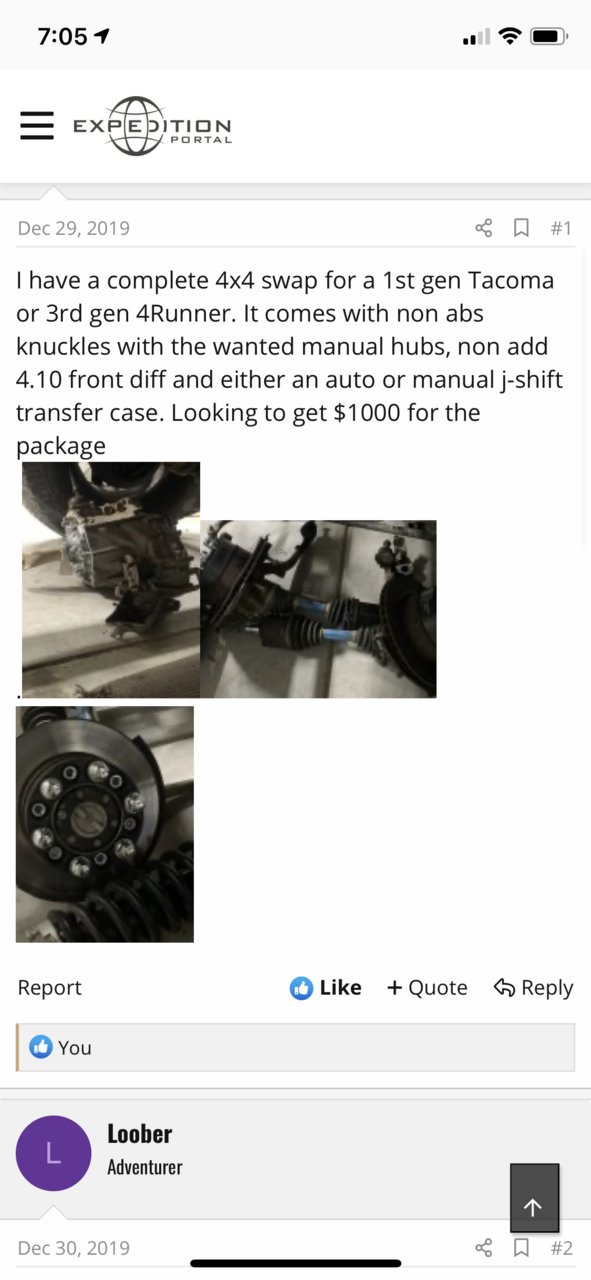

    I just found this posting on an overlanding forum. Is this stuff good for my 2003 prerunner? Is it complete or kissing some stuff? Is the price fair?

    He's about 400 over on his asking price.
    Who's to tell what condition those axles are, but the good thing is they're OEM
    I'd rebuild the hubs too, which is cheap and easy to do.
    The spindles are a direct replacement but I can't comment on the ABS thing; do your own research for that one.
    As mentioned earlier, your transmission needs to be source from an 03 or 04.
    Natenite[QUOTED][OP] likes this.

    Non ABS bothers me. Look I'm going to put this to ya no BS. If this were a 1978 Chevy truck we'd be done with this by now, and you'd be down in the Ozarks throwing mud, but it is not. There are a myriad of electronic issues that have to be considered, and ABS is just one of many. The PCM/ECU/TCM etc. all have hands in the game. The ABS wheel sensors may or may not have comm with the PCM/ECU or transmission control module, if it even has one. Most of this communication is based on ohms resistance which may or may not vary from year/model. Is your vehicle drive by wire or does it have a throttle cable. I have no idea. This forum has a quarter million plus members and this thread has 2 or 3 guys commenting. If it were easy, they other guy would be done, and you'd have pics, part numbers, phone numbers etc. Just being honest. Call those folks, but I always recommend going in person. Lots of dreamers out there in mom's basement with a cell phone and a laptop. I've talked to a bunch of them, like thousands...lol
